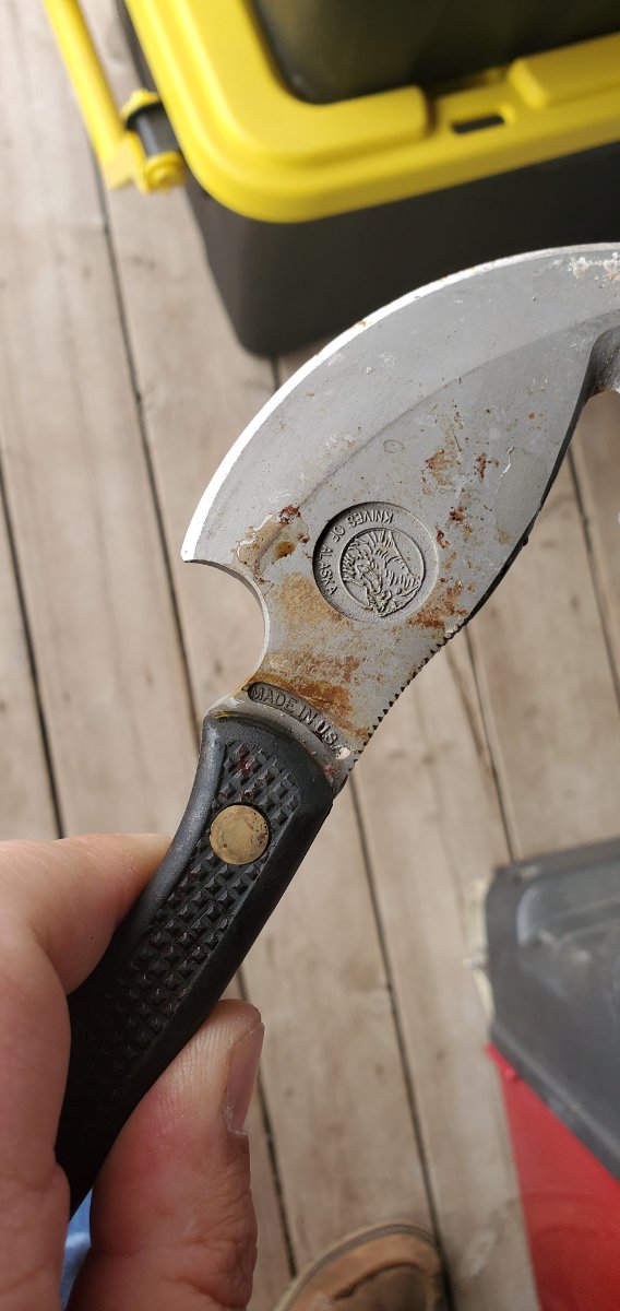

Hi all, let my nephew use my Knives of Alaska gut hook to clean his first deer
I went back two days later and found it in the grass... looking for any recommendations.

I use 0000 steel wool and 3-in-1 oil to kill active rust, then I use a carpenter's pencil to remove the killed rust. Leaves a blackish area. If you're paranoid about your knife not being all shiny, you could then spend many hours sanding the entire knife with increasing fineness sand paper to remove the resulting black areas, thereby thining the knife as well.
Me? I kill the rust and go on. A working knife develops character over time. I personally would never waste time making a used knife "look new".

I would agree with ZZ's treatment. The only thing I like to do, in addition, is apply Renwax. I find that areas that have rusted, will rust more quickly than the first time around. Renwax helps "seal" it; although, it won't stop additional rust, if left out, in the weather, for a prolonged period.

I always start with WD40 and 0000 steel wool. That usually gets it done unless there is deep rust damage (previously mentioned dark spot), and then you need to sand if you want to remove all of it. I would tell him he owes you the entire tenderloin!

Since that knife has a bead blasted finish, I would suggest using powdered "Barkeeper's Friend." It's available at most grocery stores.
Wet the blade with water and apply a paste of the BKF to the rusted areas. Paste needs to be wet enough so that you can see it bubbling. After a few minutes, rinse. Repeat as necessary.
Any mechanical means that you use will alter the finish on the knife.
If you know someone with a bead blaster, it can be blasted away.

Hard to tell from the pictures how bad the rust actually is. It may come off simply with a little 3-in-1 oil, a soft cotton rag and a little “elbow grease”. That should remove at least some of it. Next step would be the Bartender’s Friend, then pencil lead (graphite). I would not use anything more abrasive unless those don’t do the trick.

Thanks yall, I dont care what it looks like as long as its functional. Kinda disappointed to see it rust so easy so fast. Might be time to look for something better..any recommendations there.? Oh and the nephew owes me more than that, I scouted that deer all day for him. Almost took the shot myself a couple times.

Oil and a rag. It’s not that rusty.

Returning to topic, I have no experience with bead-blasted finishes, but I'd start with oil and a rag and move on to more drastic methods as necessary.
