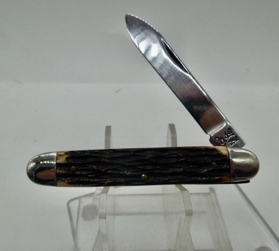

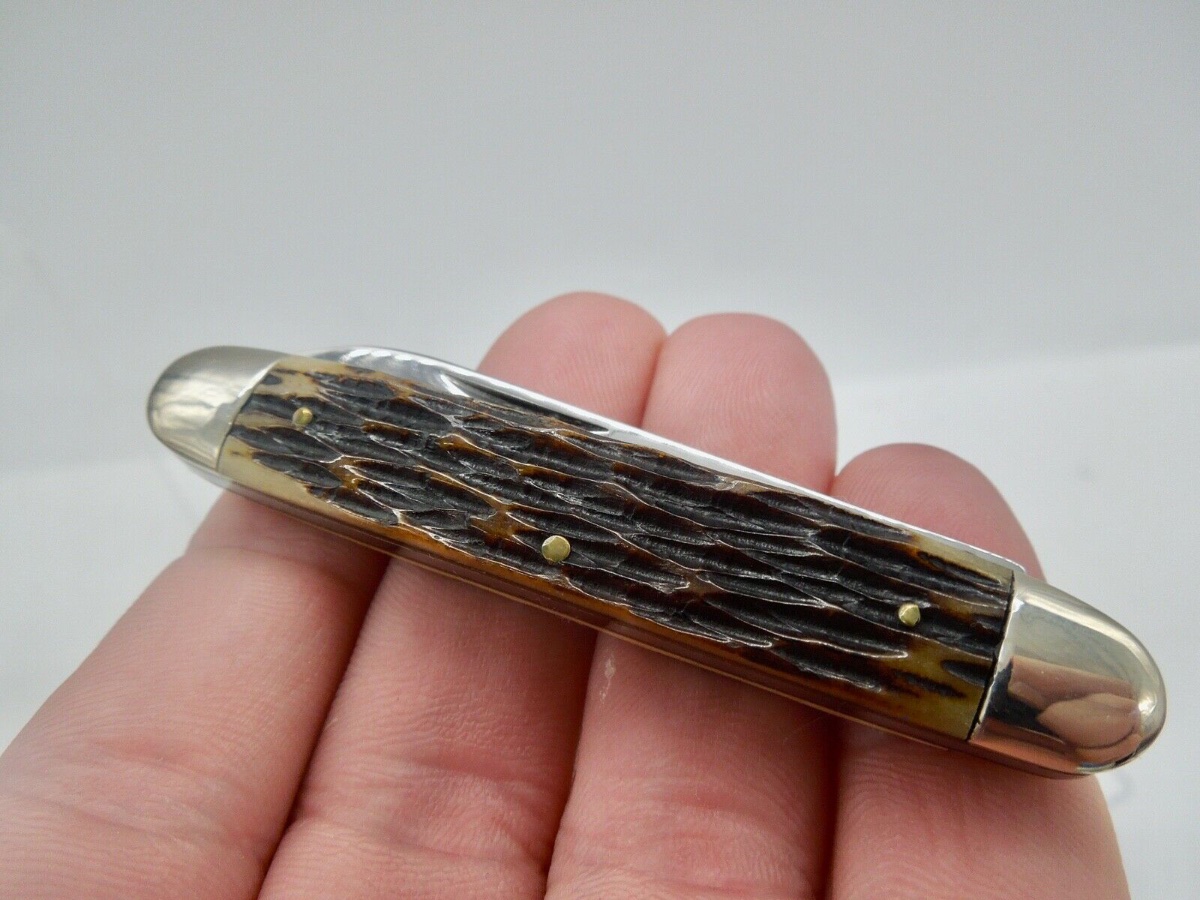

Another fake Case 25¢ knife has popped up on eBay. https://www.ebay.com/itm/VINTAGE-RARE-C ... Sw7P9fzU4g Unlike a genuine one, this one has a cap bolster and the jigging is definitely not Case. Authentic originals were barehead (no cap bolster) boys knives. Same seller has a 50¢, a 75¢, and a $1.00 knife (Case never made them).

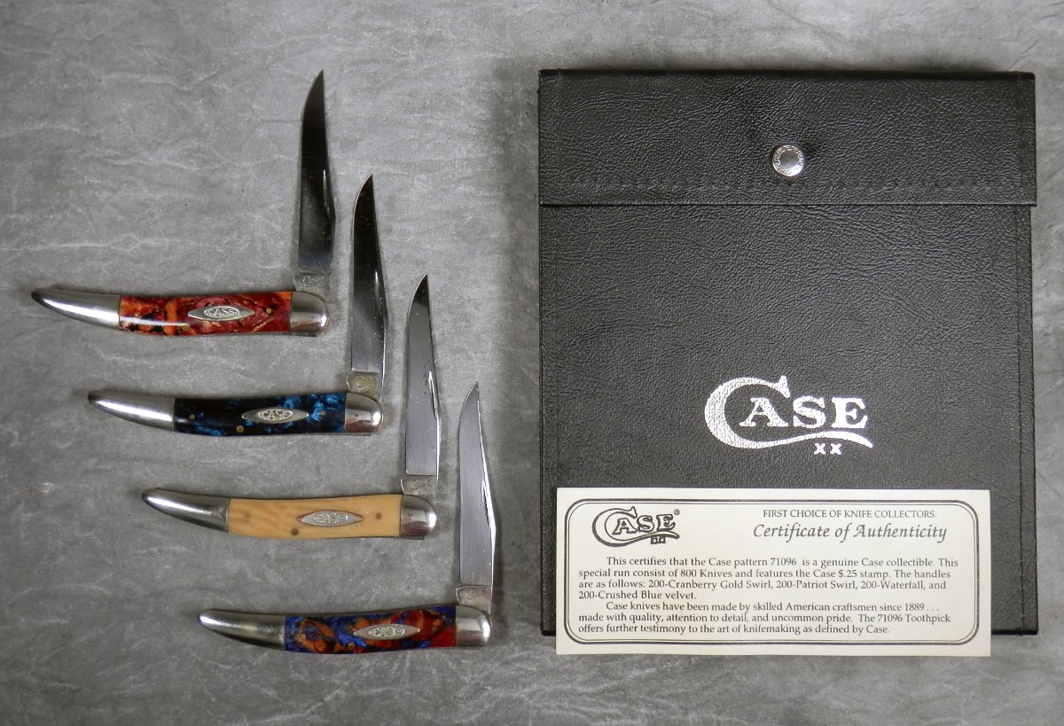

If my memory serves me right, Parker put these out when he was head of Case. The whole set included the 25c, 50c, 75c and the $1.00 knives.

I believe you're correct. I've got an old ad somewhere from a Parker flyer showing these knives.
He was the P.T. Barnum of the knife world.

The only versions I’m aware of Parker doing were the Case Classics set, which were Toothpick patterns and did include .25¢, 50¢, .75¢, and $1.00 versions. These “Toothpick” versions are described in Witcher’s Counterfeiting Antique Cutlery. Those of course were not made by Case. The authentic originals by Case are barehead 6106 patterns.
The jigging on the OP knives (see seller’s photo below) is definitely not Case jigging. If someone has documentation of Parker having made these in the “boy’s knife” pattern, I’d like to see it.

Thanks for jogging my memory Ken.Mumbleypeg wrote: ↑Mon Dec 07, 2020 4:22 pm The only versions I’m aware of Parker doing were the Case Classics set, which were Toothpick patterns and did include .25¢, 50¢, .75¢, and $1.00 versions. These “Toothpick” versions are described in Witcher’s Counterfeiting Antique Cutlery. Those of course were not made by Case. The authentic originals by Case are barehead 6106 patterns.
The jigging on the OP knives (see seller’s photo below) is definitely not Case jigging. If someone has documentation of Parker having made these in the “boy’s knife” pattern, I’d like to see it.Tim, if you find your flyer please let us know what it shows.
The ad I have (had) was of the Toothpick.

Thanks Tim, that’s what I remembered also. So we’re back to the original premise that the eBay seller’s knives are counterfeits.

Yep.Mumbleypeg wrote: ↑Mon Dec 07, 2020 6:13 pm Thanks Tim, that’s what I remembered also. So we’re back to the original premise that the eBay seller’s knives are counterfeits.
What's throwing me is the other close up photos of the tang stamps don't appear to be cold stamped.
But the covers are not a Case jigging. I believe the knives are not genuine.
