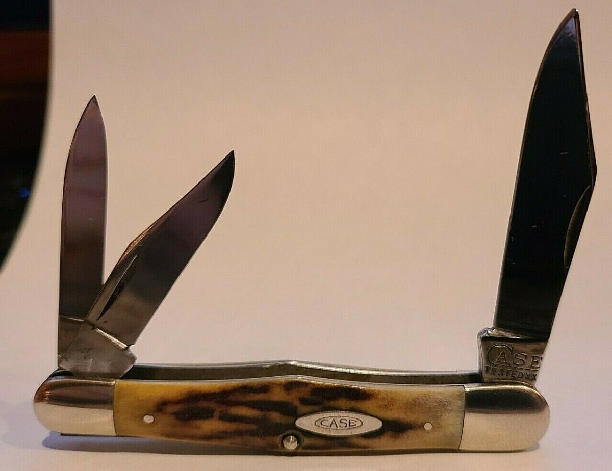

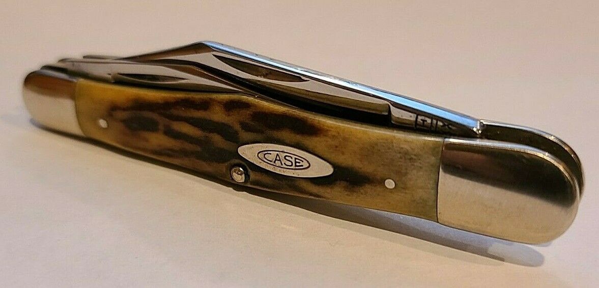

Here’s another counterfeit Case Tested 5383. https://www.ebay.com/itm/CASE-XX-TESTED ... Sw1A1f2UAy Note the shield which has the open C and “squatty” S which is indicative of U.S.A. and dotted era (1965-1979) knives, plus what appears to be Sambar stag which I’ve never seen on a Tested era knife.
If you read the seller’s description, this guy could easily be me. I bought a supposed Tested era 5383 in the early 1970s, with the same shield and similar Sambar stag, from a well known Tennessee dealer. Had it not been for Jim Sargent and Tony Foster telling me otherwise (and why), I too could be believing to this day the knife was legitimate. Here are the seller’s pictures
Counterfeit Tested 5383

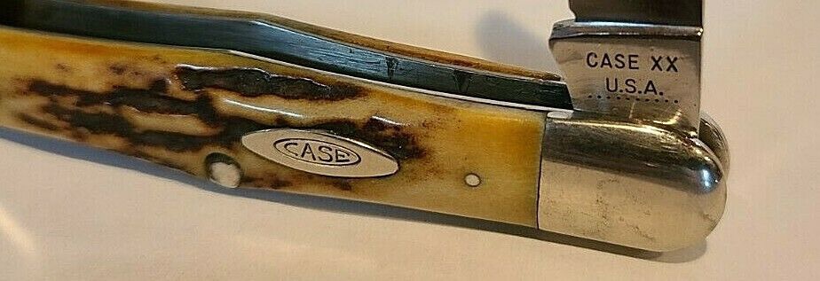

Interesting that the same seller has another 5383 which is a 10 dot (1970) version. https://www.ebay.com/itm/CASE-XX-STAG-W ... SwzJZf18nn
It’s a legitimate knife. Note the picture of it shows the identical shield as his supposed “Tested” version, and similar stag. The two knives could have been made on the same day. ::facepalm::
Case XX U.S.A. Ten dots

“Mere mortals” can educate themselves before laying out their cash for expensive knives. A serious collector of older (especially often counterfeited brand) knives should invest a little of their money in some good reference books and study them. Then you’ll at least know what to look for. Sargent’s American Premium Guide to Knives & Razors, Witcher’s Counterfeiting Antique Cutlery, and Pfeiffer’s Collecting Case Knives are a good start, all resources which were not available 45+ years ago when I bought my counterfeit Tested 5383. ::facepalm:: And as Roland says, if you’re unsure ask before you buy.
