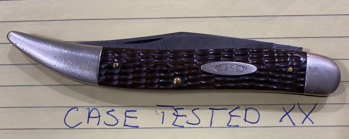

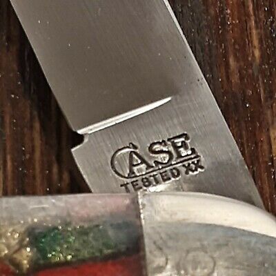

The below knife is a queen #20 with the tang stamp shaved and replaced with a "Case Tested XX" cold stamp. In later years Queen shorted the length of their end cap, that's the dead givaway on this one,There are other more subtle differences, for sure, as there are no two companies that made the EXACT same handle dies. The covers are really unusual, Sorta "Gummy Worm"--to coin a term-- plastic of some kind, . I don't recall seeing this particular type before, but they aren't the original Queen Handles which were either bone, fake winter bone, or more modern plastic (90's Era). (As always, I welcome corrections).

Good analysis Robo. I've actually purchased knives from this seller before, and have known him to be a pretty honest guy. So I am surprised that he is selling this obvious fake. As you said, the rear bolster is a dead giveaway. I think it's only about 1/2 the length of a real one. In the auction he even admits that everything doesn't fit together properly: "TO ME IT APPEARS THE BLADE IS CLOSING TO FAR OR SNAPPING SO HARD THE TIP OF THE BLADE IS HITTING AGAINST THE BACK SPRING".
