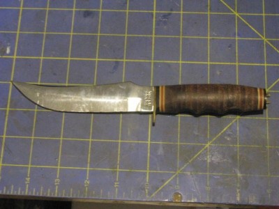

Thanks for the prompt reply Gene! Here is a pic of the knife and the end.It is a split tang similar to the Western knives.I only paid $5 for it and the blade is very full.

That looks like a solid tang knife with the split on the end for a poured lead plug in the pommel. It also looks like it is a bit short but you could probably pour lead in and it would still work. Sorry, I don't have any junkers or parts for those later knives. I guess you'll have to find another Kabar with a poured lead affixed pommel as a donor. Might not be too hard to find one with a broken or ground out blade with a decent pommel. Kabar does sell leather rings and replacement pommels for their re-issue USMC knives, but I have never heard of them selling any parts for other knives and I doubt they would have parts for older knives, you could ask, only takes a phone call. Case will repair their knives back to a certain point but does not sell parts. Hard to pass up a knife for five bucks!! Maybe pull the handle and drill and hog out a piece of antler and just put an end cap on it??

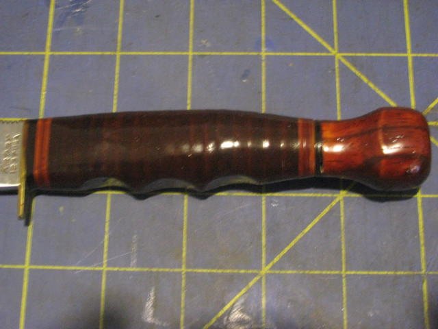

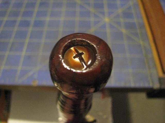

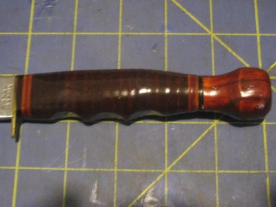

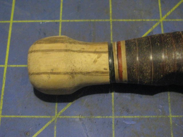

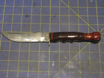

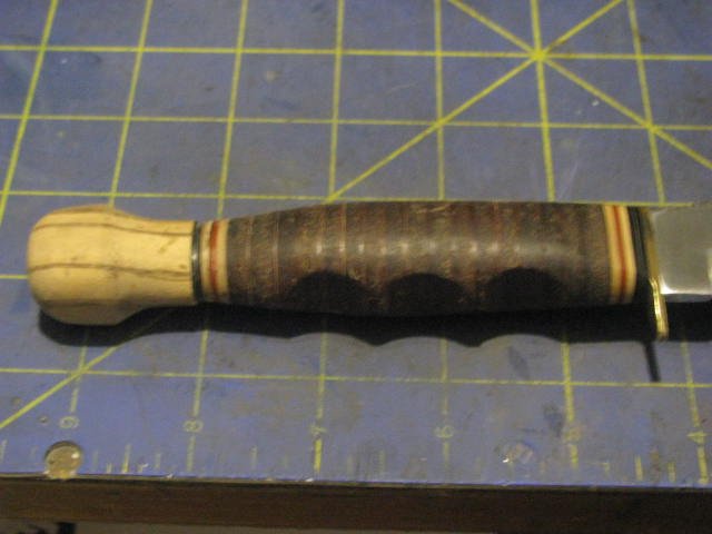

EDIT: Decided to give a go at repairing the knife.Took a small carriage bolt(10-24 or 12-24 I forget which)and ground the head down to fit between the split tang end and JB welded it in place.When that was set I took a barrel nut of the same thread and fitted it to the bolt.Made the pommel out of a piece of hard wood I had laying around the shop.Drilled it to fit the barrel nut and used a larger drill to countersink both ends.One end provides clearance over the portion of the tang that sticks out and the other puts the head of the barrel nut inside to be covered over later.I think I might get a small domed plug that snaps into a hole for the finish. Here is what it looked like just before I applied the stain to it.I also shortened it a bit.

Almost done;just need a small cap to finish the job.

That’s a fantastic job! I have a little b/t knife with a missing pommel and that would be a great fix fir it. ::tu::

Nice save, Ray. ::tu::
