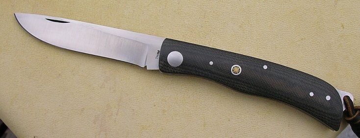

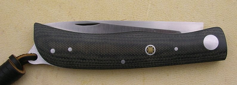

One of the knives i bought from Phil is a 4 7/8" Sod Buster style knife which i like very much. When i received it i used it to slice a few things, carried it for a couple of days and then put it into a knife roll and stored it in my safe.
A few days ago i got it out thinking i'd like to carry it again. Upon opening the blade i find it has a noticeable amount of lateral blade play. I'm sure if it had this when i received it and used it (very lightly, no 'pressure' cuts) i would of noticed.

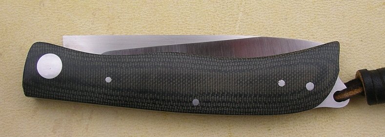

Roland! I am by no means an expert regarding pivot pins, but, in the bottom picture the bottom side pin appears to be sitting a bit proud compared to the pin on top, not as flush with the cover so to speak, so a gentle squeeze in a vise might just tighten it up. As mentioned above, soft jaws and perhaps wrap it in a cloth as well. Best of luck with it!

Roland I don't think squeezing that knife in a vise will accomplish anything but damage it. In order to properly tighten a pivot pin it either needs to be flared by peening or compressed somehow. Compression, if you could even accomplish it evenly without bending the pin would fatten the pin causing other issues. That knife appears to be constructed with a stainless birdseye washer which would also have a matching stainless pin. Those pins are far harder than nickel silver so trying to compress it in a vise will do nothing but bend it in all likelihood. The force required would be much more than a light squeeze and you would most likely bind up the blade in the process. If by chance he used a bushing in the tang that's just a hair larger than the tang's thickness then squeezing won't do anything either as you'll be up against the bushing, but you'll still likely pop the pin.
I doubt very much that there was any shrinkage involved with those hafts and it looks like the pin is still perfectly flush with the birdseye washer so the most probable scenario is that the pin may have been a bit sideways when it was peened and by opening and closing the knife a number of times you may have straightened the pin or bolster alignment out a bit making that space ever so slightly larger. Is it really super noticeable or is it just a very slight wobble? If it's the latter you might be better off just leaving it as is. It doesn't affect the performance of the knife at all. If it's really bad the only real fix would be to peen the pin and hope that the accompanying grinding of the birdseye to remove the hammer marks doesn't remove whatever's left of the pin heads. If the problem is a too big bushing the knife would have to be dis-assembled.

Today's custom makers typically use either phosphor bronze washers or bearing sleeves. Probably the bearing sleeves more than the washers. The sleeves sit inside the blade pivot hole, and are a few thousandths wider than the blade, so the blade doesn't encounter any friction against the liners. Also, the liners are typically relieved around the pivot area to reduce or eliminate friction. That looks like a type of birdseye pivot on your knife. If the knife has the phosphor bronze sleeve construction, then the pivot pin can be hammered as hard as can be and it won't affect the action.
Of course, if the knife is not made using that technique, then disregard everything I said. Regardless off all that, those materials used in that knife do not appear to be the type that would shrink over time, so your blade play issue is odd.
