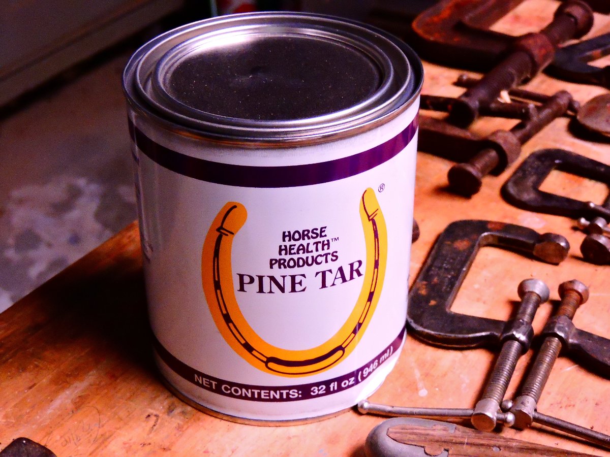

I was watching a guy on you tube for a while and he liked this pine tar mixed with turpentine. 50/50.
Seemed plausible enough so I bought some. Haven't used it yet.
