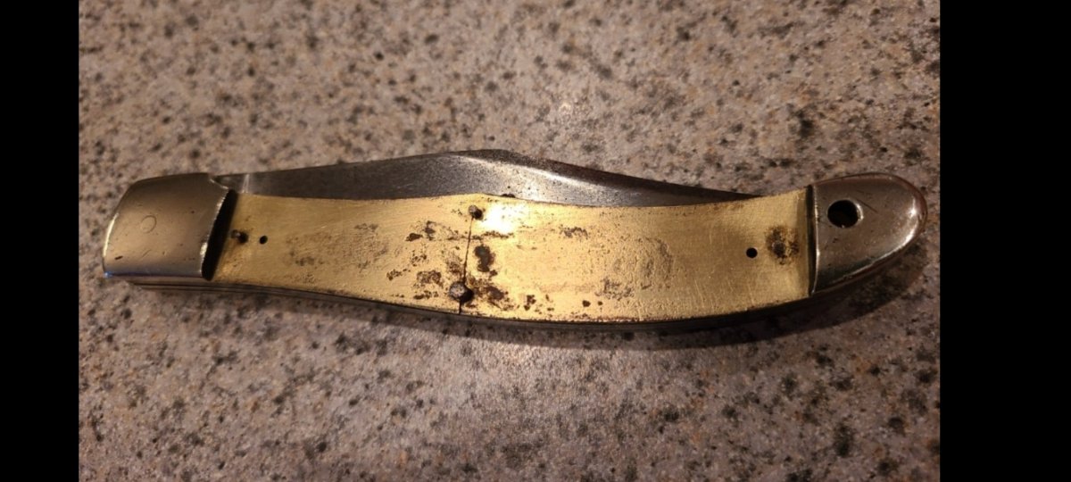

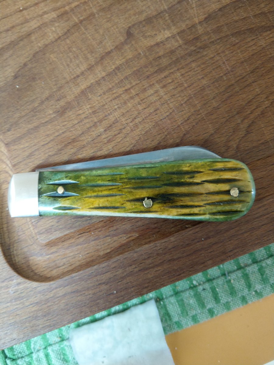

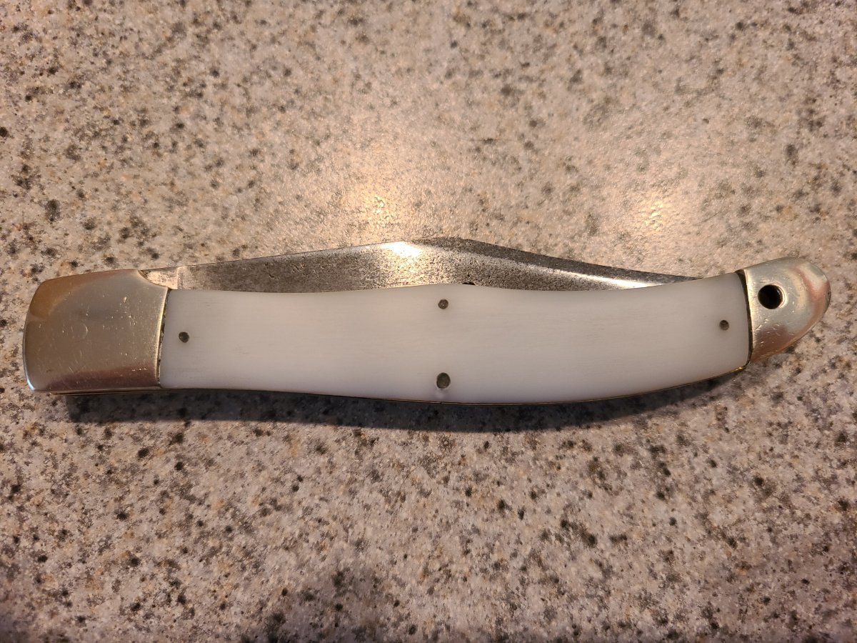

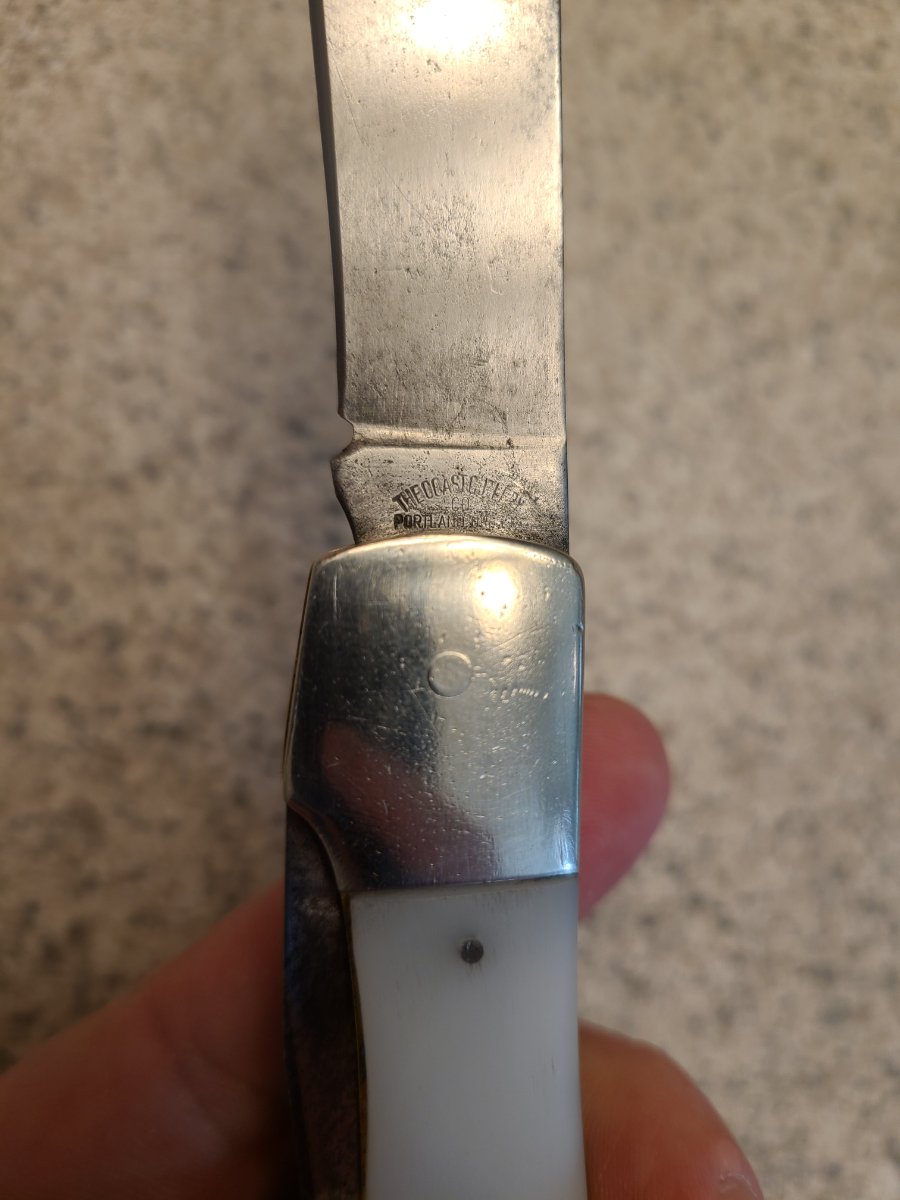

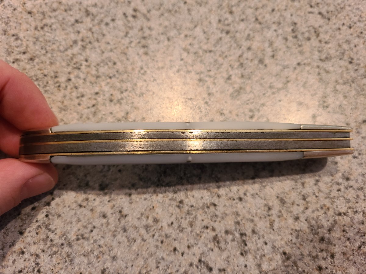

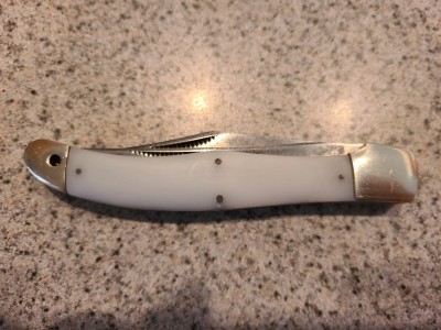

I have to say I am very happy withhow this old Coast Cutlery Folding Hunter turned out. Had some help from my father, who had never rescaled a knife before, but he has alot of tools that we were able to piece together and get it done.

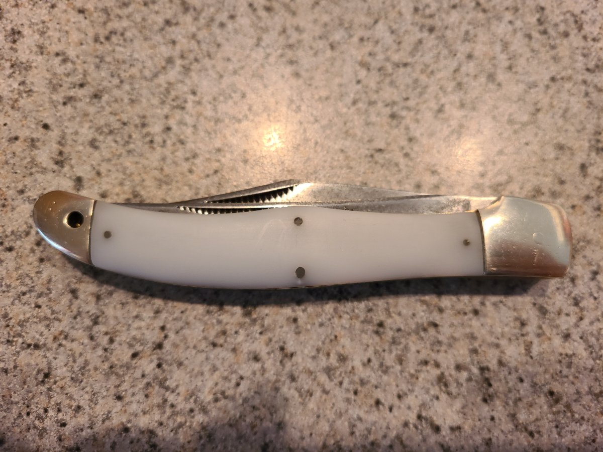

Reverand wrote: Fri Apr 30, 2021 2:18 am That looks good!
What did you use for scale material?
We went with a HDPE plastic from a thin cutting board and traced out the scales and sanded them to shape and feel. It was a lot of work, but also a lot of fun for us. It will be my main deer and elk knife for years to come.

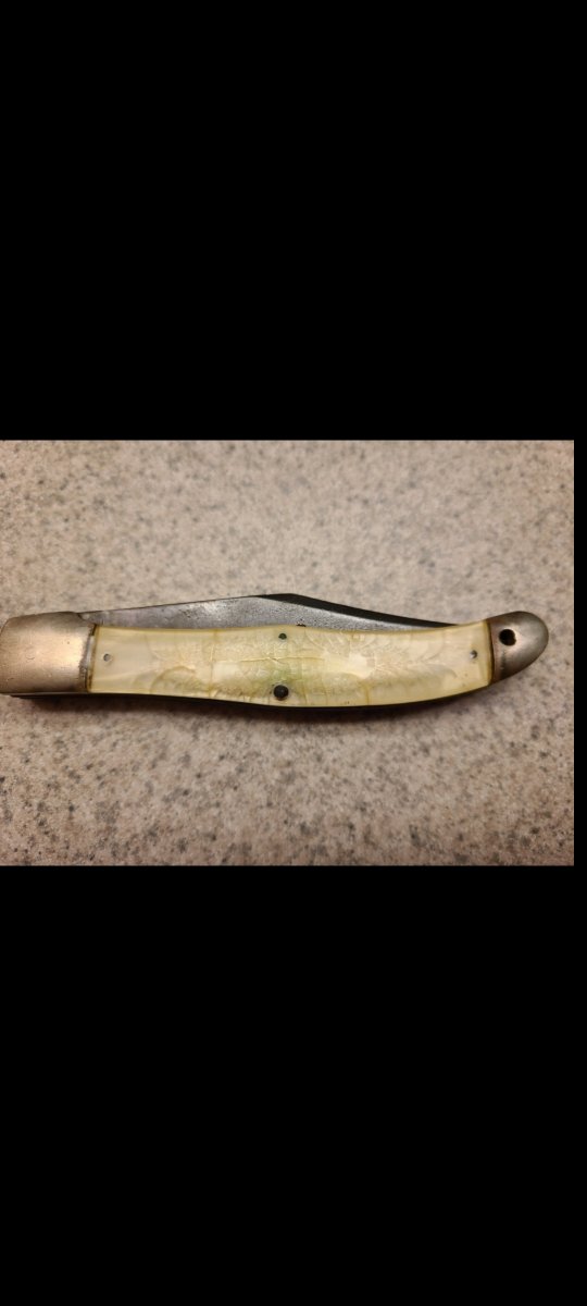

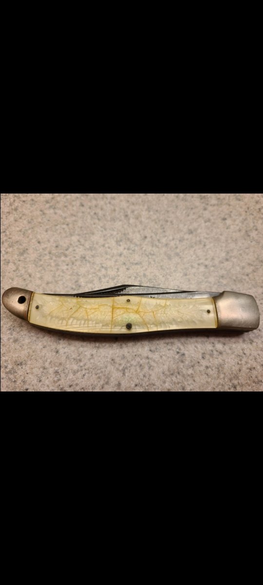

I'm thinking of having a go at rescaling a knife. I have hunted around for a knife maker but they are thin on the ground here, and the couple i have contacted did not get back to me, maybe something to do with Covid. I have never attempted this sort of work before, have enough tools i think, it will nearly all be done by hand, i am hesitant, don't want to stuff it up. This is the knife, and the wood i want to use to replace the scales, would value fellow knifers opinions on how you think it would look. The wood does look a bit bland in the photo, and once sanded and polished will improve. ::undecided::

Hello Cudgee. I don't know what kind of wood that is, but to answer your question I would need to know how you plan to use the knife (if at all). I have used various exotic woods on a lot of knives (desert ironwood, ebony, wenge, etc.), and these are all hard, dense woods (as far as wood goes), but these knives all spend most of their time sitting in my collection, or someone else's collection. Wood would not be my first recommendation for a knife that is going to get a lot of use, like a work knife or even an EDC. A good, very tough, durable material I like to use on my EDC's is micarta. I happen to like OD green canvas micarta, or any canvas or burlap micarta. (I can attach some pictures if you want to see what it looks like.) As far as how to do it, there are a bunch of great tutorials here on AAPK, and I recommend that you view some of them before you get started. I also recommend that you practice on some junkers before you get started on a good knife. And, you can always ask questions here and there are a lot of knowledgable people willing to offer advice. But, be careful, this hobby is quite addicting! Cheers mate. :D

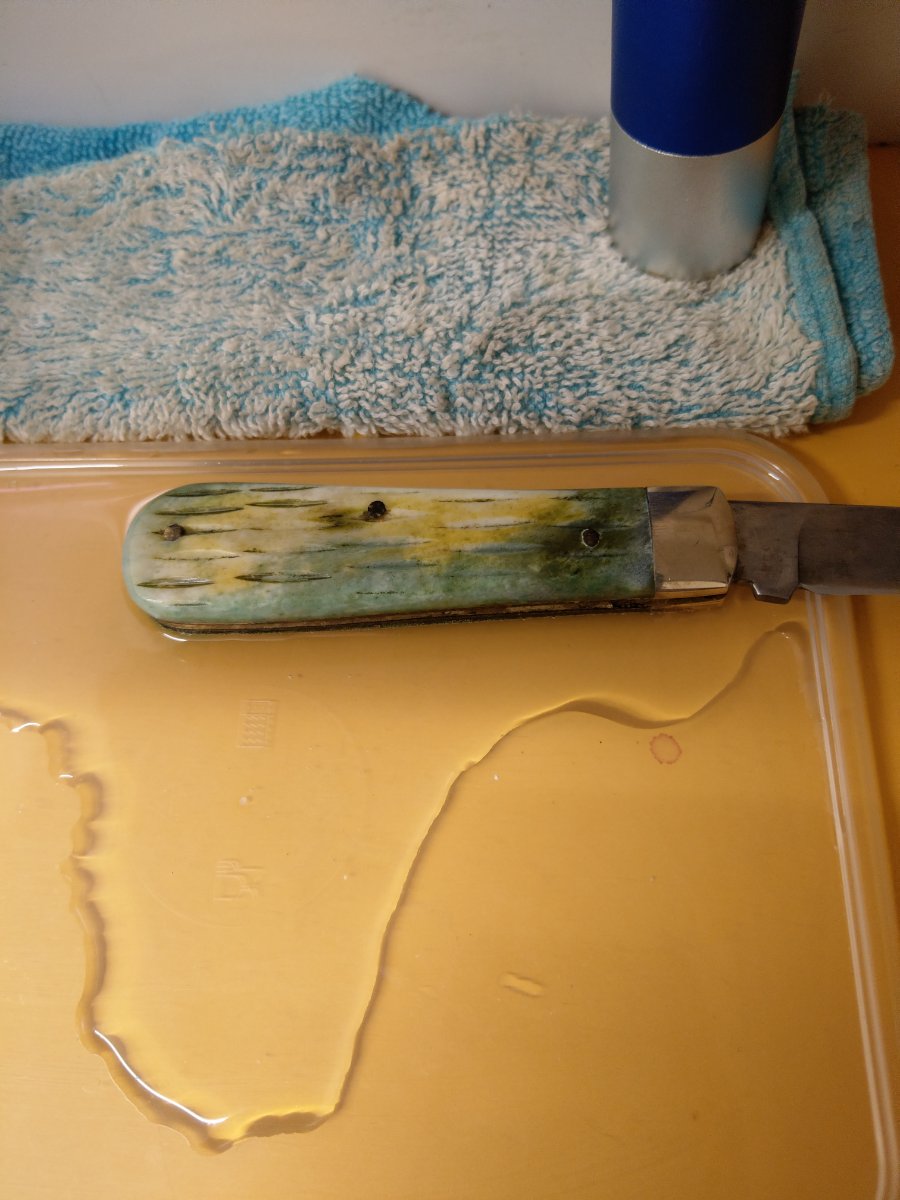

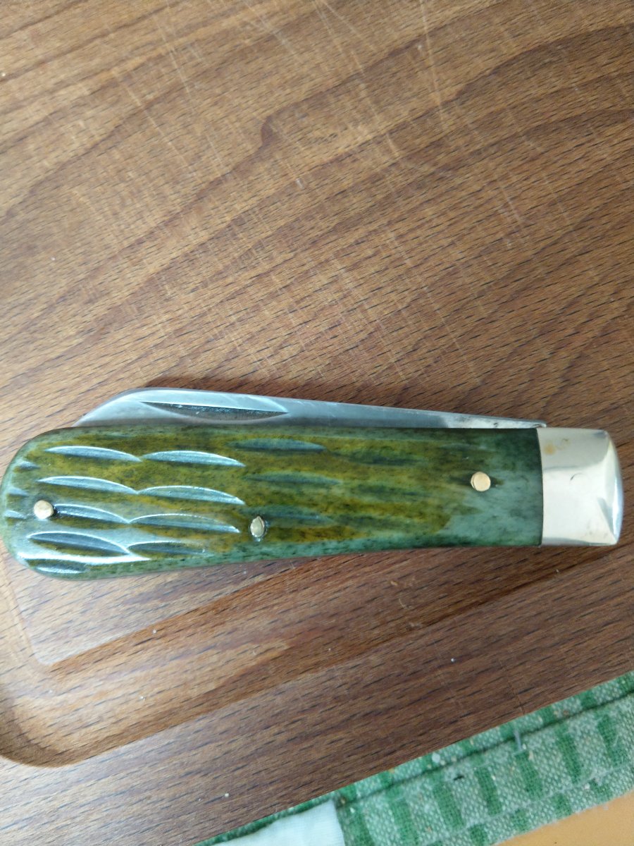

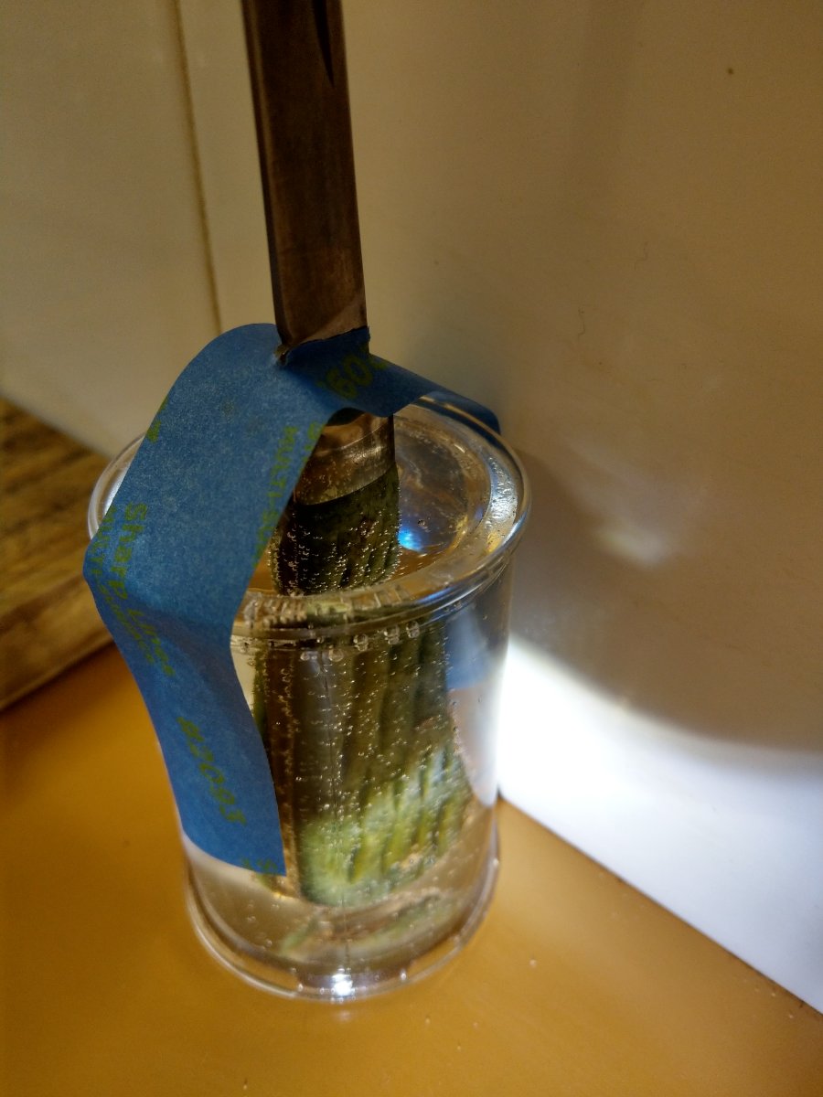

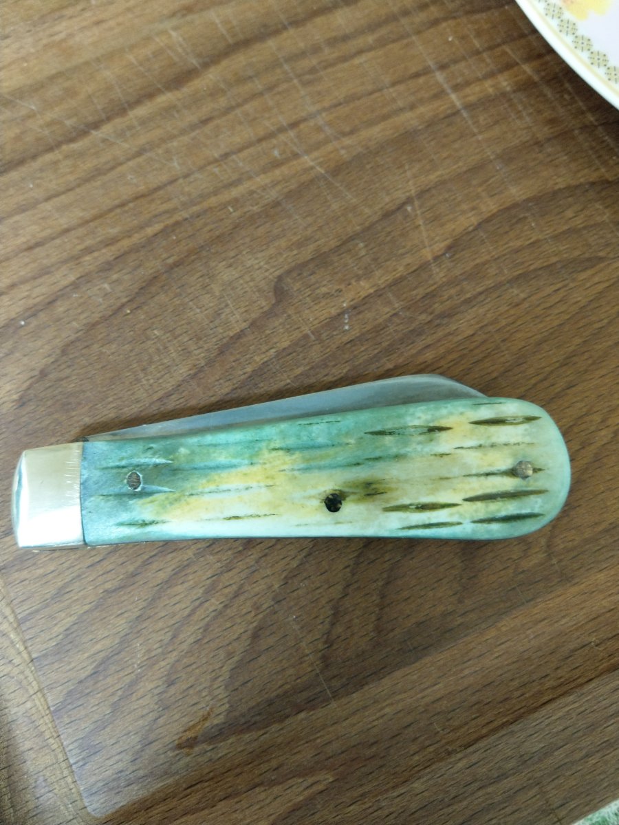

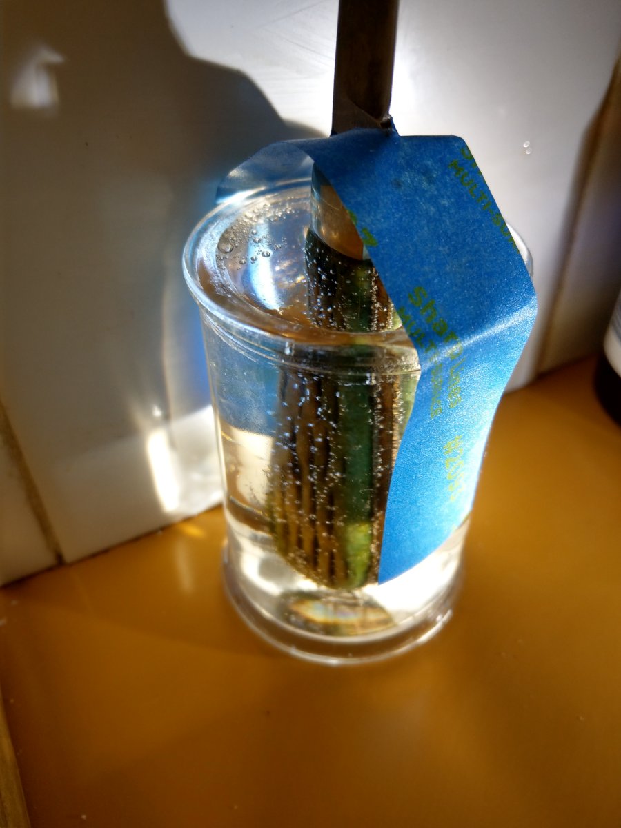

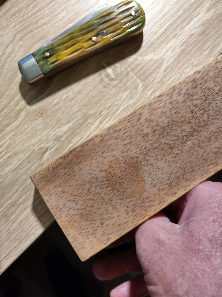

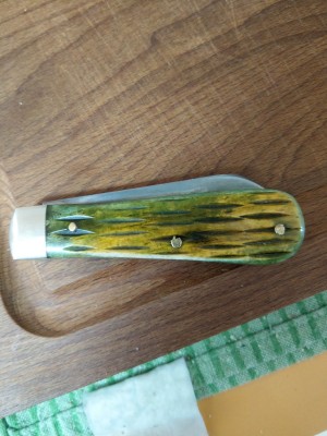

Here is an update, i sanded it down to wear down the " Jigging " and get rid of the plastic look, i then did some research on dyeing the bone, but mixing colours was going to be an issue, and once you start you cannot go back and may end up with a worse colour than you started with, so i decided to do it in a staged progression and see how i went. So i have tried to remove all the original dye by soaking it in a Hydrogen Peroxide bath, i kept a eye on it as all the things i read said do this for between 12-24 hours, after 12 hours not much difference, after 24 hours some difference, so i decided to leave it longer, after 36 hours the lighter side was starting to show white bone which is what i was after, so i left it for another 13 hours, 49 hours in total. I was not going to risk it any longer as i did not know what effect the Hydrogen Peroxide would have on the bone, now i used 3% solution, i have 6% but wanted to try 3% if i needed to leave it longer in the solution, 6% may have worked better. This is all a new experience for me and an experiment and i want to do it slowly so i can help others into the future with what does work and doesn't and what NOT to do, information out there is sketchy at best. Now this is only my opinion, but i am inclined to think that this method works best on light colours and not so much on dark colours, this is how the process came out, and lighter colours are usually not in the dyeing solution for as long so it sort of stands to reason, but that is only my opinion on what i have observed, and i hope what i am doing will be able to help others. Anyway, i have some decisions to make, which i am going to ask fellow members for their advise, including your good self. Here is a pictorial progression of what i have done so far. There will be more instalments. ::tu::
This is the original bone, was bulky and cheap and plastic looking, and a terrible colour.
Hydrogen Peroxide bath, 49 hours at 3% solution.
This is the result
Big improvement already, with the sanding down of the covers and the bath, looks real and used and not a garish colour.

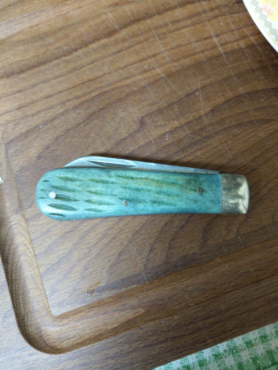

Next stage. Trying to balance up the remaining dye in the covers after first removal process.
