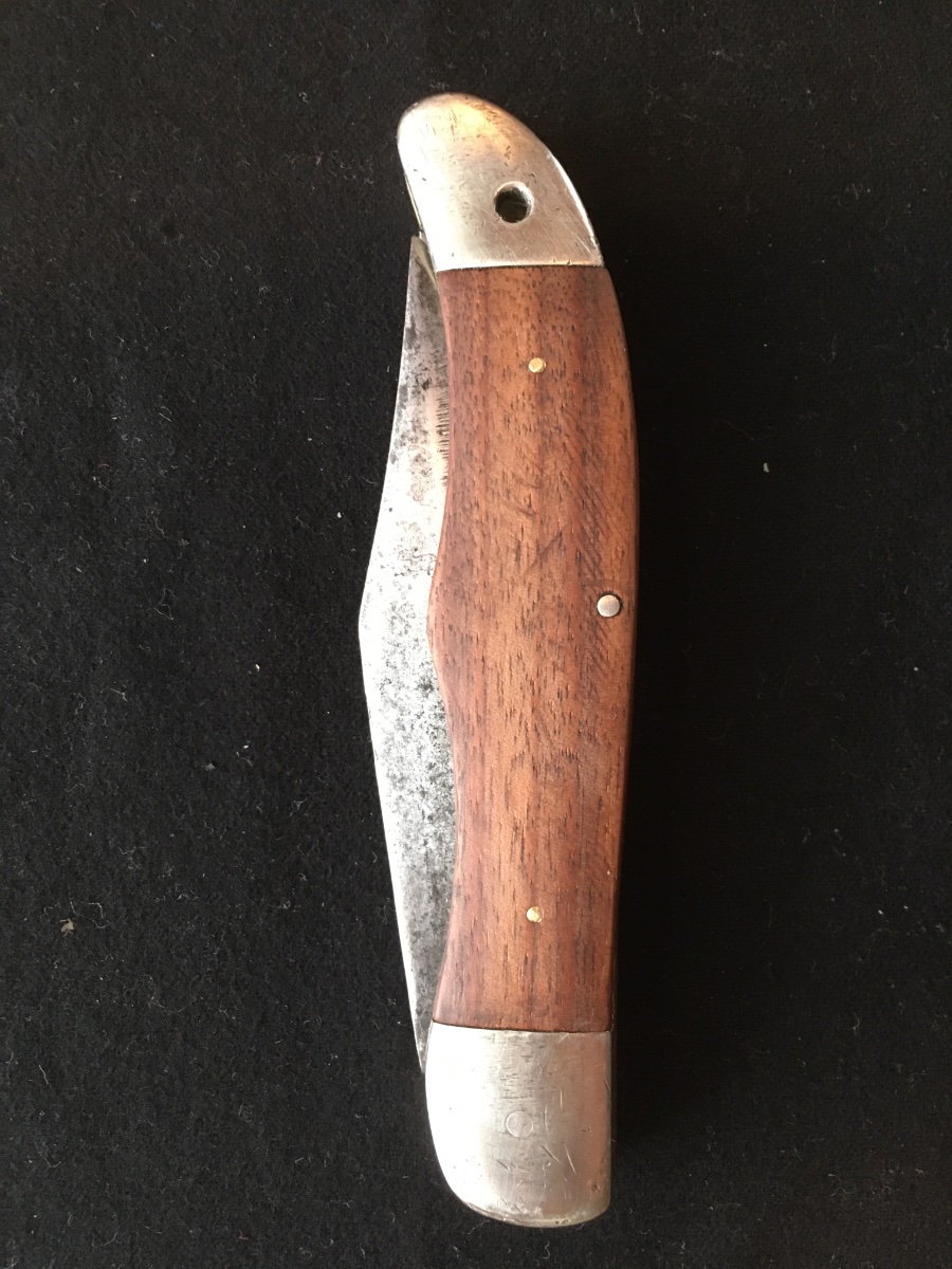

So I got this Case knife pretty cheap. Broken handle and spring pivot pin; blades worn and sharpened, but not horribly so; springs were intact. I tore it apart, sawed up a piece of walnut for the handle, and started working on it.
I will say this is the first time I've used wood for a handle, and I'm quite pleased with the way this turned out. Of course, it's bigger, so the wood would be harder to crack (which it didn't do!), but I'm still pretty pleased that it came out as well as it did.
The bolsters were pretty dinged up , and I decided to leave it with the "rustic" look, as I would have lost .030' or more getting some of those divots out.
I also didn't do any more than use some fine steel wool on the blades and springs to get the rust off and smooth things up.
I did get the lathe put back together and turned down a pin for the blades--I did better than I thought I would; got the right size with very little run-out on the first try! That was gratifying. It's been a long time since I've been in a machine shop--and the lathe I have is much more primitive than the ones I used to use.
Putting the knife back together went relatively smoothly, thanks mostly to the tricks I've learned here and the knowledge gleaned from mistakes of the past.
Oh, and I shaped the heads of the handle pins on the lathe too--that was a big improvement over my past efforts.
I'm thinking of taking the kick (is that the correct term?) on the clip blade down a little, as the tip of the blade stands proud of the handle by a little (maybe .060"). I think I can do this without risking the edge hitting the spring if I'm careful--do you guys do that kind of thing in a situation like this?
I'm not sure what I'm going to do with this one--it's a little big for a carry for me, as I keep my EDC in the same pocket as keys etc, and this will really bulk out my pocket. I'll think of something, though...
Brent

Outstanding work! That one would fit real well in my overalls pocket. I have a newer version of that one that I carry in the fall to unzip Babi’s britches. They’re great knives.
Robert E. Lee
Posts: 21499
Re: Case 6265 SAB
Excellent job! ::tu:: I like that wood grain too, really sets it off.
treefarmer
Posts: 15151
Re: Case 6265 SAB
Post by treefarmer »
Very nice save! I would say that one would be easy to carry just like Bro Wade described. :)
Treefarmer
Meridian_Mike
Posts: 5041
Location: Mississippi
Re: Case 6265 SAB
Post by Meridian_Mike »
Nice save!
My first knife clean-up and re-cover was done with wood. It lets you get your feet wet in knife repair and is a forgiving cover media.
Good work!
::tu::
P.S.....
IF you adjust the kick at all..... be VERY careful. A little off the kick goes a LONG way.
(It look fine in profile to me.....)
