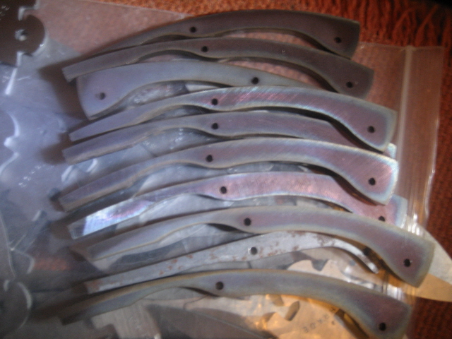

dudleythetogi
Posts: 412
Joined: Tue Jan 08, 2008 1:17 am
Location: N.J.
backsprings
Post by dudleythetogi »
I have a few.If you think you can use one send a pm,as you can see they have quite an arch to them,are about 1/8'' thick,and 4 3/8'' long and,I believe heat treated.There are two smaller straiter ones,about 3/32''thick and 3-3/4''long,one maybe HT,the other maybe not.
Greg
