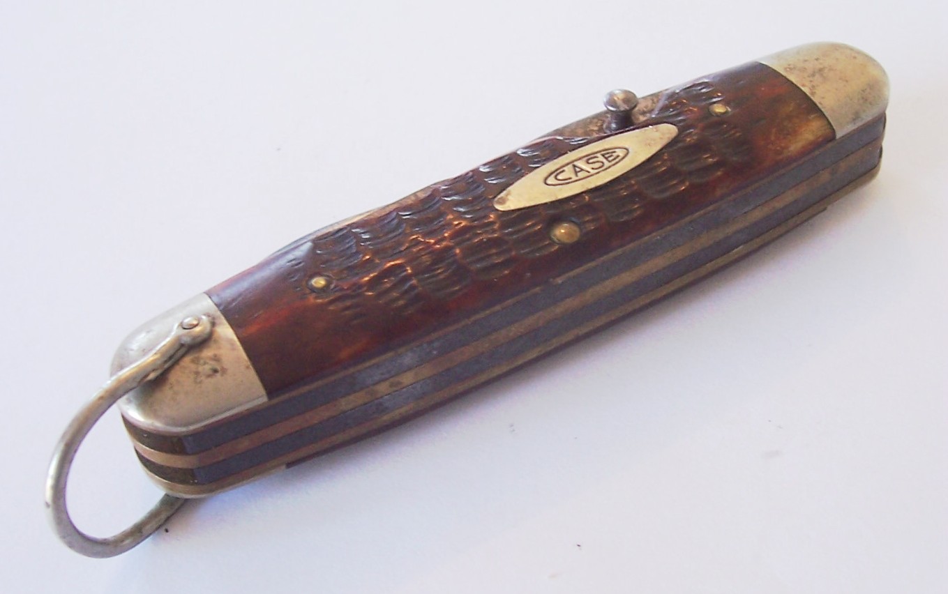

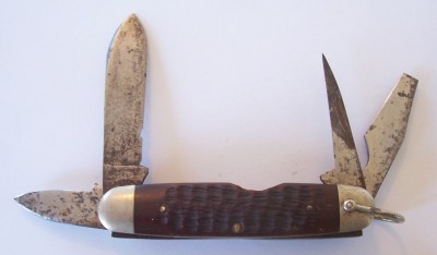

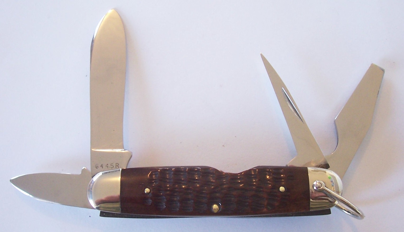

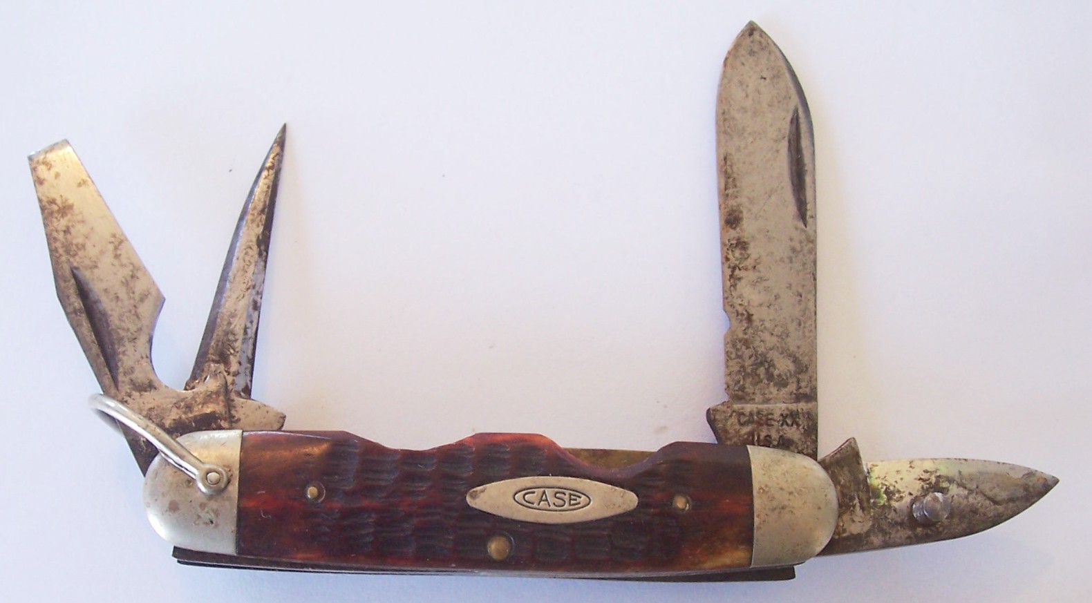

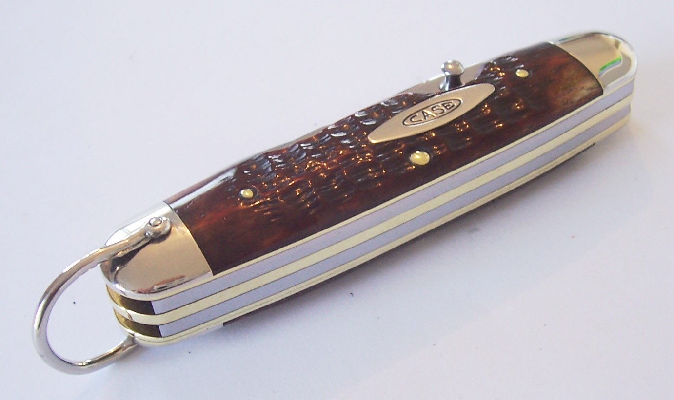

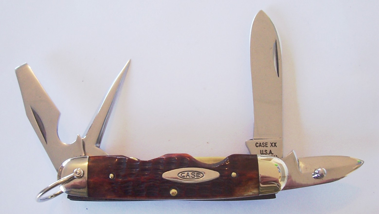

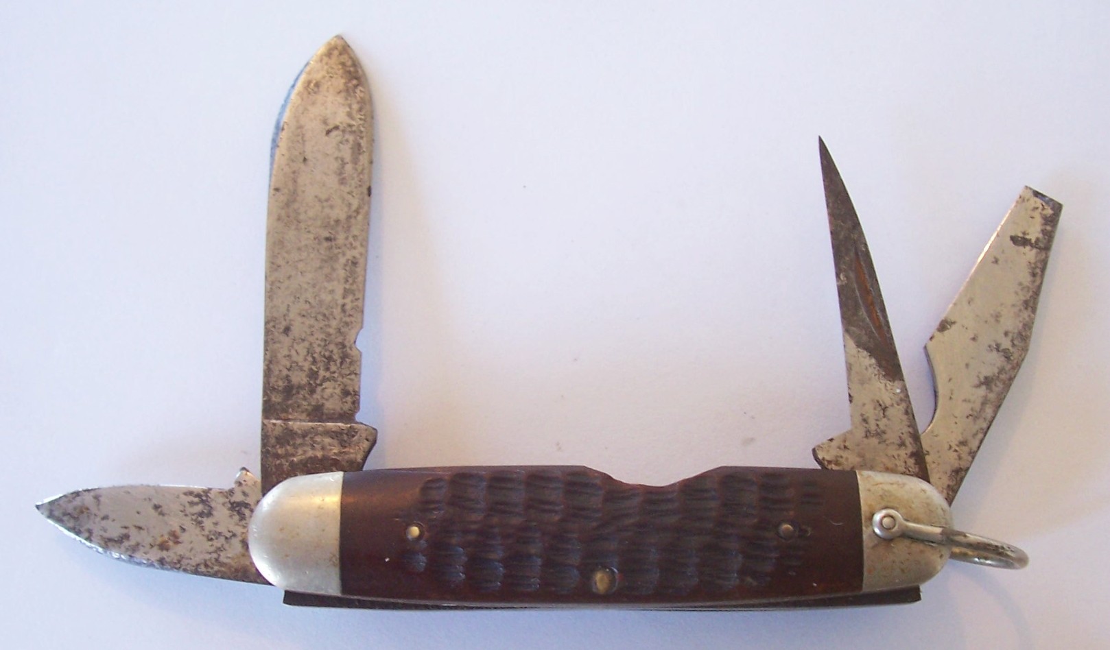

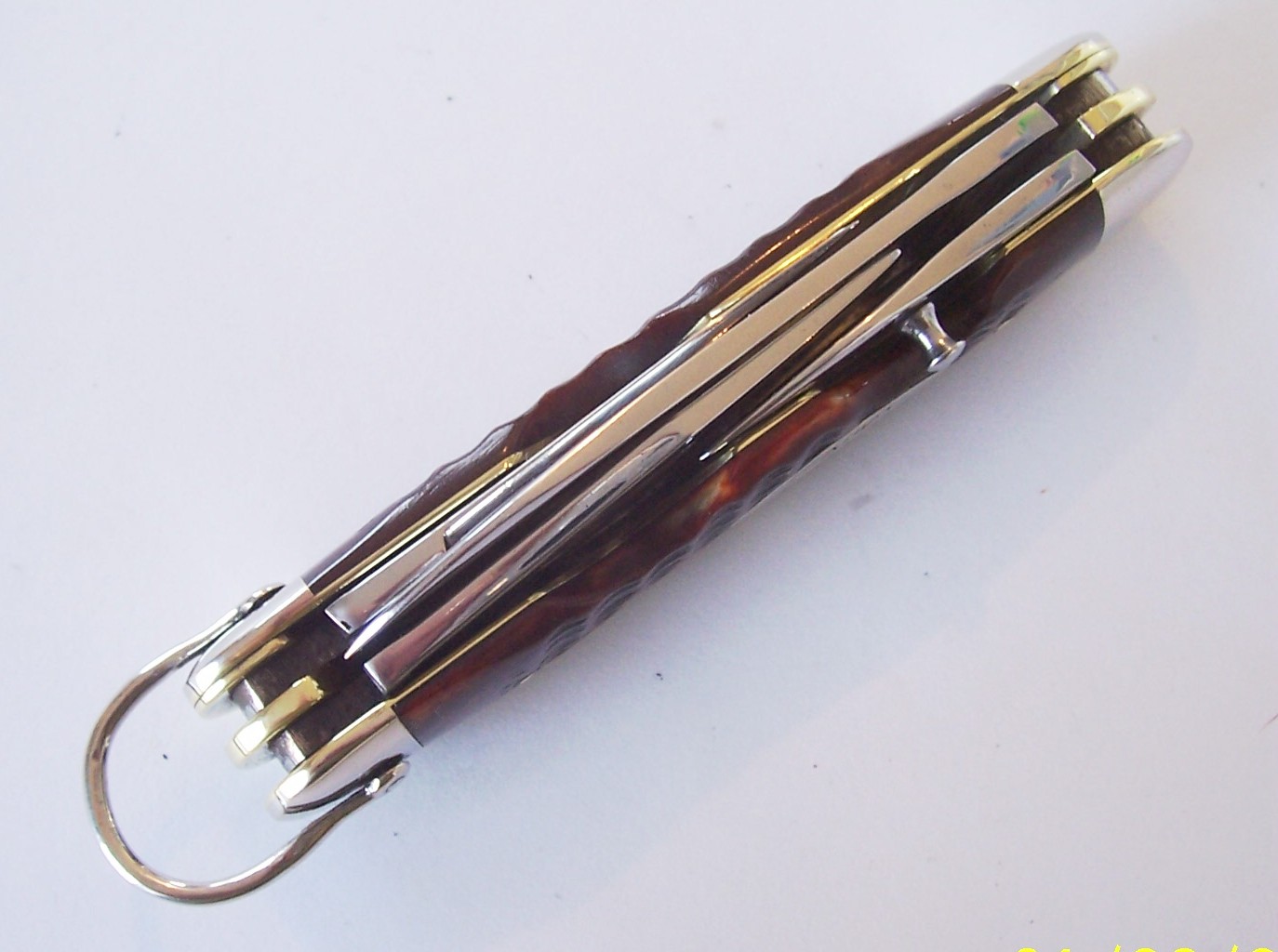

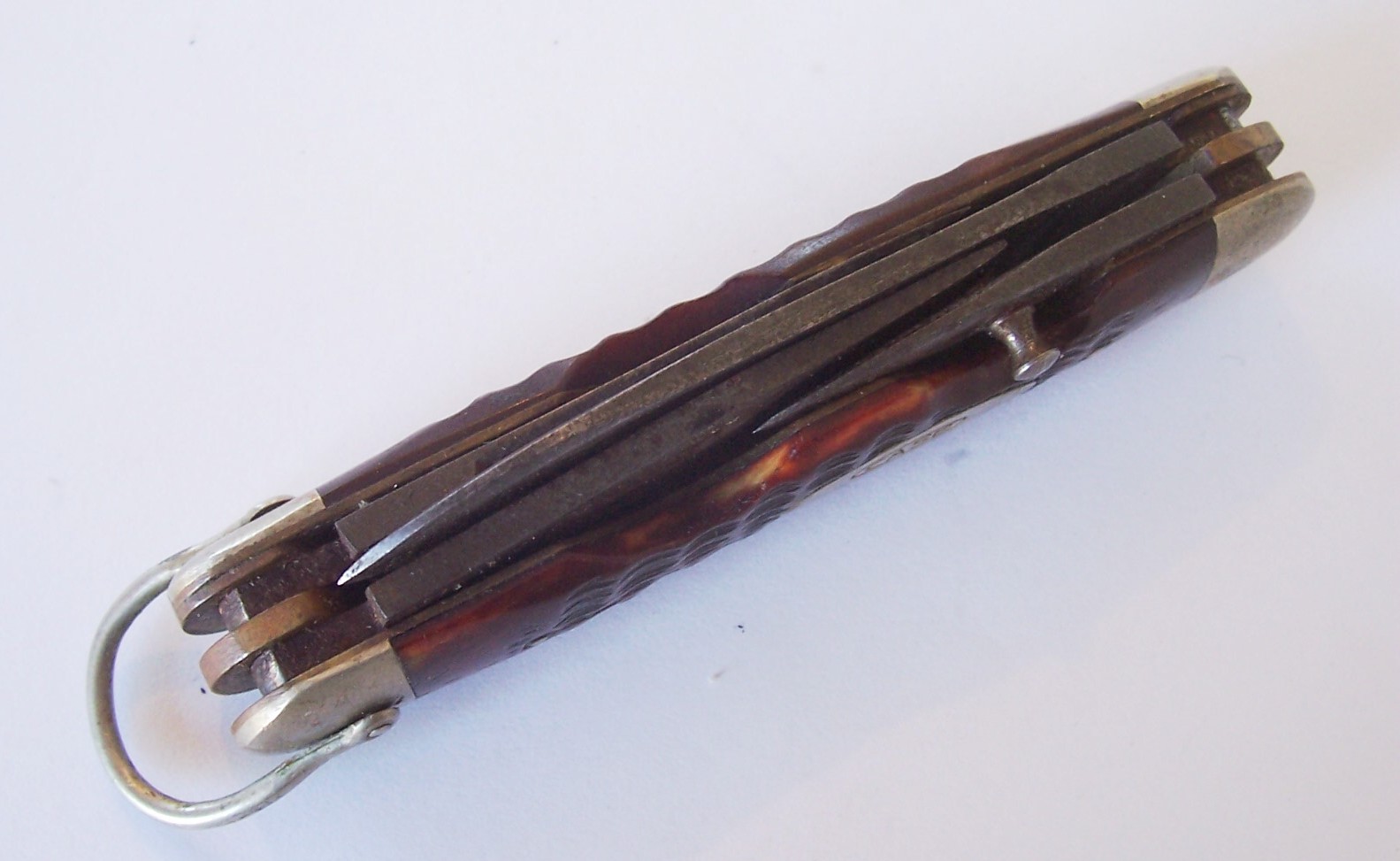

heres a nice old case xx 10 dot, 1970 red bone scout 6445R that i just finished restoring. i took some before and after pics for comparison.

Nice job Steve! ::tu::

Very nice restoration! Would you care to share your method of cleaning?

thanks guys. i collect the 10 dots and i got a steal in this knife because of the condition it was in but the blades werent pitted, just really dirty and dark with some patina and rust but all the blades are very tight and have great snap......just about break a nail opening them.
as for the cleaning, i used a dremel and started out with some 500 grit sandpaper cut out from a sanding belt in about a 1-2 inch circle to fit the mandrel.....i use sand paper from a sanding belt because its stiffer than sheets and holds up longer. i dont use anything that dremel makes besides the tool itself and the mandrel......all there stuff is too rough to get a fine finish when youre done. i go over the knife lightly but thoroughly, being very careful around the tang stamps and contours of the blade, to remove all the dirt and rust, then after doing all the blades and backspring, i go over it again with some 800 grit which is the finest ive been able to find in a sanding belt and get it nice and smooth with that. i use these fine grits because the 500 grit is just coarse enough to do a great job removing the dirt and rust but doesnt remove alot of metal in the process and the 800 gets her nice and smooth in preparation for the buffing. then once all the blades and back spring have been gone over good and are nice and smooth (this also works great on bolsters that may be beat up), i move to the buffing. then i just buff the knife, being sure to keep plenty of buffing compound on the wheel so as to prevent over buffing and not rescratch the blades and it removes any scratches from the sand paper. then after the buffing was done, i sharpened out the nick that was in the main blade and wipe the whole knife down with a clean rag to finish the job and give her a nice shine. all in all, it took me about 2 1/2 hrs from start to finish on this knife, including cutting one thumb in the process :lol: .
the knife was in pretty rough shape when i got it, but now aside from the main blade being sharpened some, you can barely tell its been used and it shines like a new piece of jewlery. it looks great in my collection.

yes gary, it looks like the set up you have there with the nail, only i use a dremel mandrel but pretty much the same thing. i tried using some of the wet/dry sheet sand paper but it wears out too fast and is too flemsy for me. it just doesnt have the back bone that the belts have beause they have a backing on them that makes them stiffer and longer lasting. as for the buffing, i dont do any buffing with the dremel, i use my delta variable speed bench grinder with cloth buffing wheel for that.

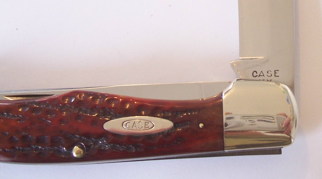

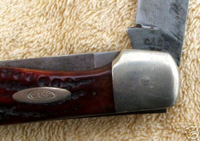

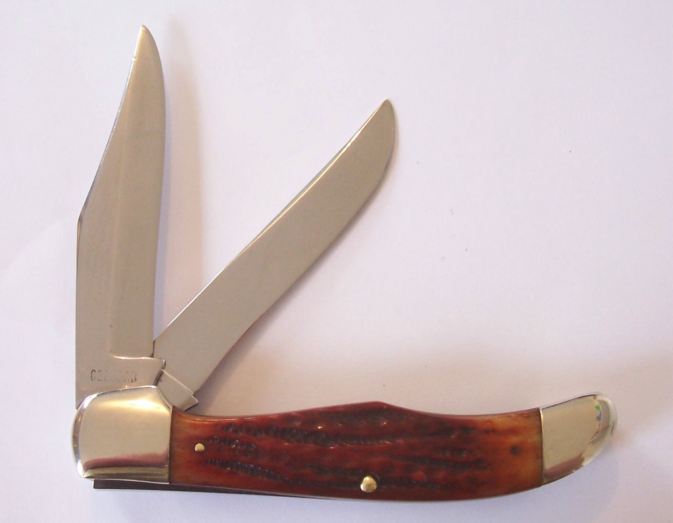

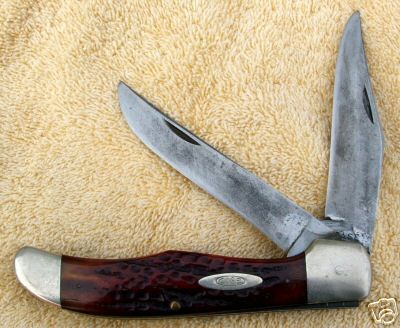

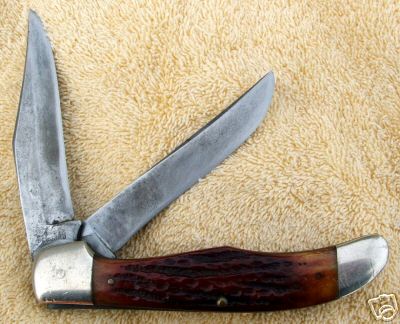

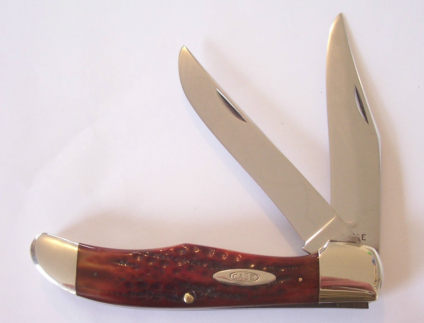

heres another knife that i picked up a couple weeks back. the before pics are the sellers pics i bought the knife from and the after pics are the ones i took after i was done with it. i really like the red bone handles on this one.

Nice work, really well done, I have been thinking about a folding hunter - BUT really I have too much on my plate. Still if I find a deal I can't pass up ::shrug:: I need to get that Barlow out, thinking O-1 or L-6 for a proto and then to the titanium and Eggerling Mosaic Damascus steel. ::ds:: You have a nice mirror finish on those bolsters. ::tu::
Folding Hunter does sound fun though. ::mdm::

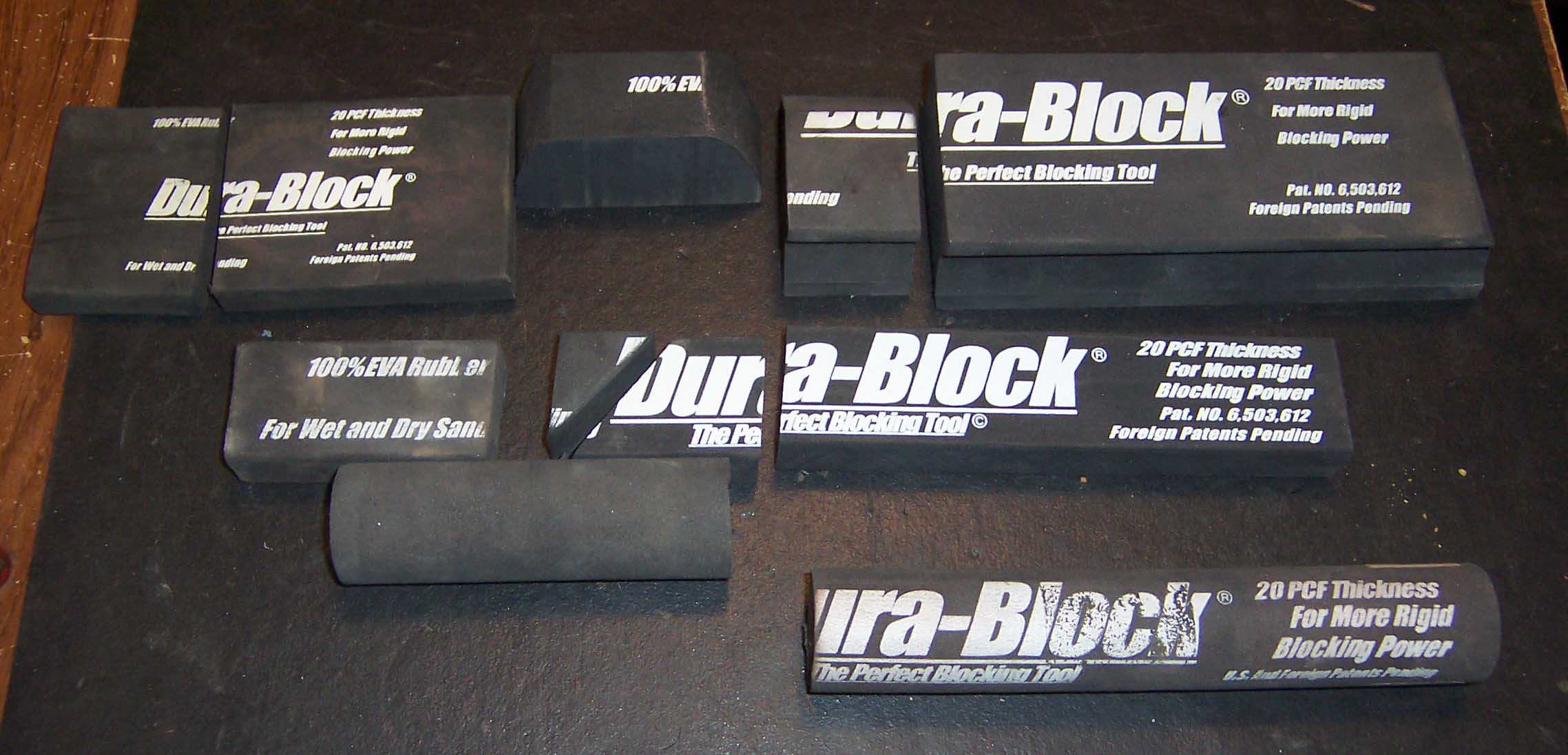

My usual method of finishing a rebuilt knife is to hand sand up through the grits to 2000. Then I switch to the micron paper Hukk mentioned and use 4000, 6000 & 8000 grit. Then I finish off with 12000 Grit Hobbico Micro-Mesh Sheet. See link: http://www.hobbylinc.com/htm/hca/hcahcar3479.htm
By the time I am ready for the loose buff using Jackson’s 51 it is pretty well polished. It works on metal, stag & bone.
I haven’t had much luck with the leather polishing belts. The felt belts work better for me. The leather belts stretched out too much and won’t stay on the sander.
I get the Satin Brite belts (1 X 42, from Jantz) as opposed to the Scotch Brite belts as they are a bit cheaper & work just as well. I use a lot of them & the older they get the finer they are, provided of course that you don’t get some metal imbedded in them.
When I am hand sanding, which is my preferred method, I use some rubber blocks that they use for backing sandpaper for hand sanding in auto body shops. They come in different shapes & sizes. They are called Dura-Block. http://www.autobodytoolmart.com/search/ ... agodsXNzPw
I think they are cheaper where I buy them. None the less, they are worth the expense, IMHO, as they last indefinately, unless your dog gets ahold of them. ::shrug::
They really help with the sanding. As you can see I have cut them to different sizes to get into unusually shaped places. I also have the cork butt to a broken fishing pole that I use for sanding inside curves.
