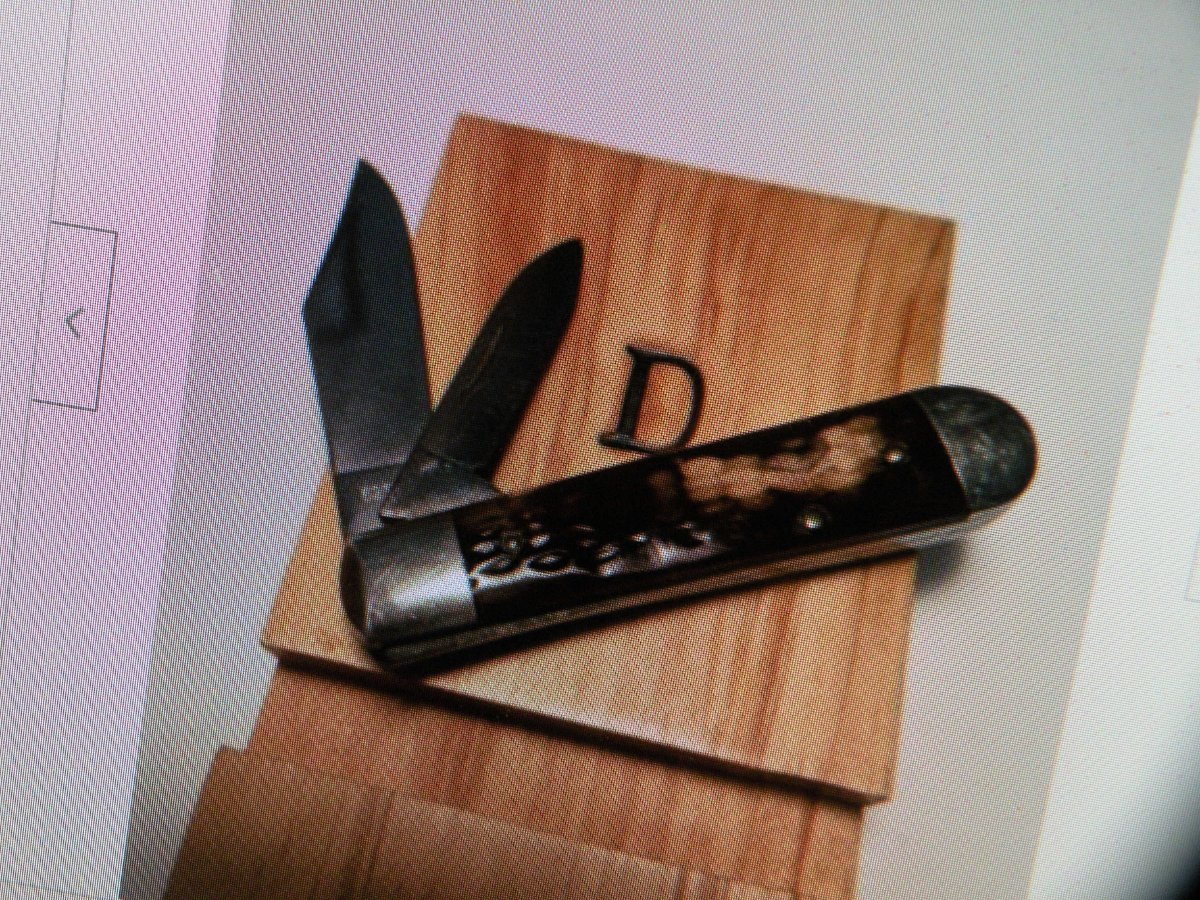

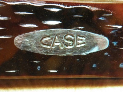

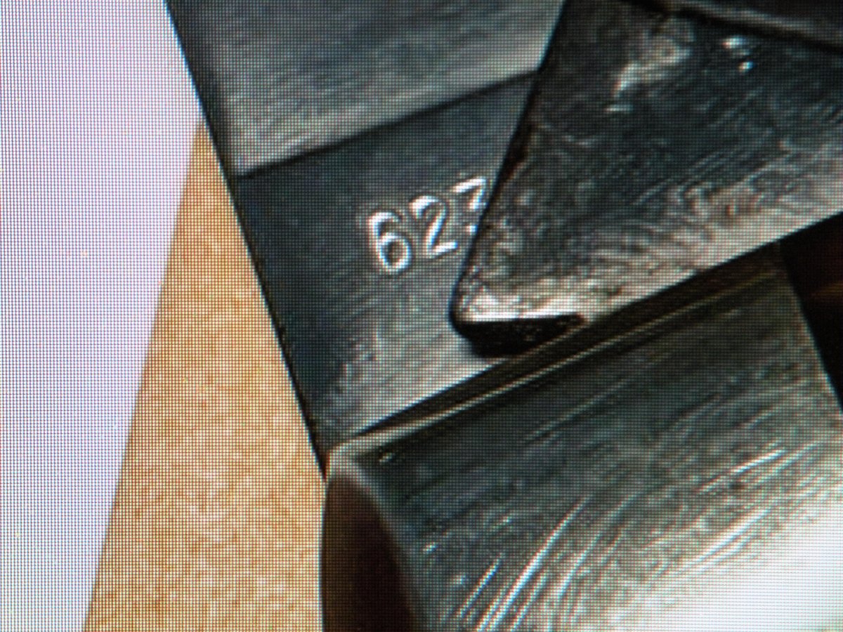

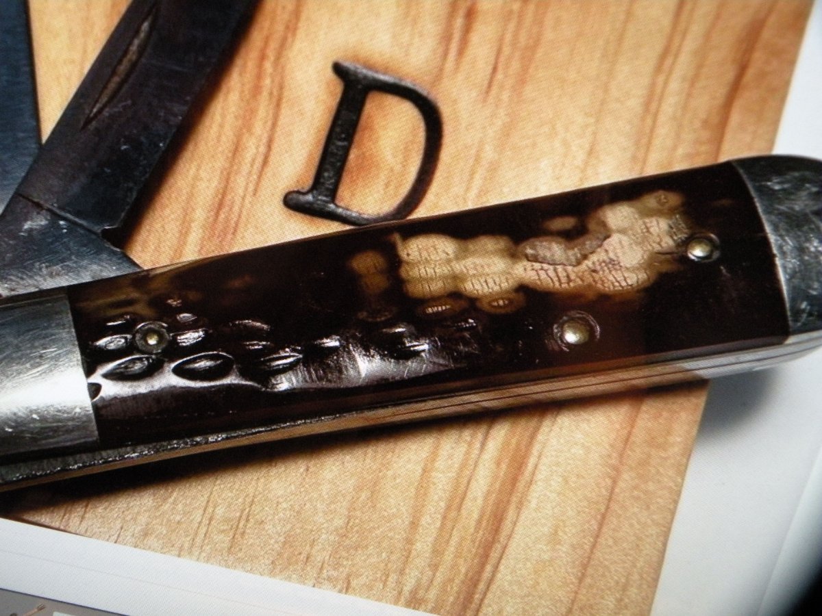

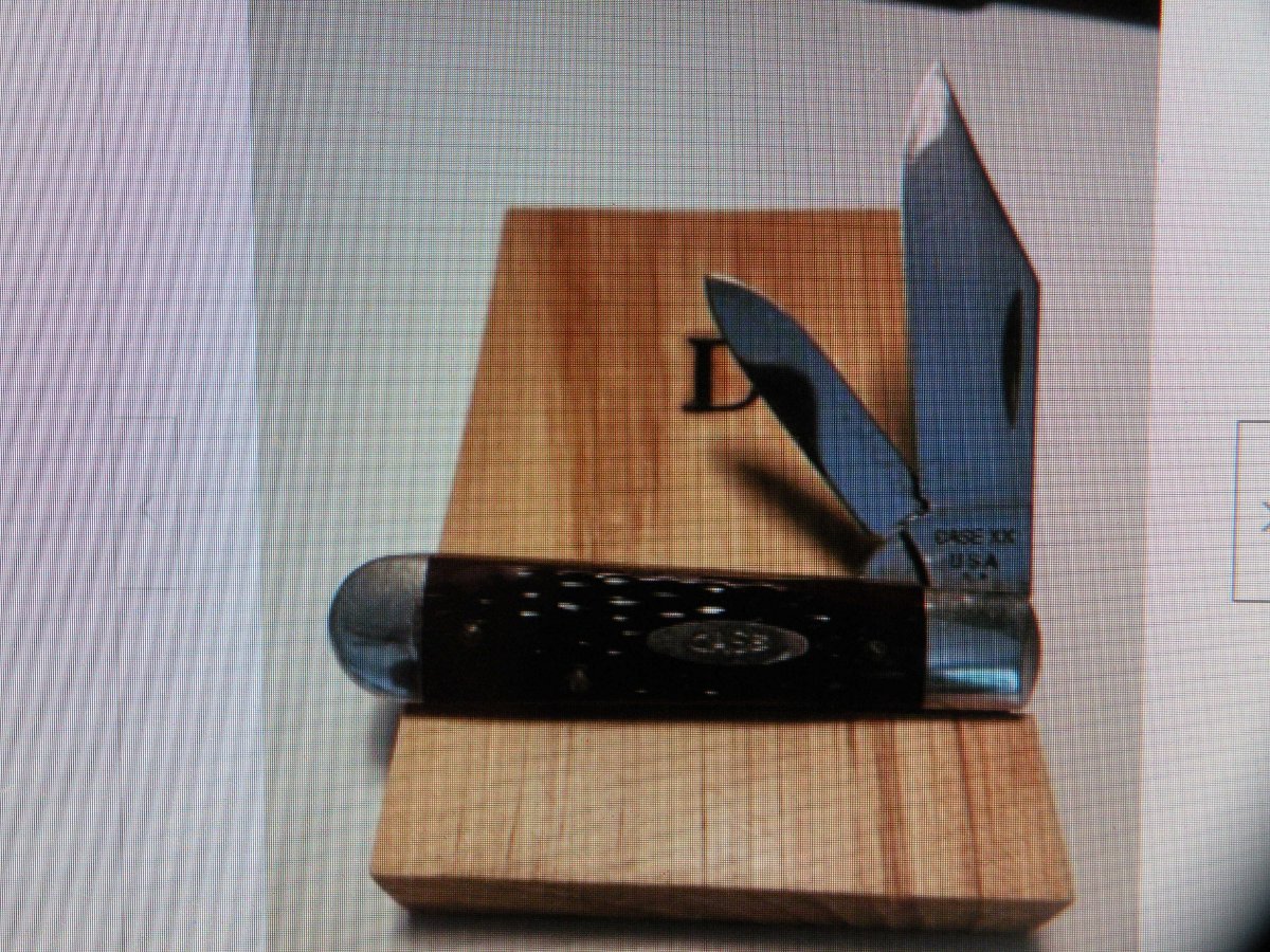

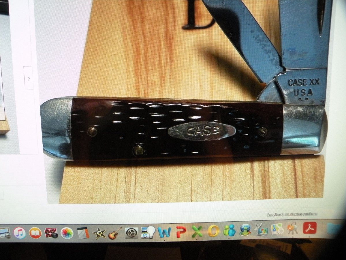

I'd like opinions on this one please. The shield is obviously the shield used by Case in the 70's on delrin and I think smooth composite handle knives (I don't remember exactly what range of years), and the mark side looks like delrin to me from the pictures, but the tang stamp is clearly 6235 1/2. The pile side looks like maybe delrin that has been burned or had contact with acid? I don't see any obvious signs in the pictures that the knife has been tinkered with or that the clip has been replaced with a clip from a 6235 1/2 (and I have no idea why anyone would want to do that anyway). Maybe a factory mistake? Any thoughts? ::teary_eyes::

Case used the number 6 to denote the use of delrin also. They used “6” on Pakkawood, Delrin, and bone. In about 1973 they also started using that shield on delrin knives. The shield with the circle around Case was used for bone and this shield for delrin still both with the number 6. I hope this helps. Knife is original.

Actually 6 is the correct designation for Delrin, don’t ask me why.

The knife is all authentic, just heat damage to the back handle.
"6" is the correct handle number for jigged brown Delrin - always has been.

My stupid/senior moment! I guess I didn't have enough coffee yet, and was thinking about yellow delrin. Anyway, the seller asserts multiple times that this is a red bone handled knife. I will let him/her know otherwise. Thanks!

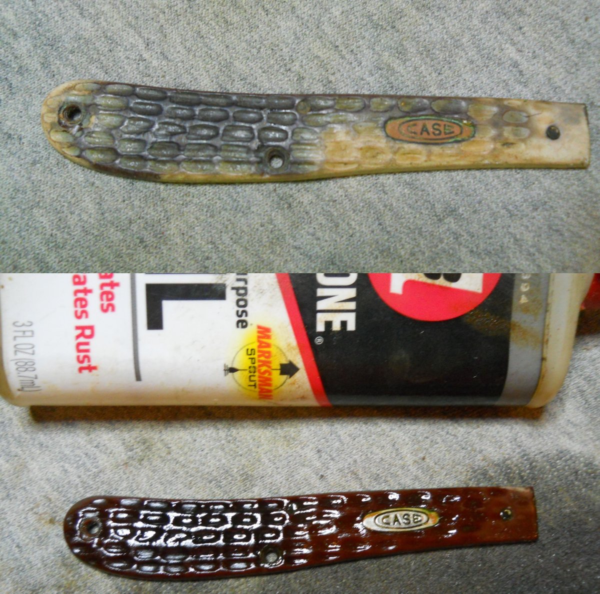

Has anyone else seen Delrin discolored like that? I think it is fairly common. You can rub that discolored area with 3 in 1 oil or something similar and the color will come right back. I'll try and dig something out and post pics.

This is only after a couple of hours. I'll add another picture tomorrow when it has set more. This is using only 3 in 1 oil.

That's amazing, thanks for the tip. ::handshake::

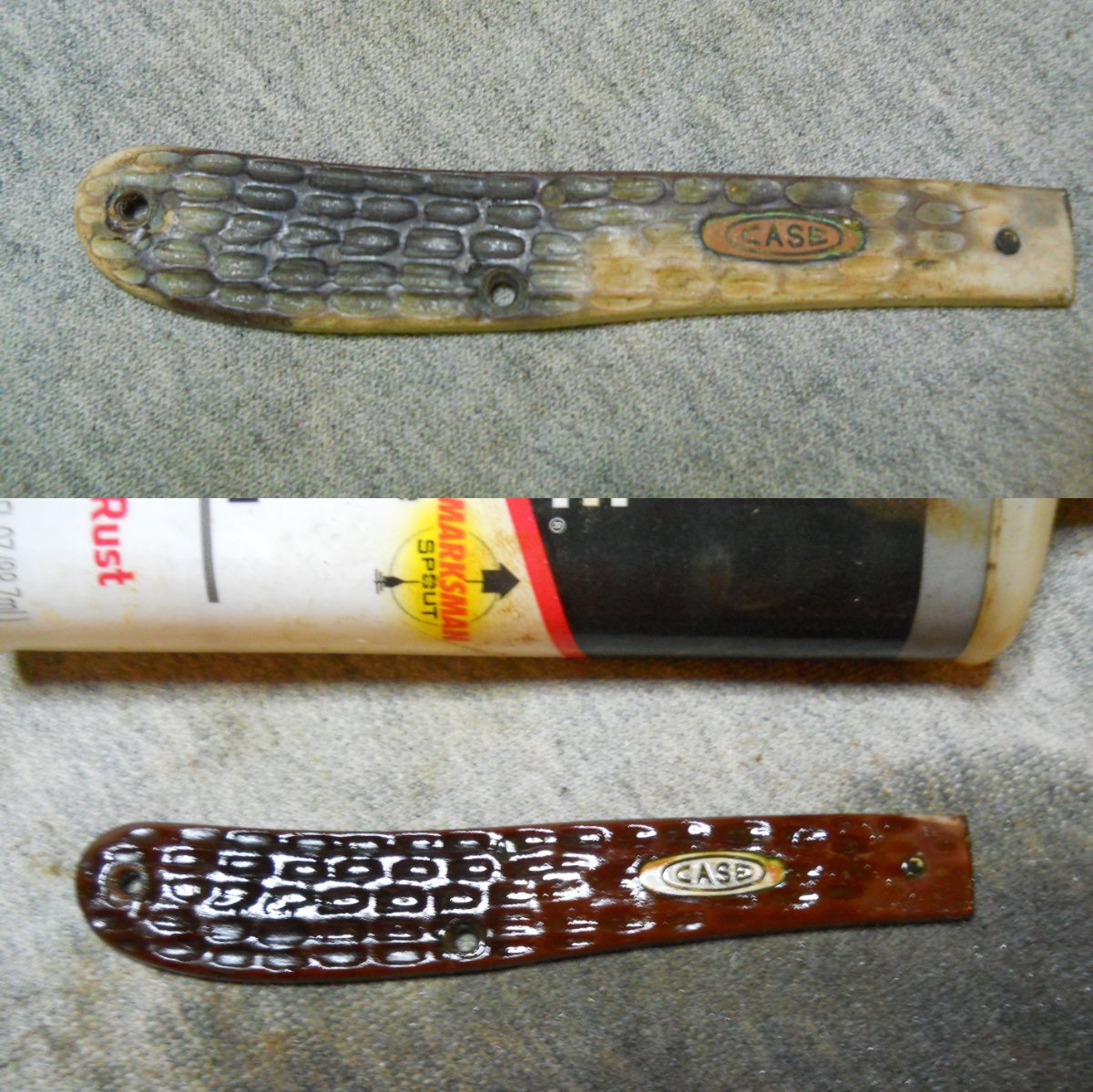

After overnight.
