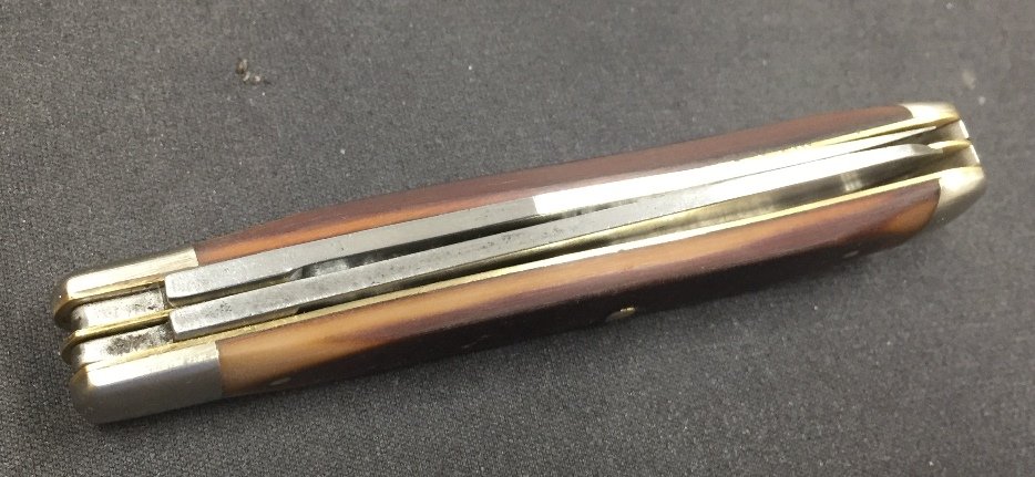

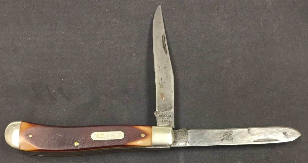

This 94OT trapper had the "wobbly blade swinden disease"....
It was filthy. He told me he had cleaned several deer with this knife. It showed it too.
Here is the before picture I took.....

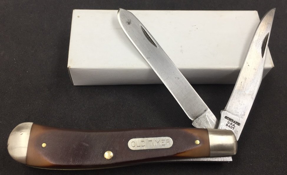

Here she is after a good clean-up, oil and that new pivot pin to tighten up the blades .....
I hesitated to really shine up the blades because I didn't want to make his knife look new...... just repaired and cleaned up. That was pretty much all he wanted.

Nice work Mike! I assume that you drilled out the swinden key and put in a conventional pivot pin. ::tu:: ::tu:: P.S.- I get nervous every time I take on work from other people who I don't know, which is why I don't do it very often. ::teary_eyes::
Herb
Meridian_Mike
Posts: 5041
Location: Mississippi
Re: I cleaned up an OT for somebody else for a change
Post by Meridian_Mike »
herbva wrote: Mon Oct 25, 2021 4:10 pm
Thanks Herb!
Yes, I drilled the bolsters and put in a nickel silver pivot pin in place of the swinden system. The swinden keys had stretched (I guess) and made it so the blades had a lot of sideways play. The new pivot pin fixed that.
I left the swinden keys at the opposite end bolsters. That end went back together nicely.
I had to put in a new rocker pin also.
Not such a bad job after all.... All I used to clean it up with was one of those scotch brite pads. The pad was about worn out but it did take the goo and tarnish off pretty well.
