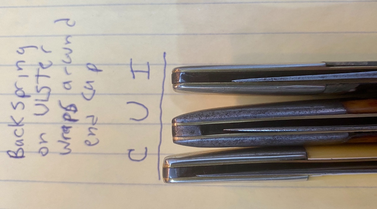

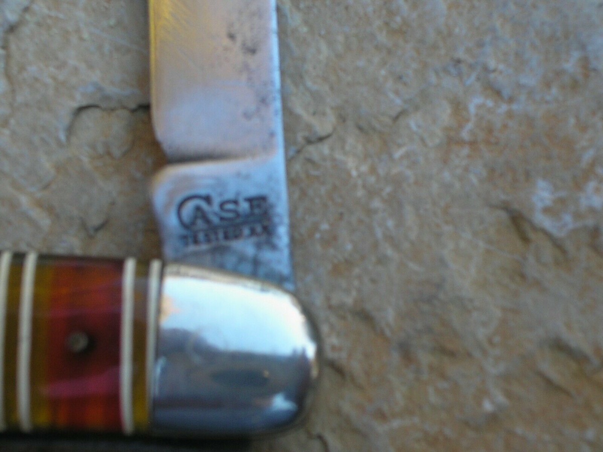

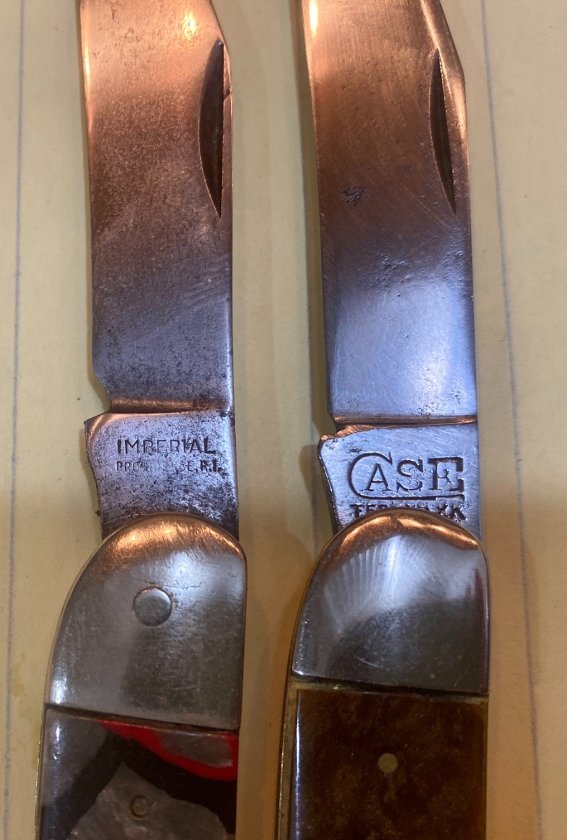

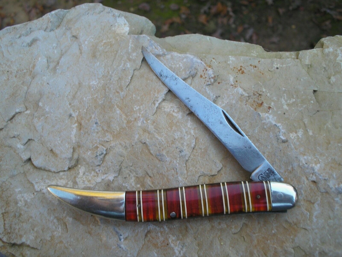

Better late than never, I guess, Because this Auction is ending in under three hours. But I have deep concerns about two toothpick/Ticklers Jazzy Gambling has up for auction: The first one is supposed to be a Tested era toothpick. Jazzy doesn't list a pattern number but pattern numbers are rare on Tested era Case pocket knives. The problems: No swedge (top grind) on blade,and Large angular choil. Both these are charicteristics of Imperial toothpicks with high pull type blade (See Photos). Next, the back springs don't "wrap around" the end-cap on Tested Era (or any era) toothpicks, Nor does it wrap around on Imperials of any era. But the backspring DOES "wrap around" (see pic) the end cap of (and I checked over 20 different manufacturers) the Ulster pre WWII Toothpick. (SEE PHOTOS). My conclusion: Imperial high-pull blade stuck in a Ulster Pre-WWII handle. The Tested stamp is blurry but I'm assuming it's fake.
I contacted Seller and I assume all sellers are innocent and just don't know they are selling a parts knife/counterfeit. Also, pictures do lie sometimes and I'll cheerfully apologize if I am incorrect, but It needs to be proven to me, not merely asserted.

Ulster back spring (center) wraps around end cap. Case (Left) and Imperial (right) don't
Imperial High pull blade (nail nick toward back of blade) lacks swedge (top grind). Plus Imperial toothpick blades have distinctive, deep angular choil. Cases are shallow and round.
(expand photo) Neither the 095 (yellow handle) or 093 (bone) profiles match the knife in question compare pin placements.
profile doesn't match that of the Case Tested era 093, or 095
Back spring doesn't look like Case or Imperial, But does match pre wwII Ulster Toothpick
Imperial Choil: large, angular
