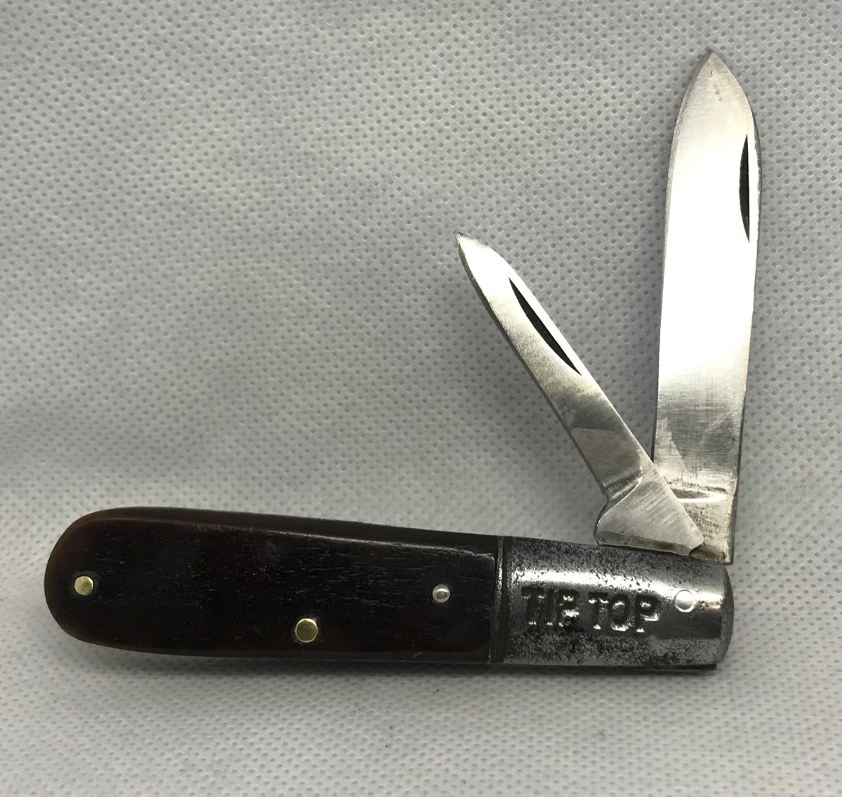

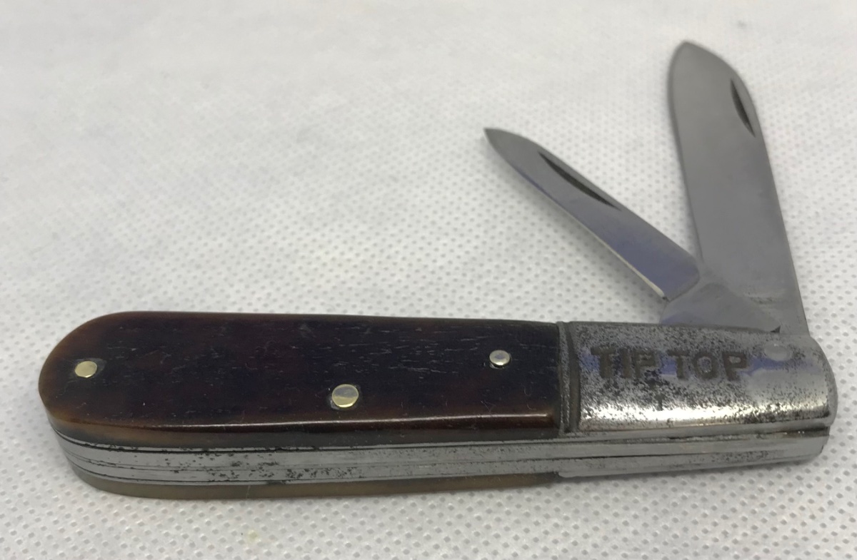

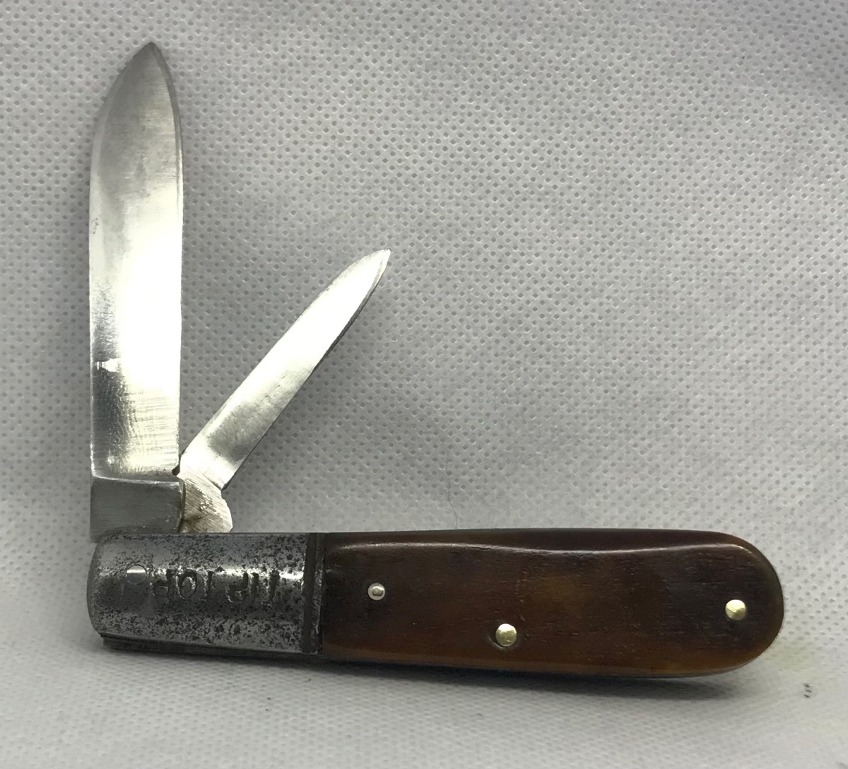

This Camillus Tip Top Barlow has been on my mind for a couple of years now. I cannot find my "before" pictures, but if I come across them later I will post them. Anyway, I paid $2 for this knife which had both blades broken out of it. The old pocket worn Rootbeer-colored bone was just too beautiful to pass up.
It is raining outside today, and my indoor pictures just cannot capture the shades of color in this bone!
There was originally no brass or nickel in it, only steel and bone. It was likely made during WWII or shortly afterward. I used steel for the pivot when I put it back together, but brass for the other pins. This one is for using, obviously not a museum piece. I tried to sand the pitted bolsters as little as possible, so my pin is a bit more visible than I wanted. It was a compromise to keep as much of the original character as I could.

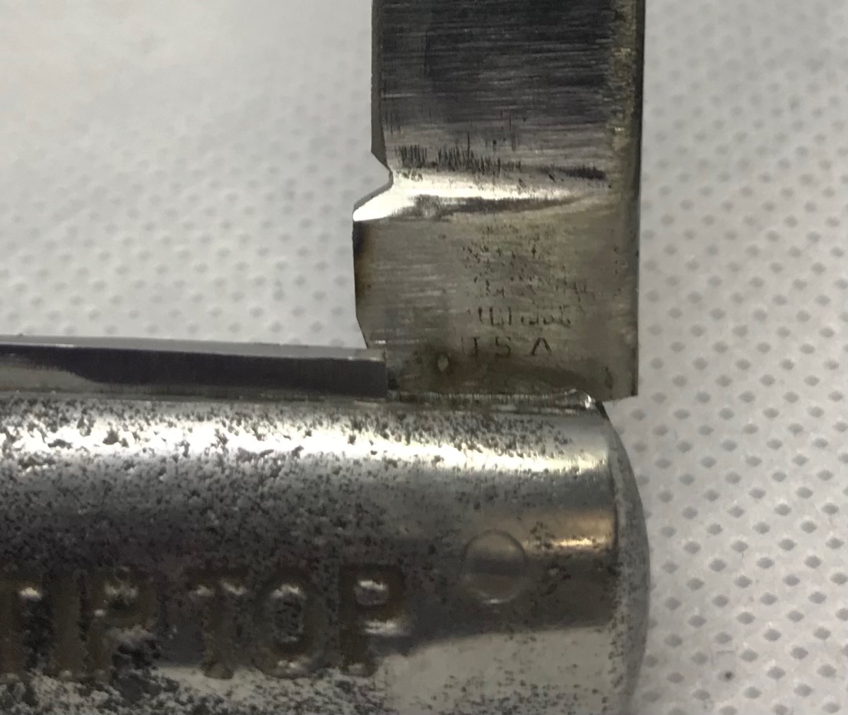

The Camillus 4-line knife for the donor blades was one I bought off of eBay. Someone had hand-molded replacement handles with brown epoxy (it looked like a turd!), then had cleaned all of the blades - with a dremel sanding drum. The tang stamp was almost gone (and is worse after I polished out their sanding marks!)
Aaarrgh!!!
As if that were not bad enough, the tang was also worn out. I used the method in my last post about the 8OT to restore the tang. Then I had to thin the pen blade tang, and thin the Main spring in order to get everything to fit properly.
It took a lot of sanding to make the blades acceptable again, but I am pleased with the outcome.
Another knife saved from the garbage can!

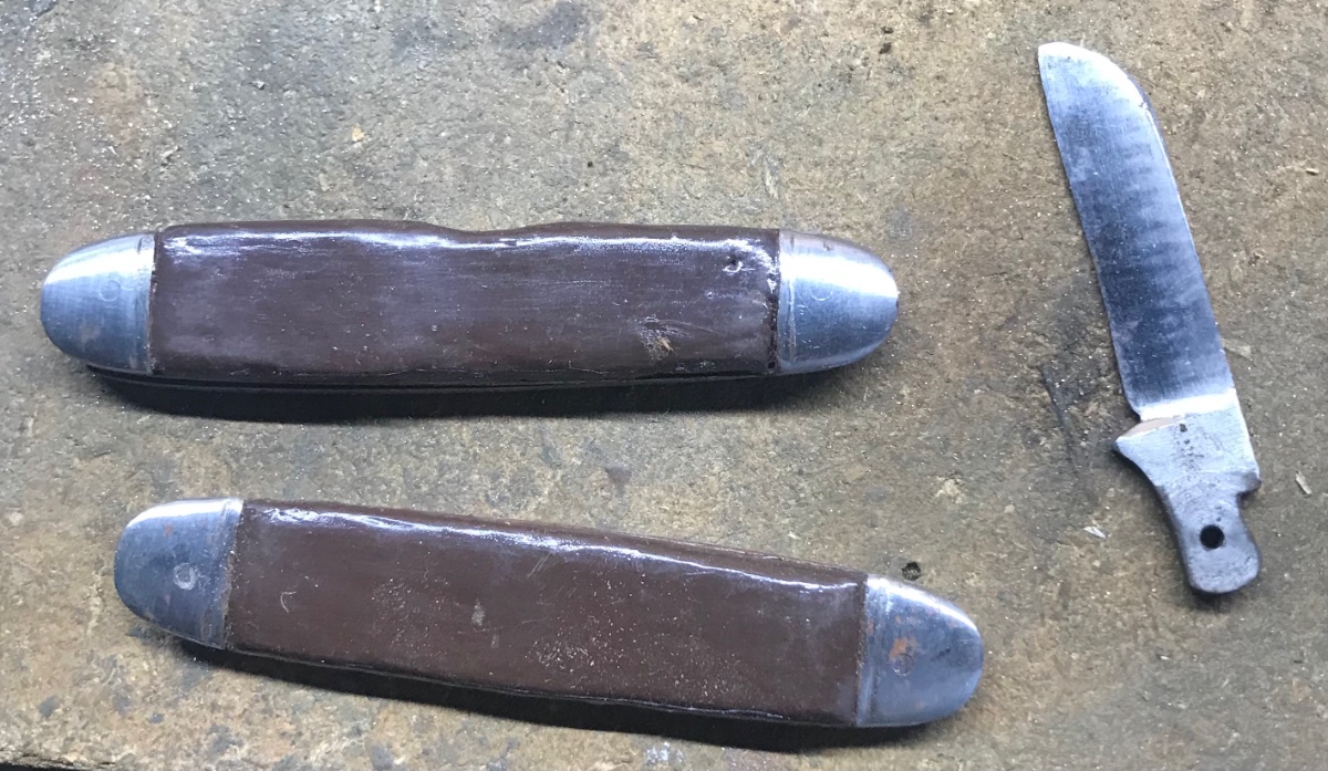

It is irrelevant now, but here is a picture of the handles and spare blade from the donor knife. I don't know of any way to remove that epoxy without destroying the liners, nor any way to make the handles look acceptable.
As a side note, I have been carrying and using the Tip Top almost daily for weeks now, and the tang repair has still held up fine. I believe it is about as permanent a repair as is possible.
