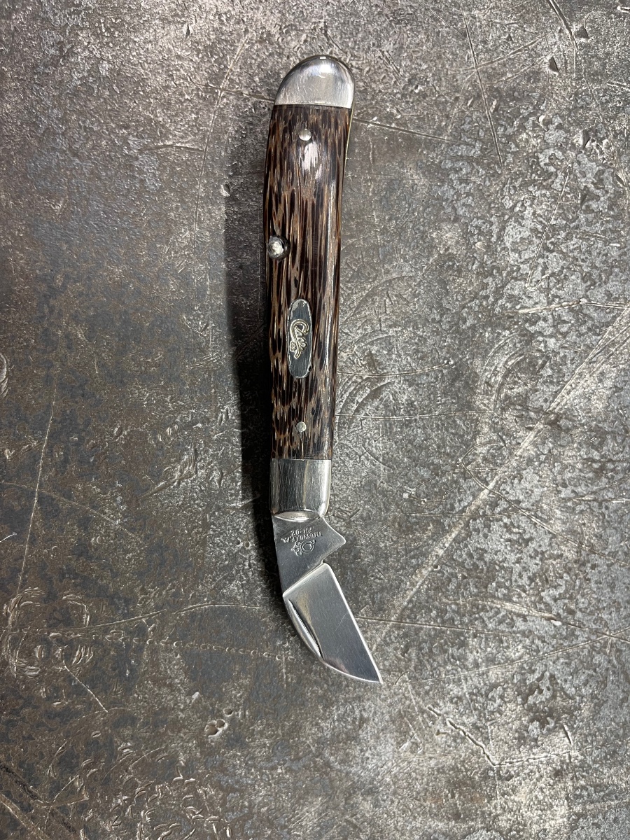

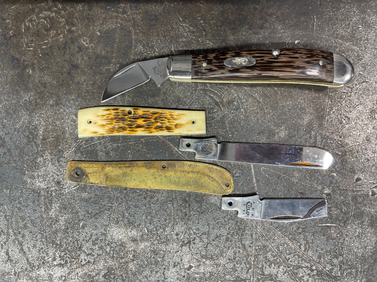

Post by C-WADE7 »
The oar is on a canoe frame or what appears to be a trapper style frame. I made one with a case mini trapper frame and chip carver blade. eBay has the chip blade and Warncliff, but it’s the big Warncliff not the smaller one that some of them had.
Case mini trapper and new palm wood covers.

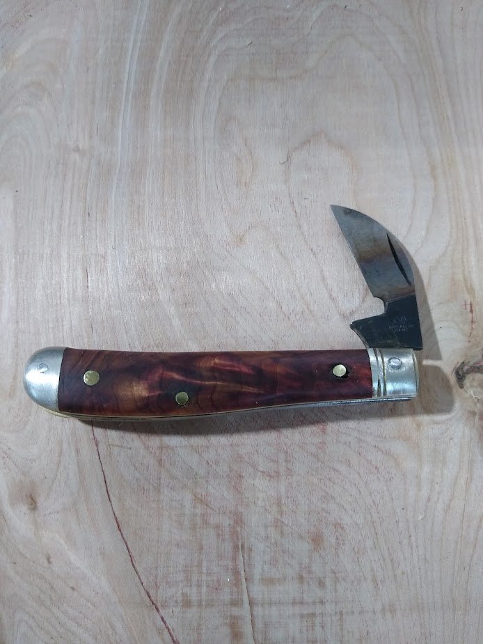

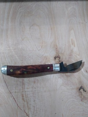

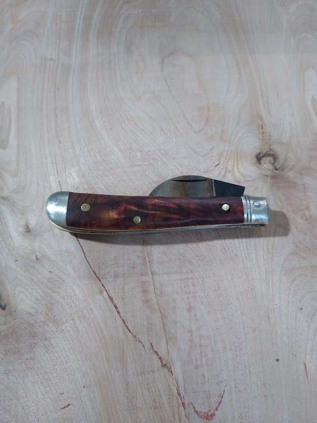

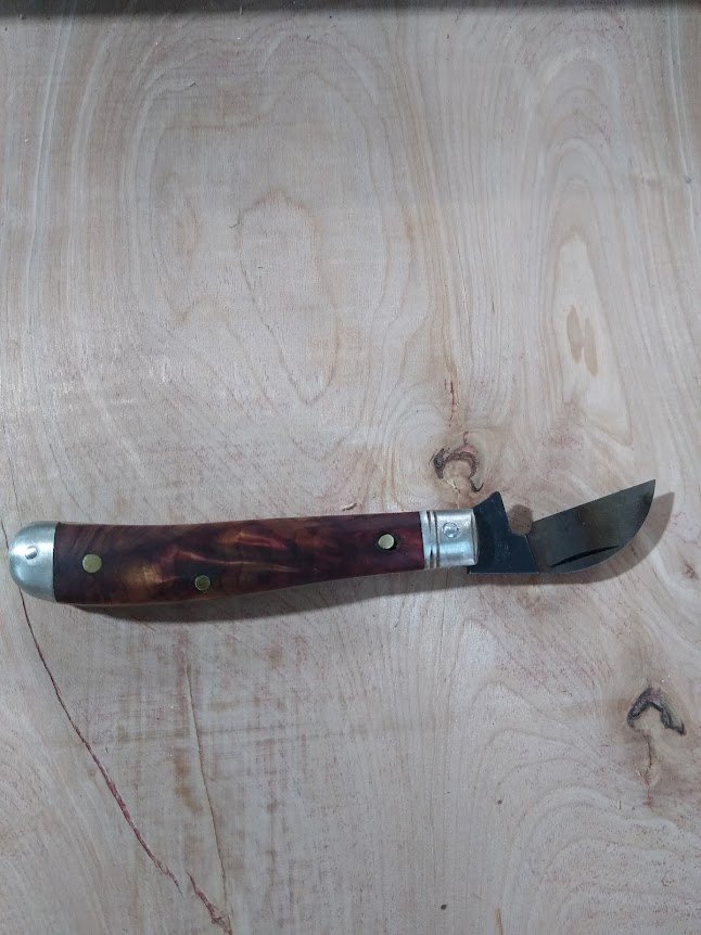

Absinthe
Posts: 34
Joined: Tue Feb 22, 2022 3:18 pm
Re: Resurrection from parts
Post by Absinthe »
So, I've kind of put my hand to this task. Unfortunately, after this one, I thought I had access to the same serpentine jack, but what I got was merely serpentine. The ones I have tried with those are coming out with very proud springs, and blade backs. So that is leaving me with some less than ideal results. I can thin the back of the spring, or I guess I could have shortened the tang somewhat. But, in the end, I will try my hand at making my own liner/bolsters and use these with some other blades that have a narrower tang.
I imagine that I could get a RR or Frost or other Chinese made knife, but I can't imagine cutting up a $60 Case XX knife for such a project :) But yours looks awesome. I am still learning and my peening skills leave a little to be desired at present. But I am getting there. I was told that my choice of cedar for scales was a poor choice. I am not convinced, but since I have to take it apart to clean up the crap job I did peening the scales on the inside of the liner, I will find out how bad a choice it was :)

Reverand
Posts: 4469
Location: Pisgah, AL
Post by Reverand »
The first knife that I ever rehandled was done in cedar, and it has held up fine. Cedar is a very soft wood, and most people assume that a much harder wood is needed for pocket knife handles.
The only downside that I can see in using the cedar is that the softer wood can deform more easily if dropped or misused, but I have had no problems.

C-WADE7
Posts: 1869
Post by C-WADE7 »
Looks good. The Case I used was in bad shape and found under the seat of a used car, so I had nothing to loose. The best part was the blade worked perfect in the mini trapper frame.
Absinthe
Posts: 34
Post by Absinthe »
Reverand wrote: Thu Mar 24, 2022 1:24 am The first knife that I ever rehandled was done in cedar, and it has held up fine. Cedar is a very soft wood, and most people assume that a much harder wood is needed for pocket knife handles.
This is some highly compressed grain cedar. It is about as dense as cedar can get. But I get it about soft woods. But we will see what happens when I try to take it apart :)
