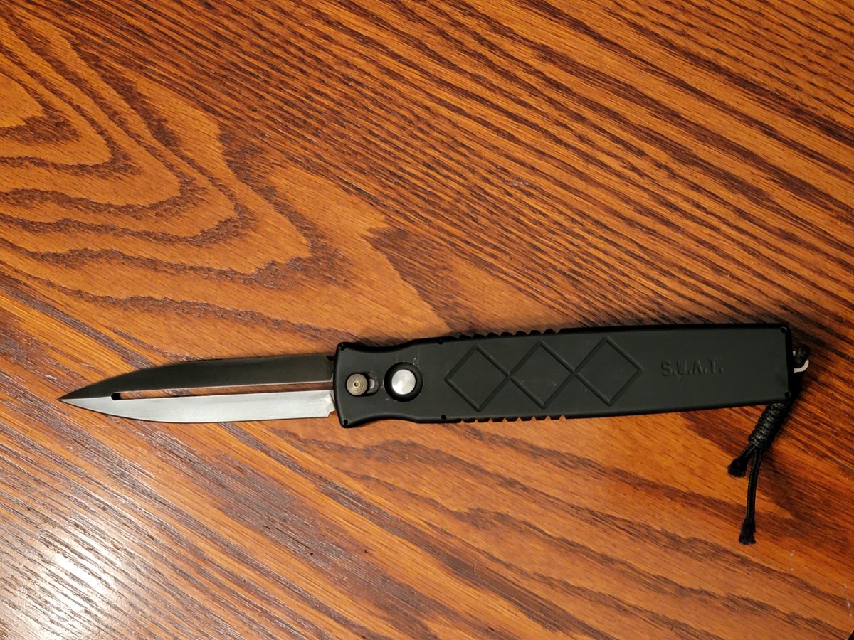

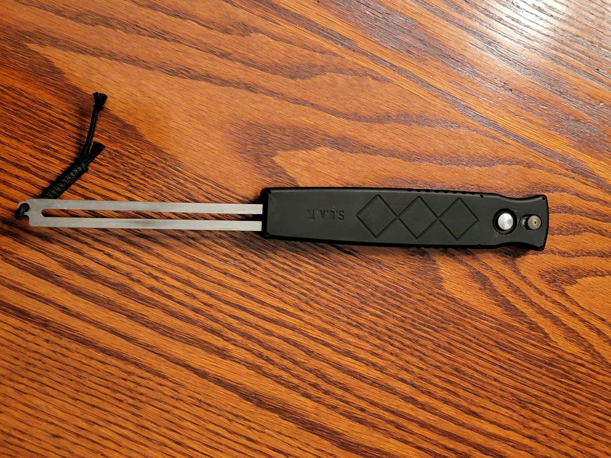

I can't find too much information out there on these, and nothing all about repairing them. It's a s.w.a.t. out the front auto. Pressing the button will not extend the blade. I can pull it out by hand, and the blade retracting mechanism seems to work. Could it just be a broken spring? Are these even worth repairing?

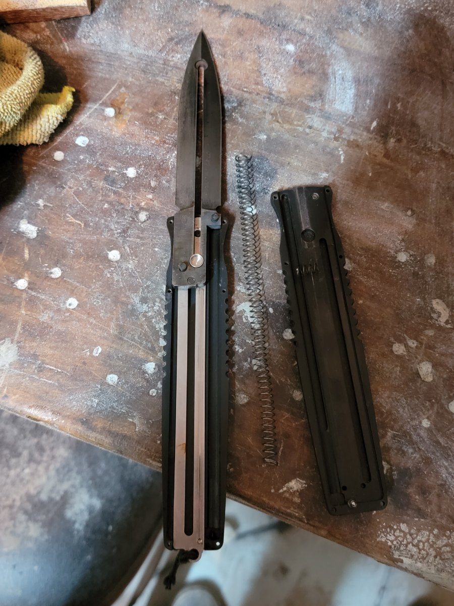

The long spring inside had shifted somehow, so that's why it wouldn't work. Seems fine now. I did launch the spring for the button across my garage when I took it apart , so that added 45 minutes to this job trying to find it. All is good now though.
