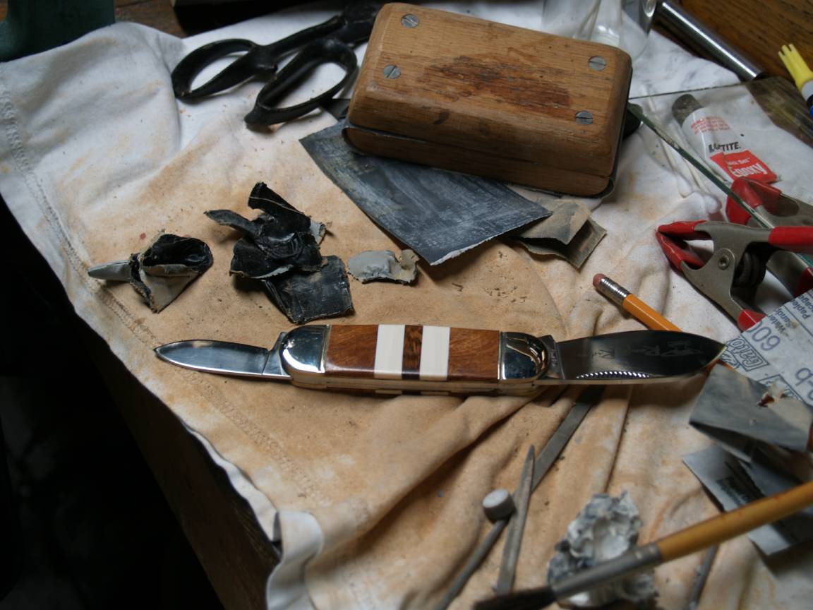

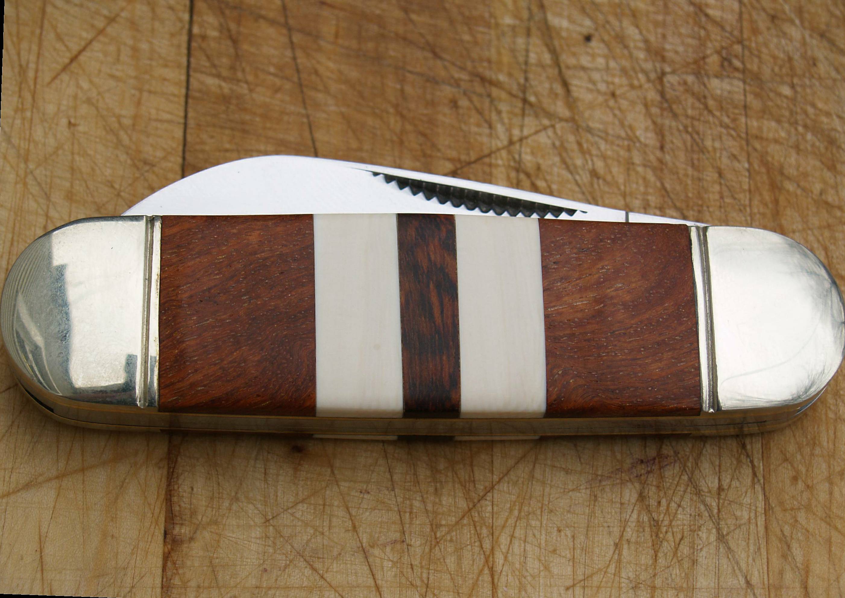

Since these rough riders are relatively inexpensive I decided to try to rehandle one. Used Amboyna burl, elephant ivory and snakewood. I'm kinda pleased about it since I've probably got the only one like it. It pushed my meager talents and almost crashed several times but all's well that ends. Took pics of the whole process and would post them but may be too much for the forum.

Used Loctite quick set 5 min epoxy to attach the scales.
There were no pins on the original scales.
Also used the Loctite to attach the pieces together before attaching the assembly to the frame. Pieced the different parts together on a glass pane coverred with wax paper to get a flat surface without sticking to the glass.

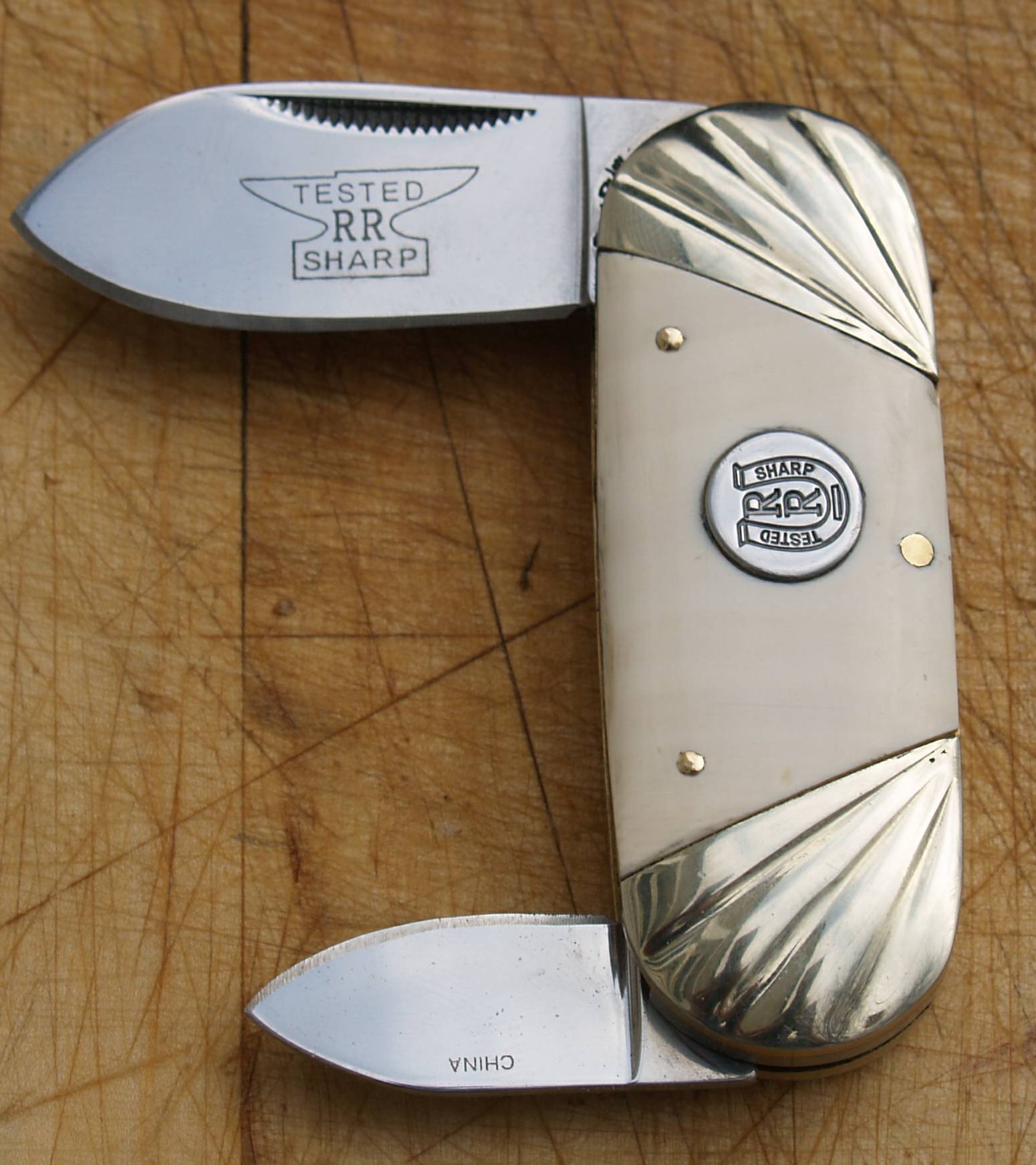

On the baby sunfish I essentially used the same epoxy but the pins were a much bigger problem. Temporarily attached 1 scale w/ small spot of super glue and transferr drilled through, then temp attached the other and again transfer drilled to get location precise. Pins are peened outside but not inside since I did not completely disassemble. Pins are epoxied in place but are not going anywhere.

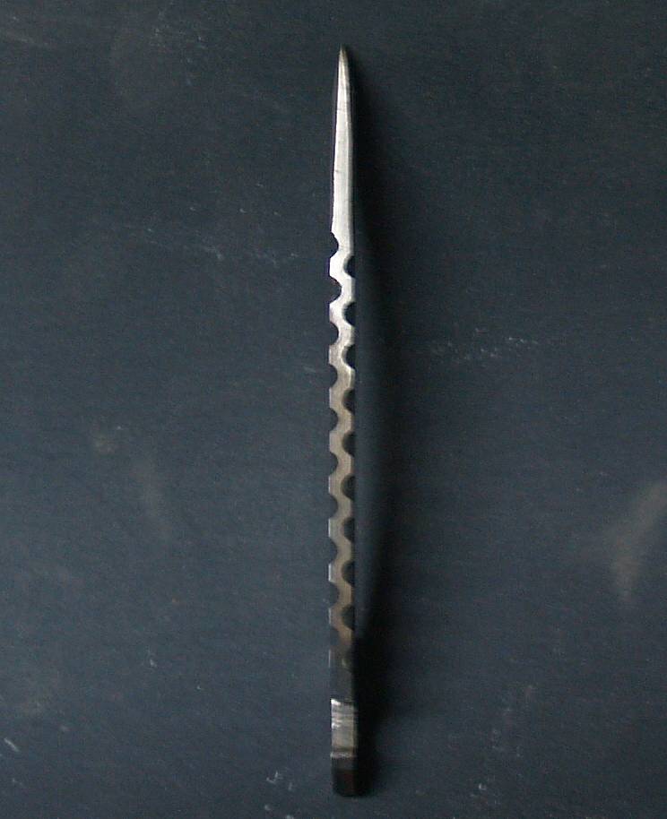

The quality of filework seems to be dependant on precision. Right now, I couldn't begin to be precise enough just by hand.
Trying to figure out how I can use an X_Y table on a drill press to grind a pattern. This would give me the precision I need as every step would be repeatable. This may be going the wrong way as far as handcraft goes but the result could be better than I personally can deliver for now. I would be amazed if I am the only one exploring or using this method. Going a step further, CNC machines would be ideal for this challenge even though I don't have access to one. Doing it "by hand" has its' appeal but superior end results are the goal. How do we judge quality or value????Just thinking about it. Anyone else have any thoughts??

Just tried some filing and found that the D2 blade I was working on is so hard the file just slides over it. A dremel tool with a grinding wheel cuts it fine but the grind marks are crude and no file I have will dress them up. I did use the X_Y table to mark the spacing for the cuts but the drill runs too slow(3k rpm) to do the work.
