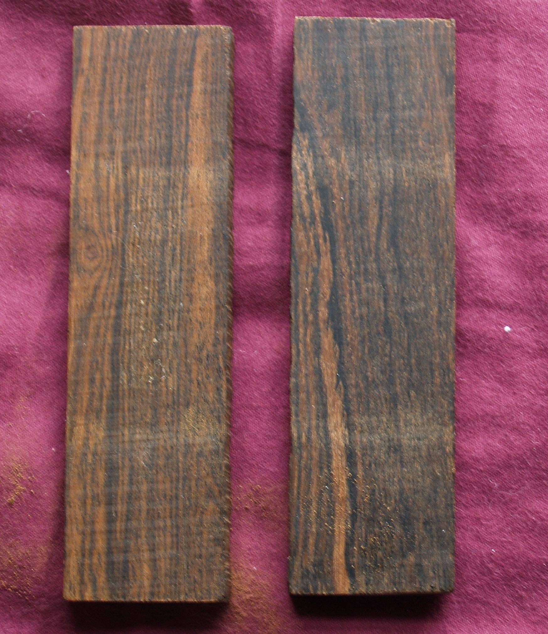

Just picked up some mexican cordia wood which looks like a good candidate for a rehandle project. Has anyone out there used this beautiful wood? It doesn't seem really dense as Ironwood or Ebony but the grain is beautiful.

looks alot like mexican bocote, maybe a different name for it. I have used the bocote and find it fairly easy to work but in return it is fairly tough and durable as well. It polishes down really nice.

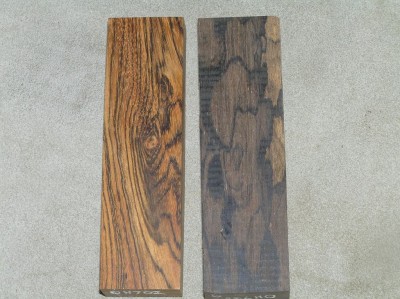

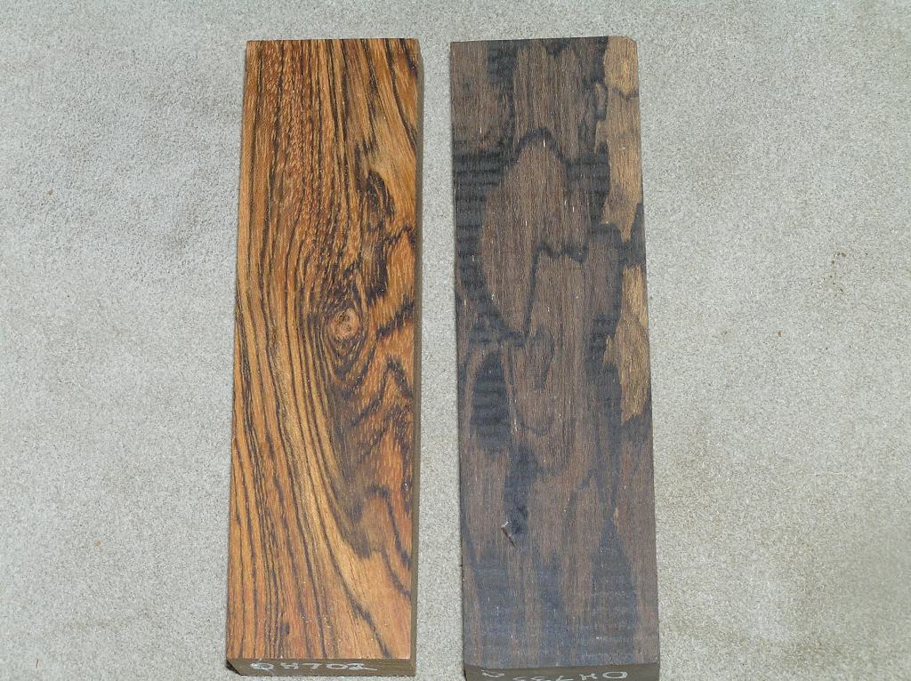

Here is a picture of Bocote (an oily wood) next to Ziricote (also called landscape wood).
Some Botanical names for Bocote are Cordia elaegnoides, Cordia gerascanthus as more than 1 species is sold as Bocote.
Some commmon names for Bocote are Canaletta, Cordia, Cype, Freijo, Louro, Princewood, Solera, Salmwood, and very wrongly Ziricote.
Some more common names from another website are Anacahuite, Bocote, Bois de rose, Canalete, Cordia-Light American, Cupane, Ecuador laurel, Laurel, Laurel de costa, Laurel negro, Peterebi, Salmwood, and Siricote.
I enjoyed the searches, I do like wood.
I like to buy boards that are at least 2 inches thick, 3 and for inches thick if possible so I can custom cut the wood the way I like it.

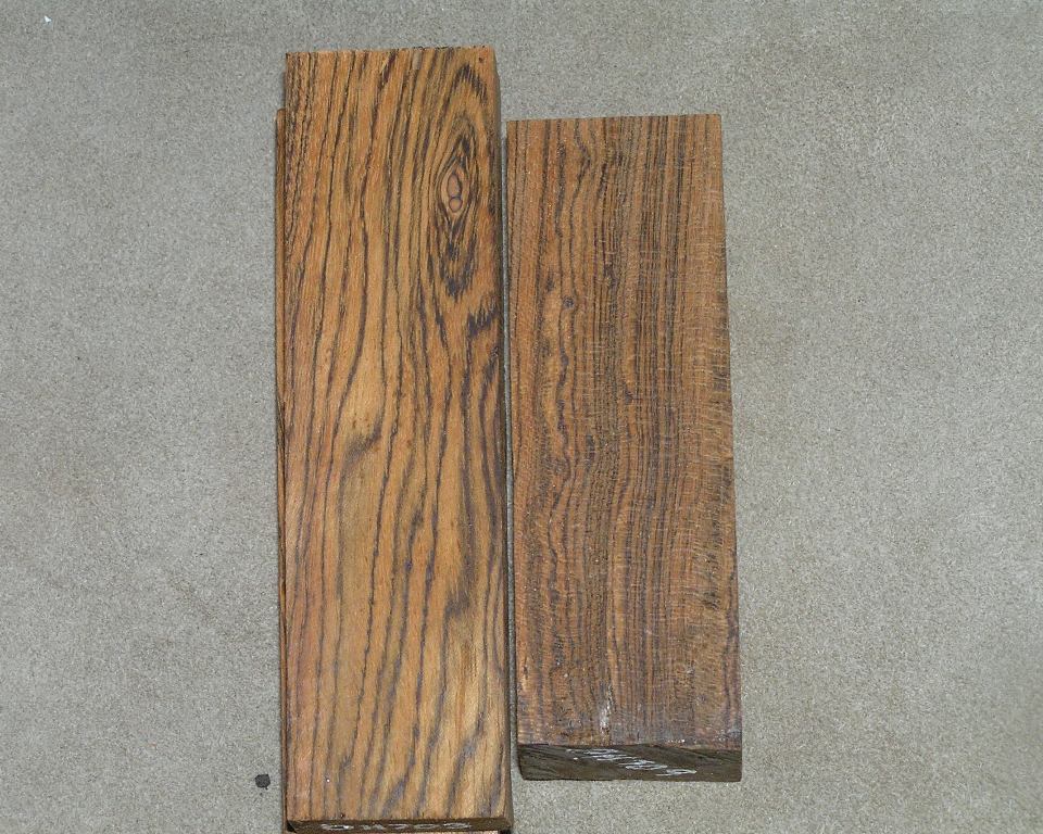

The second picture is pieces of a 3 inch thick Bocote board I cut up. I cut it up for some tight grained pieces and some for a looser grain. If you just cut it up you can't help but to get different pieces. Be nice to have a log so that I could quarter saw for the tight grain (sides will have a loose grain).

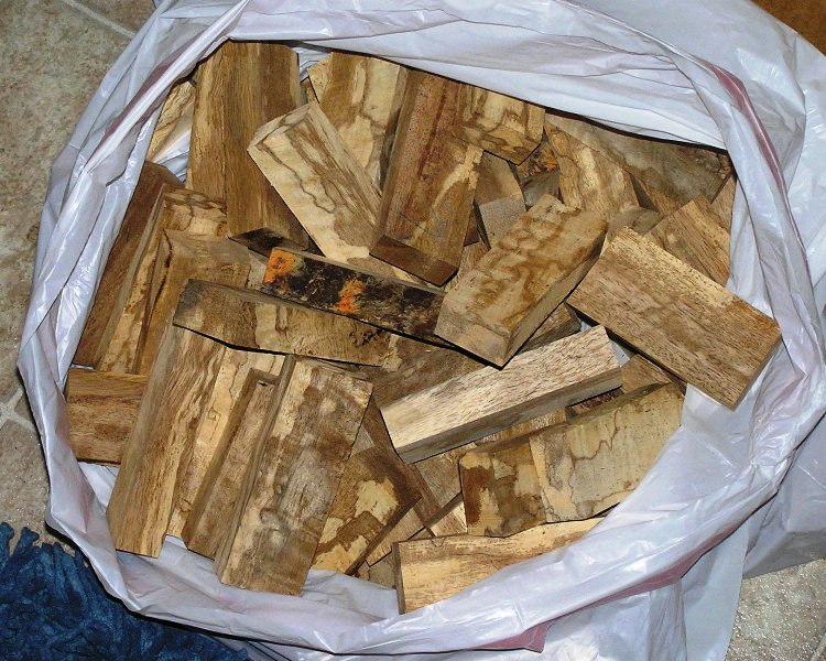

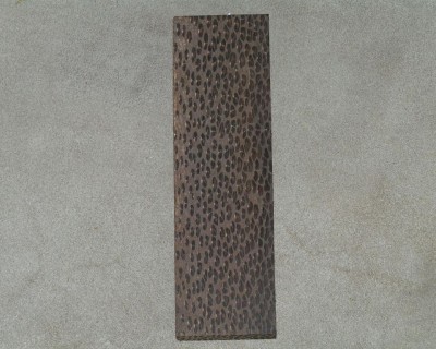

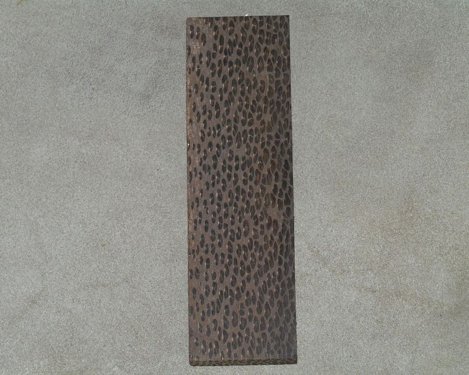

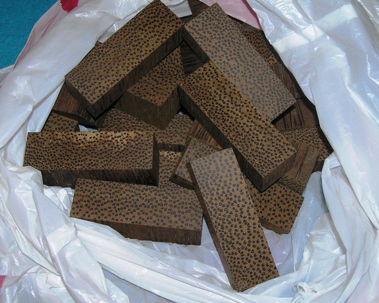

The last pictures are of Black Palm and Spalted Mango that are being stabilized at WSSI and K&G and shold be back and ready to sell in 10 days I think.
