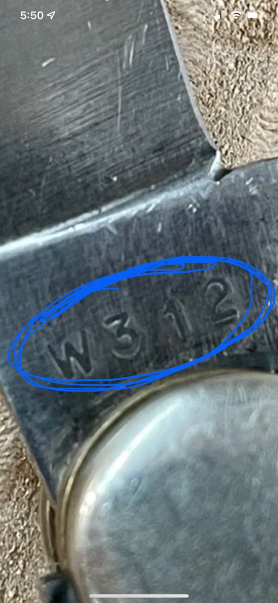

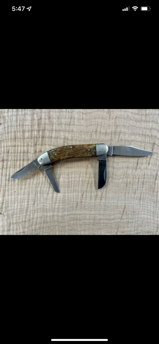

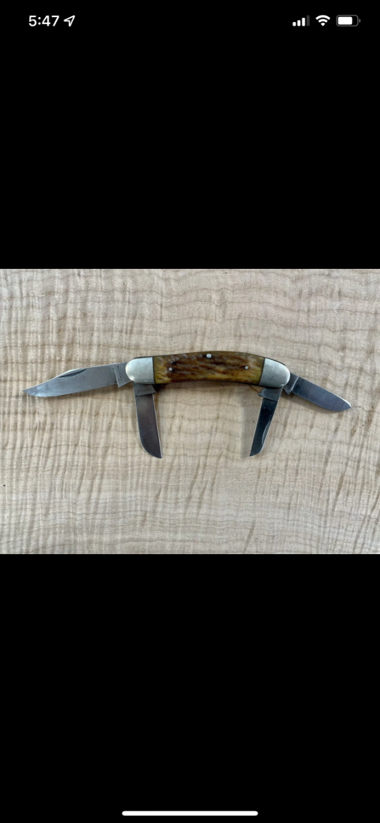

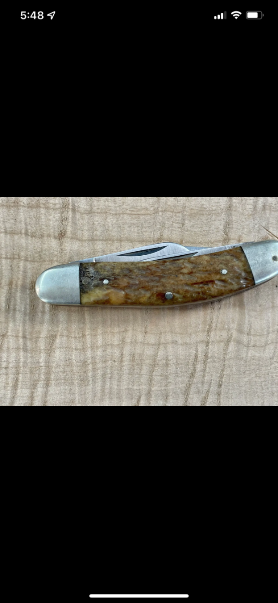

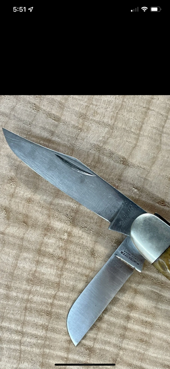

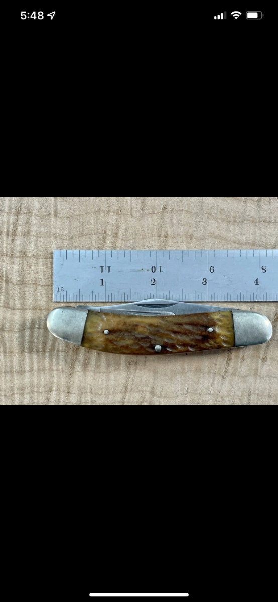

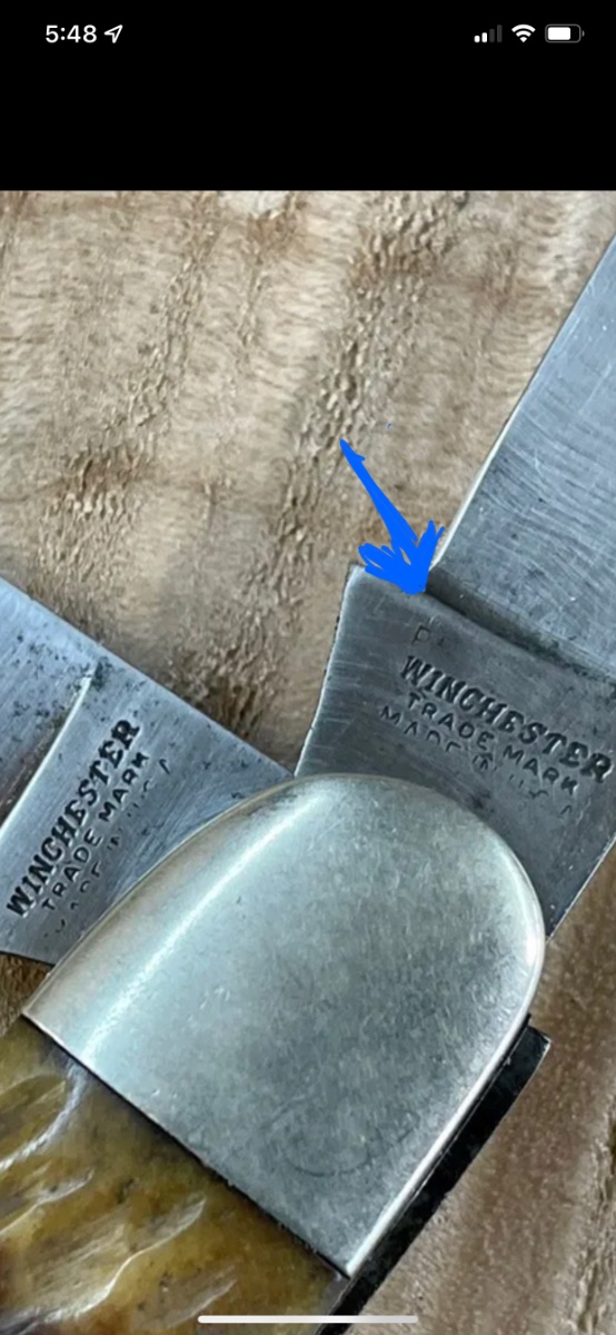

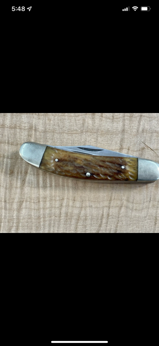

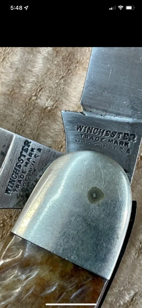

I need help if anyone can help me confirm if this is a fake or legit? There is a spot on one of the tangs has what looks as a letter above Winchester on one of the tangs. The blades if they are sharpened a lot or not if someone may happen to know. I know some of the Winchester knives I’ve seen have more of a kick on the blades and appear be used. The main is only one looks used to me but could be wrong please help and hope to hear the thoughts.

I could not find a "sow belly" pattern in either of my original Winchester catalogs. That doesn't mean they didn't make one. However, your knife resembles one of the fake Remington "sow belly" knives (especially if you think the blades are stainless steel).

The pattern number is cold stamped in with individual letter/number punches indicating knife is a fake or at least a heavily messed with knife.

Gunsil wrote: Mon Nov 14, 2022 12:58 am The pattern number is cold stamped in with individual letter/number punches indicating knife is a fake or at least a heavily messed with knife.

The grind line is also upswept near the back of the tang on all of the blades. That is often a sign that the tang has been ground down (to remove an original tang stamp), and restamped.
It isn't proof, but added with the other evidence it makes me think that it might be a counterfeit.

I don't think the pattern number is a Winchester number. All of the ones I see are just 4 digit numbers.

::hmm:: The one pivot pin looks suspicious . . .

The op knife is counterfeit.
