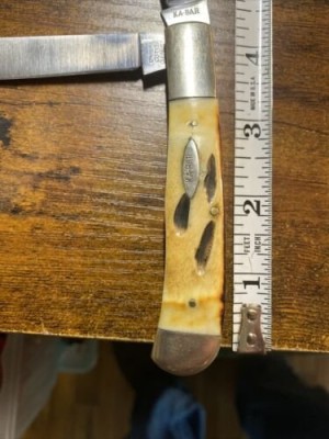

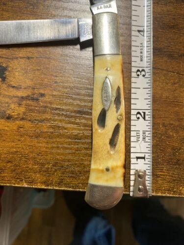

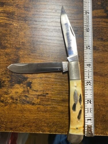

Kabar Trapper
I'm posting this one because I am not really sure and want to find out if it is legit. The thing that concerns me the most is the handles. I have never seen scales like this before on a Kabar, but I most definitely could be wrong. The Olean stamp looks funky also, but I would like to hear others opinions. Always willing to learn more!!
The seller states the knife has never been used, but the blade looks like it was sharpened at one point.
https://www.ebay.com/itm/255810513133?h ... R6K_26afYQ

Looks VERY Counterfeit. Yuk.

Re: Kabar Trapper
JO, I hope more than the scales bother you. The blade have no top grinds (swedges to some), and the nail nick location and size is atrocious. Handles certainly are ugly!!

Re: Kabar Trapper
I am no expert on Kabar tang stamps and blade profiles, but here are the few things that glare out to me:
1) Those ugly gouged and torched bone handles are straight from Pakistan. I found a couple of similar examples online. I don't think that any other group of manufacturers ever made anything so ugly. These pictures are not an exact match, but they are similar enough. 2) the tang stamps looked cold stamped. The steel is slightly "mounded up" around the letters, rather than being crisply stamped into the steel.
3) the upswept grind line on the choil shows that the tang has been ground down prior to being cold stamped.
I have drawn a line on this one to show what I mean:
I am sure that there is more, but in my limited experience I would look no further than those handles! Egregious example of bad counterfeiting!
