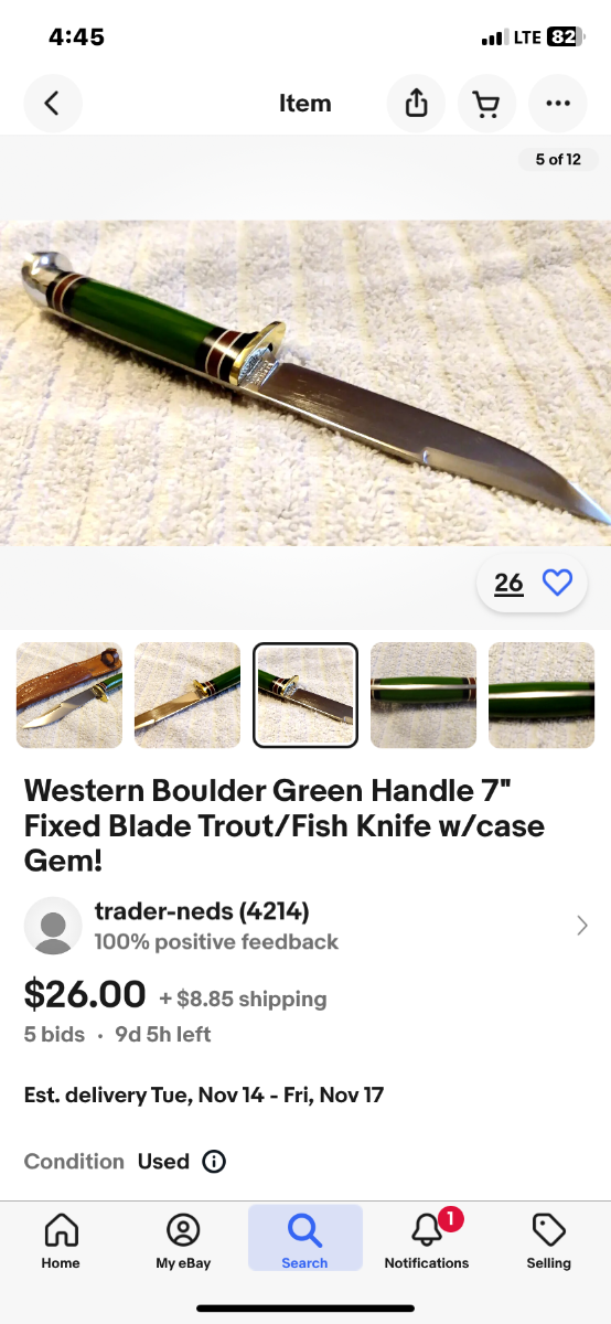

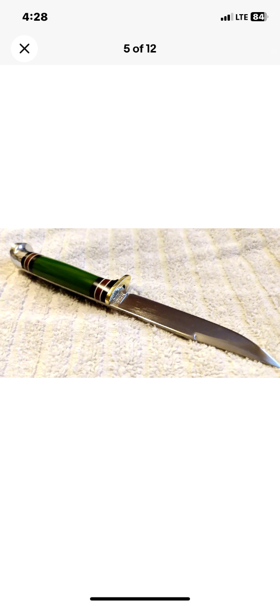

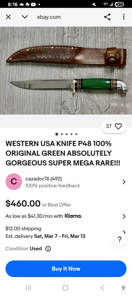

Would this be a good example of a western fixed blade that is a fake?
- 1967redrider
- Posts: 21480
- Location: Alexandria, VA
Re: Western Color - What's factory and what's not?
Near mint!!!
I can't believe some defend this liar.

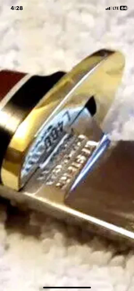

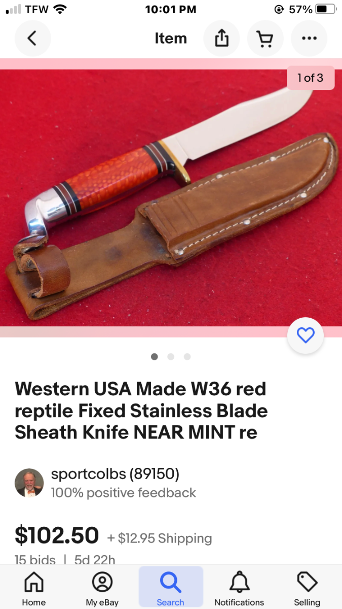

Here is a nice example of a fake with model # stamped on the guard .zzyzzogeton wrote: ↑Fri Dec 16, 2022 6:49 am When a Western knife has a colored handle and has ANY model number stamped on it other than P28, P48A or P48B,

- 1967redrider
- Posts: 21480

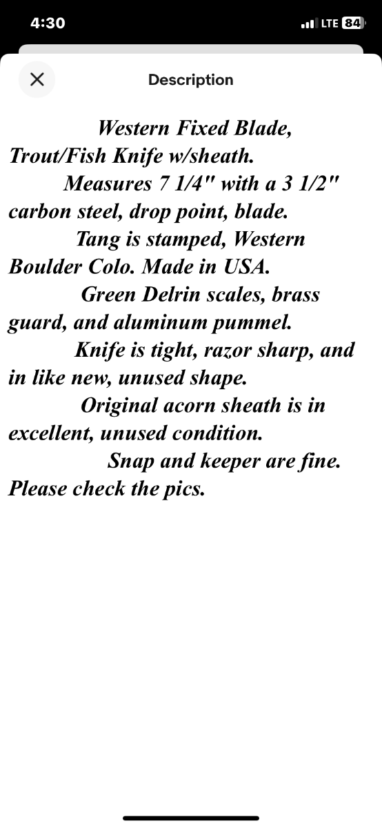

This guy has a few to unload. What's the consensus?
- OLDE CUTLER
- Posts: 5667
- Location: South Dakota
But it's super mega rare. Nothing else needs be said.

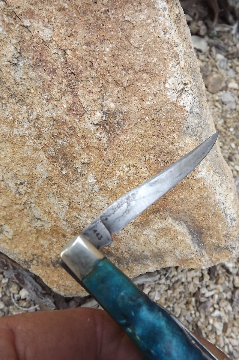

I believe that my 443 is super mega rare.
I am open to accepting offers*
*Low-Ball offers will only be scoffed at
