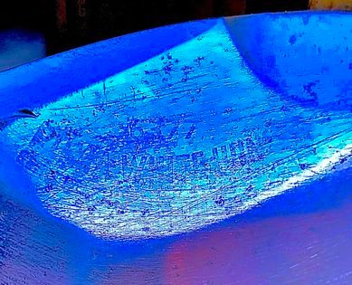

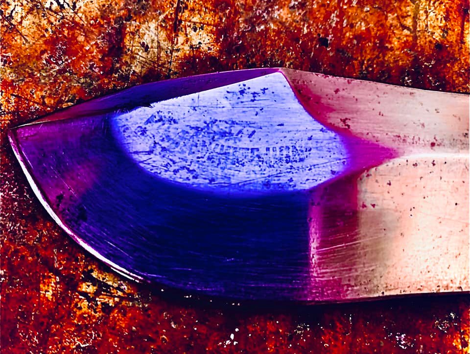

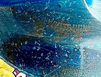

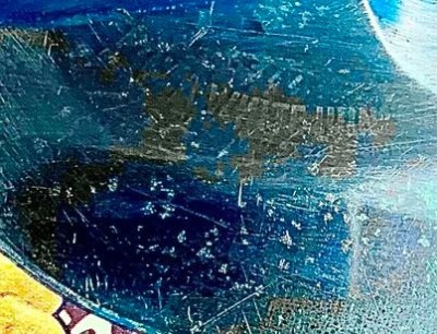

Yup they made both, think the Chrome plating is true also.btrwtr wrote: ↑Sat Dec 17, 2022 1:45 pm I never knew that White Hunters had chrome plating. I believe the knife transitioned from carbon steel to stainless at some point early on in production. Is your knife carbon or stainless steel? Does your knife have the date code on the guard? Can you post a picture of the knife to show the etching?
The one I have is the last year of Acid Etching the Logo onto the blade before they started stamping during the forging process.
I have a couple of photos here which I had to mess witht settings to enhance the logo as it is very faint, heance my question about methods to revive the etching.
Haave a look at these mate.
Cheers
JT
You do not have a soul, you are a soul, what you have is a body
- btrwtr
- Posts: 5484
Re: Hoe to revive Acid Etching ??
If the depth of the etch is equal to the light pitting and scratches on the blade I don't know of anything that you could do. Sanding on a very flat surface and/or re-etching carbon steel with ferric chloride can help in some cases but I don't think that would work here.
