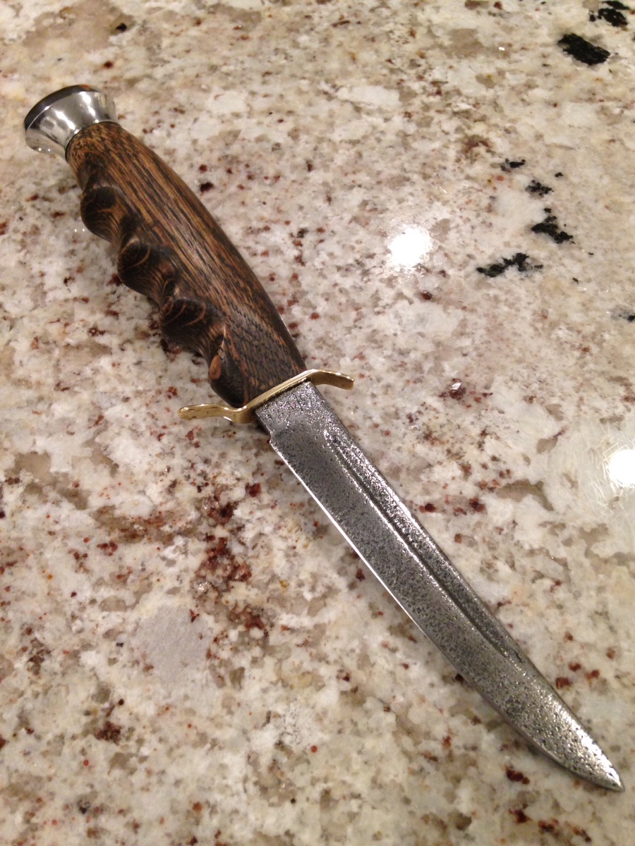

To me it depends on the knife. I redid an old fixed blade that a friend of mine had found buried in a mound of dirt when he was younger. I soaked it for 3 days in vinegar to get it derusted and rehandled it with a piece of grainy oak. Knife has alot of pits so I finished to 400 and buffed it so to leave the handle more natural with pores to match the rest.

I like that knife, Jimbo. Leaving the handle a bit less smooth was a good choice, given the pitting. Your way of thinking makes a lot of sense, and gives me something to think about on a couple of my projects.Oledadsknives wrote: ↑Fri Dec 23, 2022 2:52 am To me it depends on the knife. I redid an old fixed blade that a friend of mine had found buried in a mound of dirt when he was younger. I soaked it for 3 days in vinegar to get it derusted and rehandled it with a piece of grainy oak. Knife has alot of pits so I finished to 400 and buffed it so to leave the handle more natural with pores to match the rest. ABF71D71-3D67-4E5E-B21A-CE99F3E3A004.jpeg

Thanks reverand, I tried to do it to suit the overall appearance of the piece when finished. It turned out better than I thought it could. Stay warm reverand!
