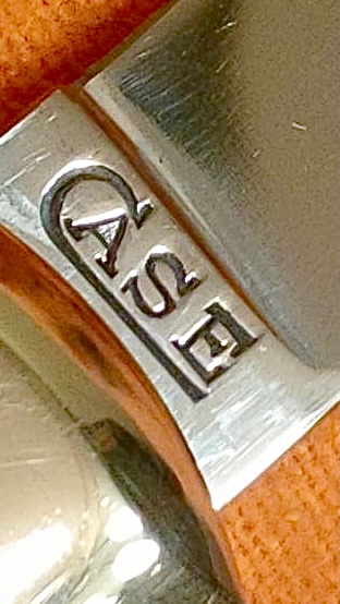

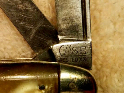

Here’s another counterfeit Case. Looks like new because it is. https://www.ebay.com/itm/304754537951?h ... R7L0tdesYQ
Seller doesn’t give much information. Not sure what it was to begin with but it’s been altered. Original stamps removed and cold stamped “Case Tested XX”. Not Case bone or jigging.
Been up for auction less than a day and already has 10 bids. ::dang::

I know absolutely nothing, zip, zero, nada about tang stamps, but those look wrong even to me! 8)
8)

Yea, and no numbers??

It’s not real, but most Tested era Case pocket knives do not have pattern numbers. Harold

the C should never touch the A in the blade stamp. Fake stamp on this knife.

The rounded corners of the letters, and the metal pushed up and out around them, are the biggest tells that it was cold stamped. That result makes the C and A touch each other. I suspect if you were to look at the stamp tooling used, they do not touch on it.

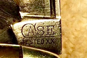

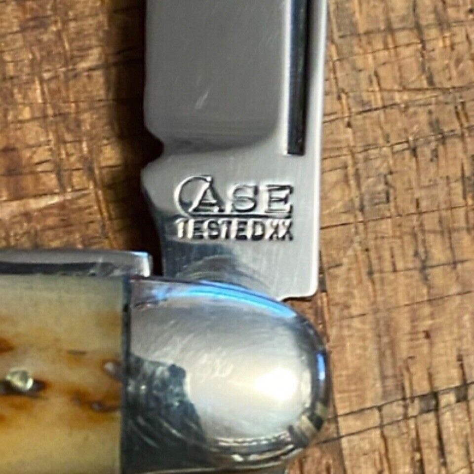

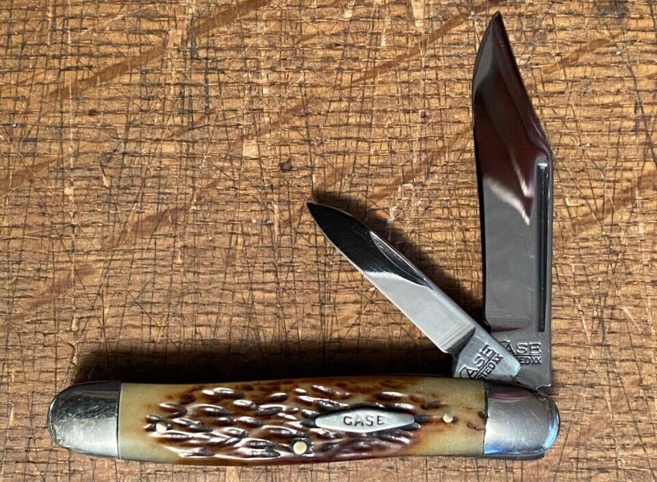

Below are samples of honest Case Tested stamps. Note the letters are crisply cut into the metal, and do not appear “mashed” into it. Look at the “E” and other letters - the corners are square, not rounded (the rounding results from the affects of cold stamping where the metal is mashed, not cut, by the stamp).
Only one of these examples is from a near-mint knife. Age and wear can remove some of the crispness of stamps, as can buffing, so all stamps do not have crisp corners like these, but they should not appear mashed into the metal. If you see a supposedly “mint” Tested knife that does not have a crisply cut stamp, proceed with extreme caution. ::nod::

The stamp on the OP knife is horrendous. ::barf:: ::barf:: ::barf::

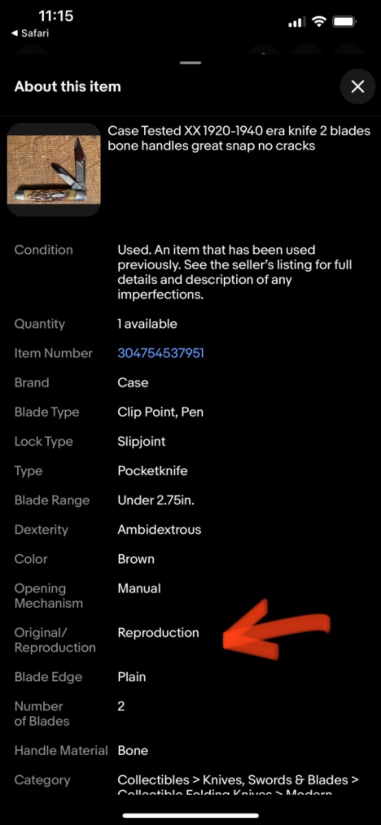

I ain't sticking up for seller but in description he has "reproduction." Hope bidders read.

coricama wrote: Sat Dec 31, 2022 12:40 pm I ain't sticking up for seller but in description he has "reproduction." Hope bidders read.
All I see in the description is
Case Tested XX 1920-1940 era knife 2 blades bone handles great snap no cracks. This knife has no number. Beautiful unused condition.

Looks like it started out as a Kutmaster knife.

knifegnome wrote: Sat Dec 31, 2022 2:28 pm Looks like it started out as a Kutmaster knife.
Yes, another fake Case mad out of Utica parts.

It’s in the about their item section. Nothing in item description but what you showed.

I was going to give the seller the benefit of the doubt, thinking they just didn't know what they are selling. That sneaky hiding "reproduction" in the fine print pushes them into the crook category as far as I'm concerned. ::huff::

123wareagle (1954). The knife can't be both a "Case Tested XX 1920-1940 era knife" and a "reproduction".

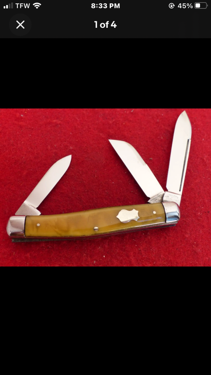

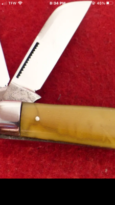

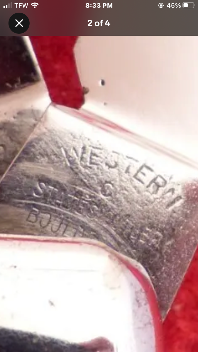

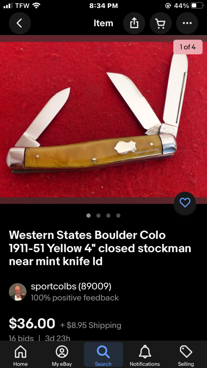

Is this western states a fake.

Thomasg wrote: Mon Jan 23, 2023 2:39 am Is this western states a fake.5B895A12-E1FA-4CCA-BE18-0EBD1EC71E5B.pngA77BC47C-4946-49C6-8B4E-AC87ED2B4D53.png1E760B0E-475C-44B5-AD1F-80D6BA475B50.png195CB388-50E2-4490-A391-C8C7C34C959C.png
Since the title of this thread references Case, you’d probably get a better response to questions about the Western knife if you start a new thread with your question either here or in the Western Collector's forum. Most Western experts aren’t as likely to read your post here. JMO
