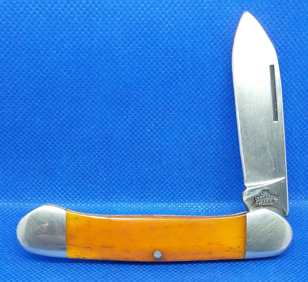

I bought a couple of these Canoe knives at the Bear and Son factory sale back in the Fall, with the "Colonel Littleton" tang stamp. Both were unfinished, and had problems with the secondary blade.
I fixed the secondary blade on this one today, then wound up messing it up badly. When I crinked it, the hammer left deep marks on the blade, as though the steel was soft. The main blade appears to be fine.

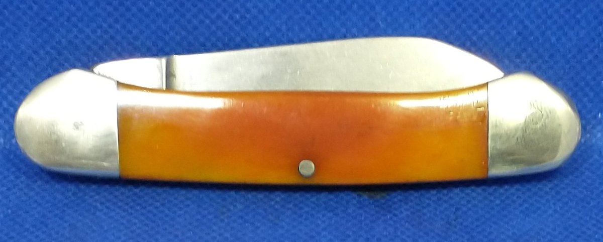

So I removed the secondary, and find that I really like the knife this slim. I may do the same to the other knife.

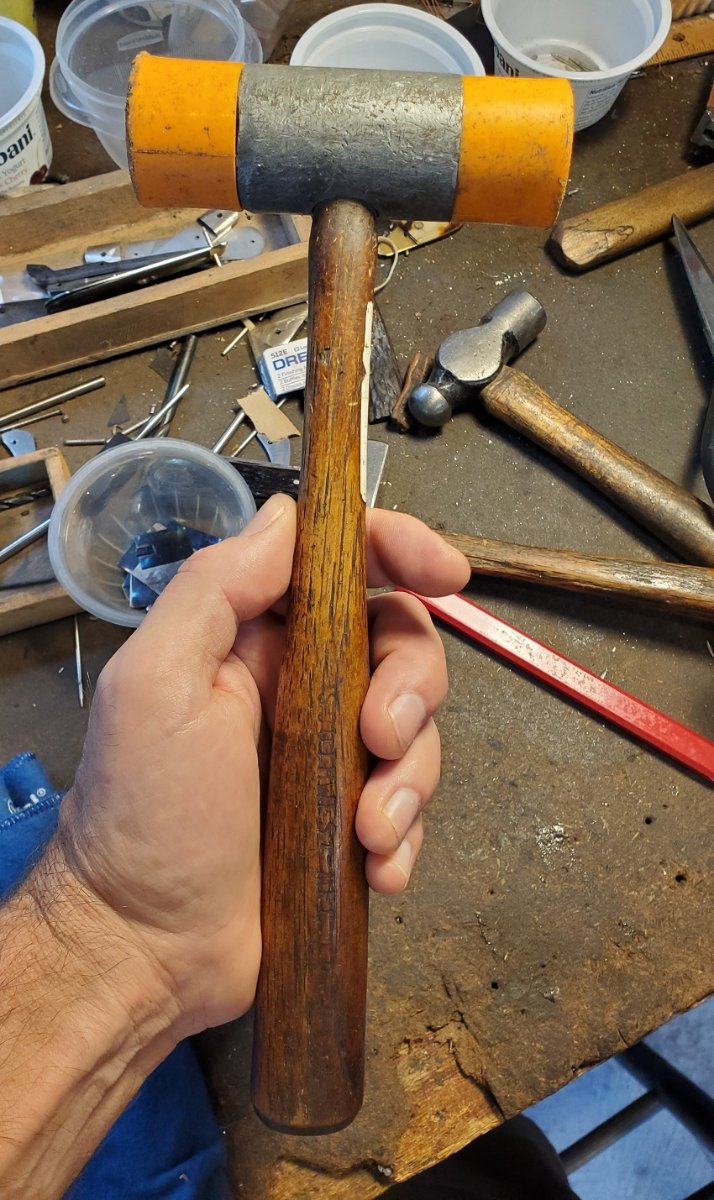

Looks good Reverand! When you crink try using a plastic headed mallet like this, it won't mar the metal. There are generally two sizes of these. Go for the larger one as the extra weight helps.

Good idea ... I don't (yet) have one of those plastic mallets. For crinking, I''ve had good luck with just a piece of duct tape over the head of a hammer & it won't mar the blade.

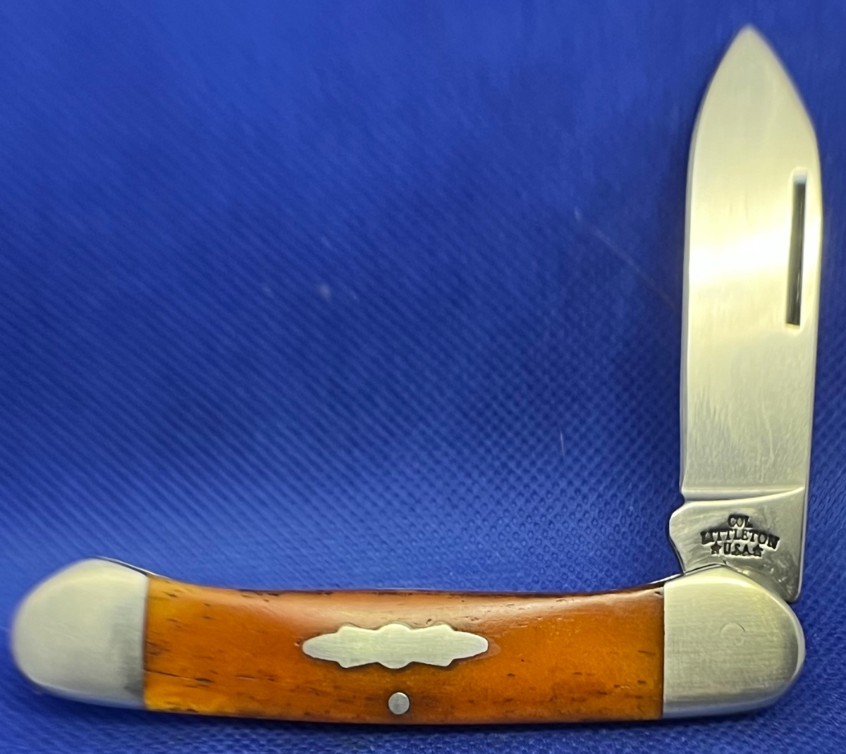

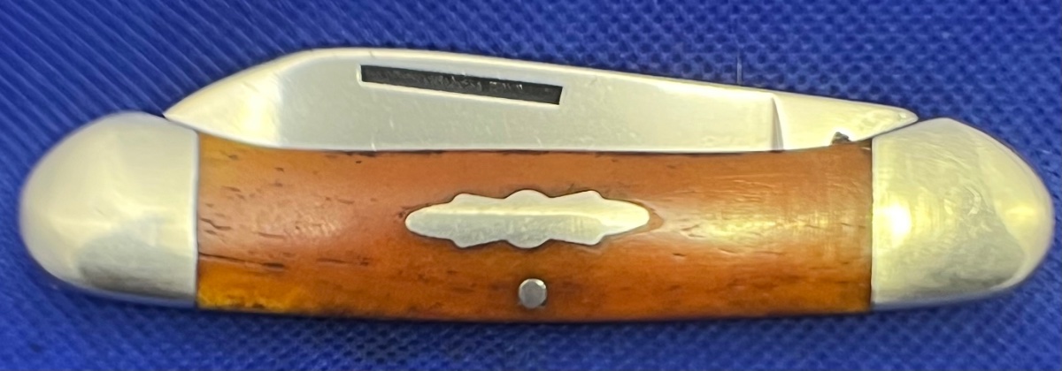

I re-visited this Col Littleton, because I have decided to give it as a gift, and thought it looked a little too plain.
This propeller shield is the look I wanted!
It is slightly tilted to the left, but not too noticeable (I hope!).
Inletting into smooth bone is less forgiving than jigged bone. You can sometimes hide a slip-up in jigged bone, but not in smooth! I need to invest in a Foredom at some time. The Dremel can easily get away from you!

That shield inlay looks good!(The lean isn’t really noticeable). And it definitely dresses up that smooth bone.

That shield definitely dresses the knife up, nice!
