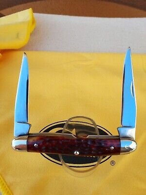

I am having second thoughts as to this ebay auction.. The seller says "near mint" "never sharpened" "transition"???????? Item # 144920886565

Seller description says lightly used. Probably buffed. Claims the blades are Tested era blades stamped XX making it an early XX knife (thus “transition”). ::shrug::

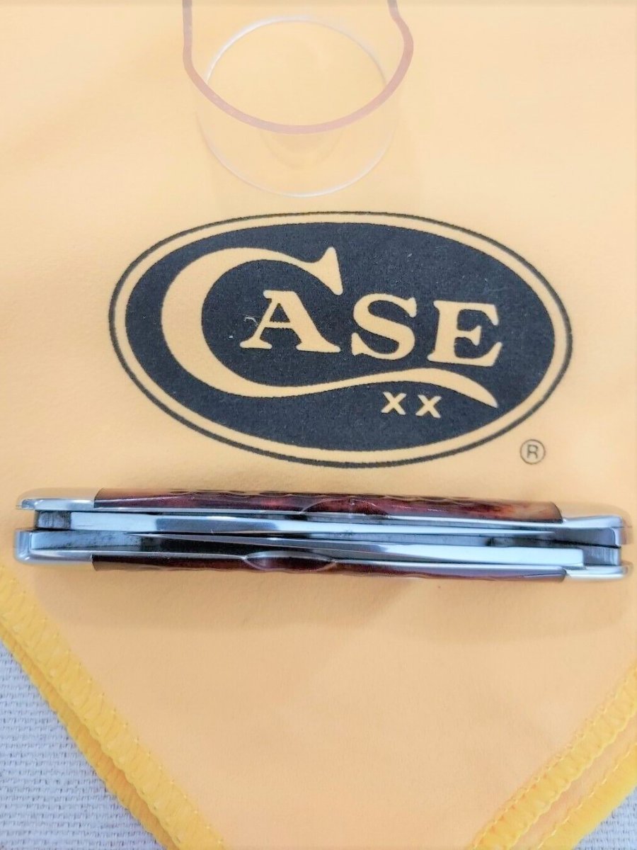

You can see from the picture looking down into the well of the knife with the blades closed that the blades are well short of the mark, that accounts for the slimmer profile, in my opinion. Down at least 10%, especially the front blade. Still a nice old knife, probably cleaned. JMO

I agree with msteele6, those blades were used and then heavily buffed. Just look at the two knives together and compare the blades. The difference is glaring. ::td::

Edges on the blades don’t look straight. That knife WAS sharpened and not with the greatest of skill. Not in horrible condition but the description is totally inaccurate.

Tested muskrat blades are certainly not any shorter than other muskrat blades of different eras. If they are mint they are full length.

This seller includes the one picture that is most important to determine the condition. The picture of the blades in the well photo is one that is not included by the vast majority of eBay sellers selling older collectible pocketknives. Master blade tips on nearly all patterns should extend to and past the opposite end bolster (on knives that are bolstered on both ends) when the blades are closed. Even if the knife is a barehead or shadow type knife the length of the blades and overall use can only be best seen in this photo. Camera angles and the distortion of wide angle lenses can't disguise what is evident in this picture. In this example the seller tries to, and falsely explains the shortness of these well used and overbuffed blades as the result of being an older model knife. Since this picture is so important it is hard to understand why so many sellers show so many pictures only to leave this picture out of the description. I am sure that some sellers leave it out deliberately for the obvious reason.
At a current bid of $227.50 it is easy to see that the bidders are buying and reading the description rather than reading the knife. Both blades of this knife are significantly short. IMO $50 would be plenty for such a well used example.
