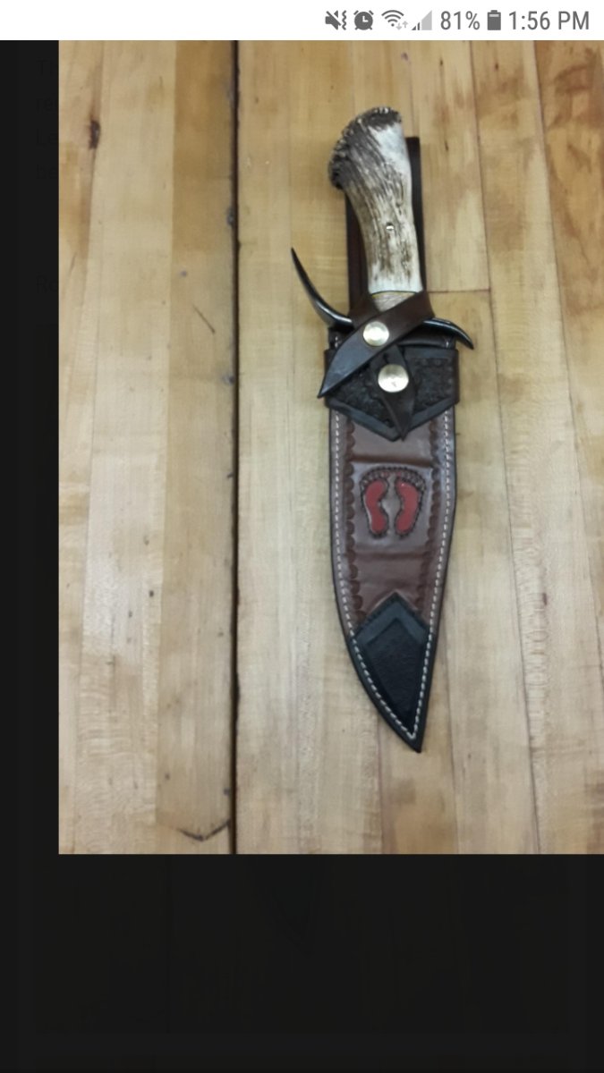

Example of a lined sheath. you can see the liner leather rolled over at the top

Veg tan leather is what I use . I have come to use wickett and craig skirting leather https://wickett-craig.com/leathers/skirting/ I use this because it can still be wet molded, tooled carved etc. The benefit is it is already dyed a color which for me saves me the cost and time of dying leather. That said nothing wrong with dying natural veg tan.
For the pouch sheath above I used a 7 to 8 ounce piece of leather. Plus a welt. I skive the edges down so the total thickness ends up Im guessing around 14 to 16 ounces at least. Inside the above sheath I lined it with deer skin. I have also used thin like 2 to 3 ounce veg tan to line sheaths usually for a bowie style sheath rather than a pouch fold over type.
As far as pouches Im guessing you mean for pocket knives I also use veg tan for that.
I do avoid upholstery leathers and pull up leathers they are too pliable and cant be wet molded or tolled etc. I will use exotic leathers at times for inlays like snake skin as an example.
