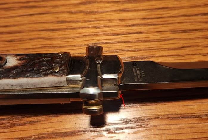

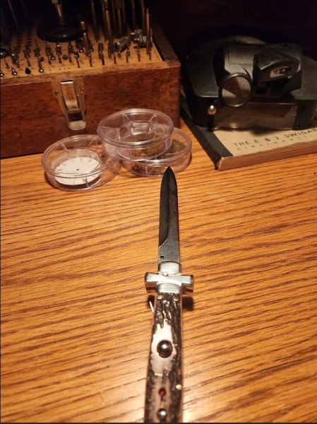

Picked this one up recently, besides a bit lack luster polish on the blade I notice when opened the blade leans just slightly to the left of center.
I was wondering if I might take a crack at filing the lock back steel a bit to allow it to open further, or if that is just creating more "slop" and problems for me. any advice ?
I also took a light polishing to the blade with no good results, surprised Campolin has so much grain in the steel. I've had good luck on other blades but this one seems a little more stubborn. It's gonna be a cool knife once tuned up a bit. (I added the countersunk red dot as a little something fun to do)

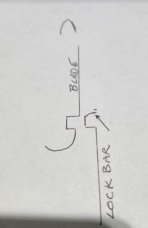

I'm pretty comfortable with fine detail work, messing with antique clocks and watches over the years, but I wanted to double check myself on the geometry of the lock too.
My drawing is crude but tells me whats going on.
I am thinking the lock bar notch (bottom) might hold the blade and keep the wobble in check, allowing me to just barely shave the top of the (rounded) notch corner to allow the blade to sit straighter. Risk is of course introducing a bit of side-play.

Yep, I see your logic totally from your picture man.
It appears it would be simple enough, I guess I was just suggesting to go very slowly and try and measure it with each grinding, cuz when I did this to a knife of mine I wound-up grinding off too much and as a result the blade was now "leaning" the other way too, so now I have a knife with play in both directions. Slow and easy is always best.

Id be careful filing anything, my understanding is that the lock-back needs to be moved back then re-fastened once the blades in the desired position ….. i may be wrong . It could be as simple as tapping it back with a drift punch … tap tap

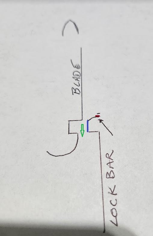

Thanks guys. I think I see your meaning Wise', I'm thinking it needs clearance in the red for the tilt, but if I'm reading you right, it could instead need clearance in the blue. I think it's in the red still, but this gives me something new to look at.

You guys helped me see even a 3rd angle, now with GREEN. Where there's no filing but the lockbar needs to be lowered and drawn towards the butt end of the knife. This I think would correct the blade tilt and not introduce new play.
Probably a re-pinning job and not something I'd tackle on an otherwise good knife but something new to look at.
This all probably belongs in Knife Repair - sorry, but getting use of of my drawing anyway. LoL

If I'm understanding him correctly Randy, I believe that's what WG was eluding to, tapping the blade back into position.

This looks correct
SwedgeHead wrote: ↑Thu Mar 02, 2023 12:12 amYou guys helped me see even a 3rd angle, now with GREEN. Where there's no filing but the lockbar needs to be lowered and drawn towards the butt end of the knife. This I think would correct the blade tilt and not introduce new play.
