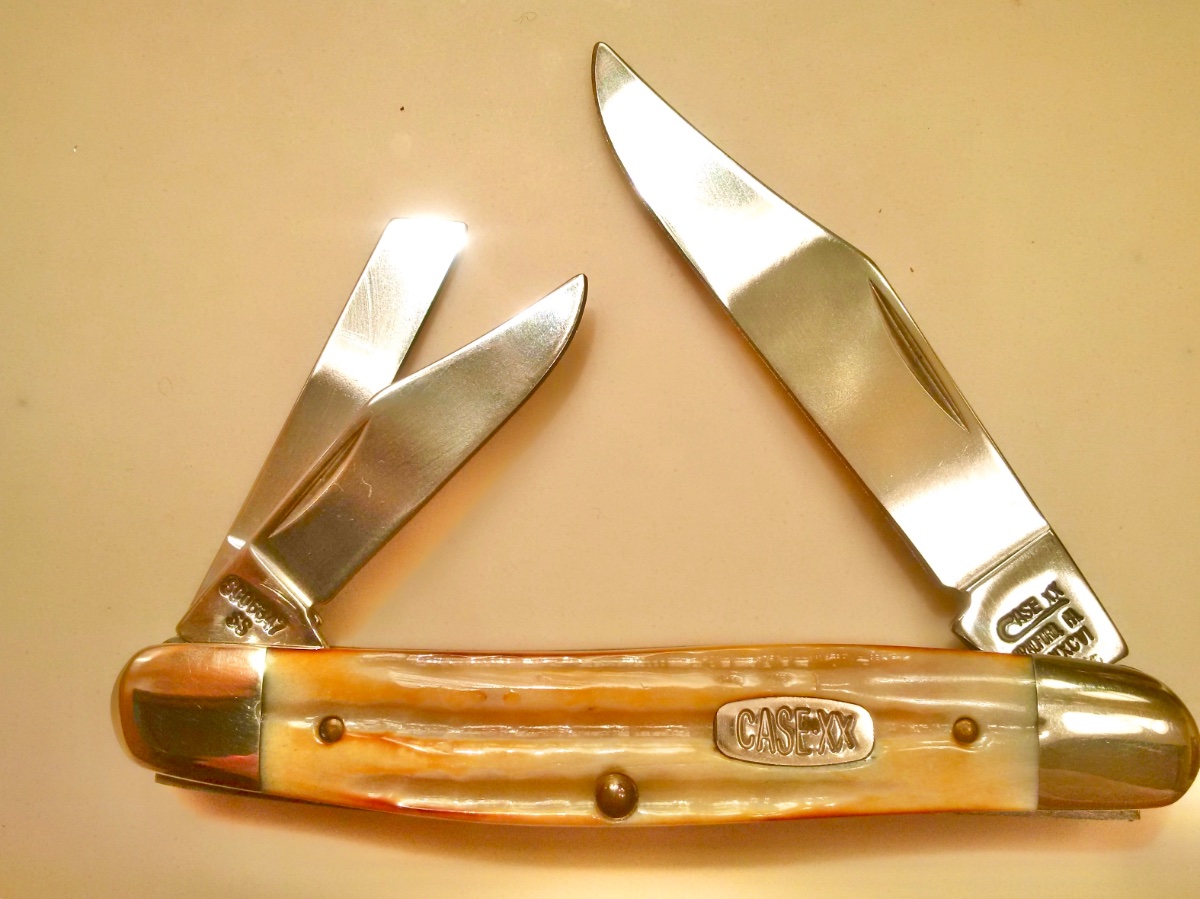

Re: Second Cut handles
I have a Case Small Coke in second cut stag. It looks great, little difference
than my regular stag.

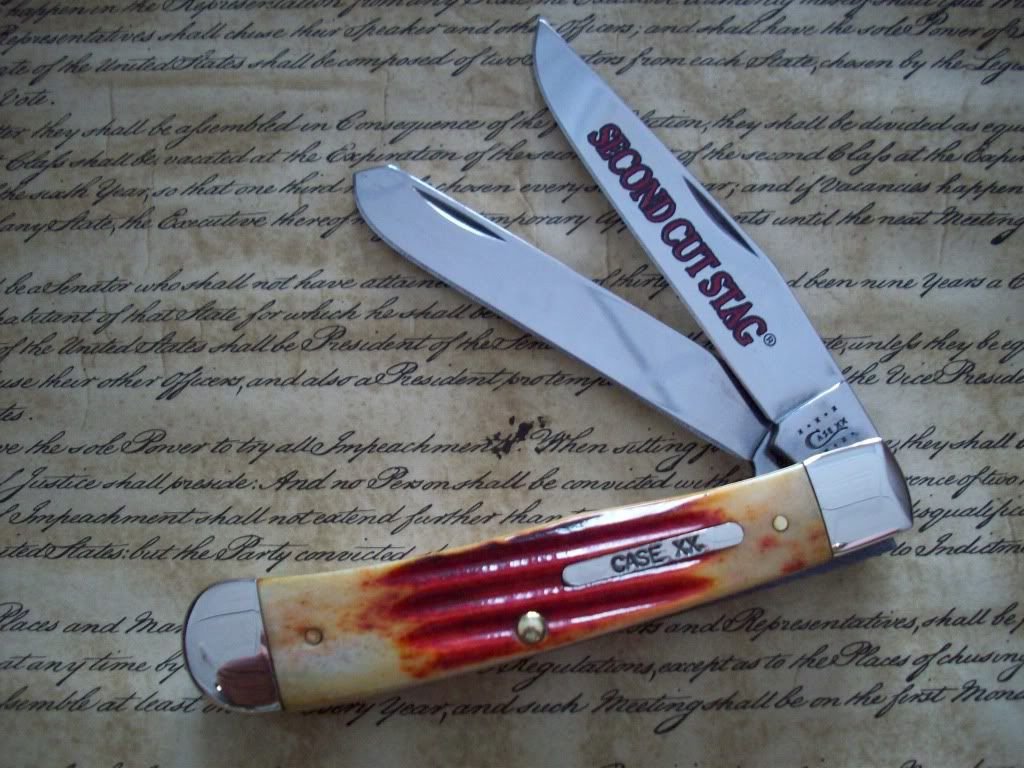

My understanding of Second Cut Stag is the same as Orvet's. The outer bark layer has natural grooves and valleys. That outer bark layer was 'peeled' off and used on a Genuine Stag handled knife. The inner second cut material requires mechanical jigging, dyeing, or torching. Case had a very specfic jigging pattern they used on their Second Cut Stag up through the early 2000's. That is what is depicted above. Since that time, the jigging pattern they have used on Second Cut Stag looks more like a Winterbottom jig variant. Although I have not seen Case offer Second Cut Stag in several years, when they did offer it they also offered a Second Cut Red Stag variant.

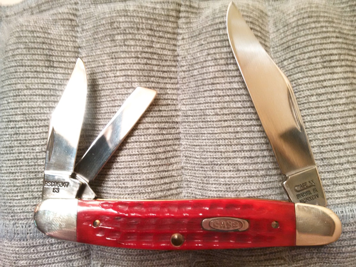

I concur with what Dale and Gary said. Here’s an example I have that fits their description quite well. Slab has been jigged and torched to give it some color. The covers are as hard and rugged as any stag or bone covers. I can’t detect any degradation in functional “quality”. Whether or not you like the appearance compared to first cut stag or bone is subjective, in the eye of the beholder. Personally I can’t see any difference compared to jigged bone, but uncut and nicely hafted stag is unparalleled in appearance IMHO.
BTW I think this thread should be in the Case Collectors Forum. They’re not ”Customized Factory Knives”. These are factory knives, just as they were produced by the Case factory. This one was part of the Roman Numeral stamp SFO series that Case produced for Frost in the 1990s.
Ken Edit: Here’s another one I forgot I have. Red Second Cut, RSC06347.
