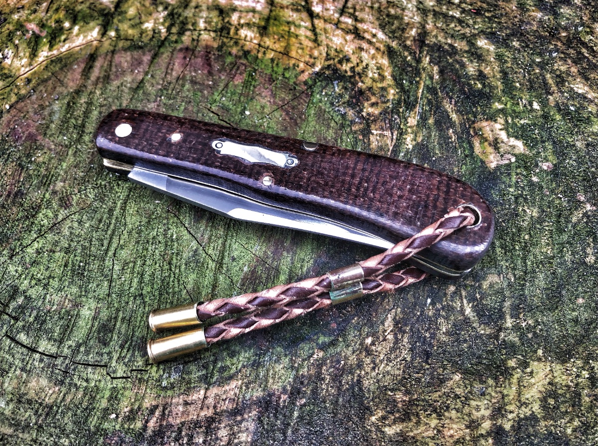

I recently but back together a Case back pocket that someone badly took apart, I did it in a shadow pattern with micarta , it went together really nicely and I really like it , but the blades off centre , doesn’t rub on the liner but is close, I can live with it as it’s a user for camp , but could I crink it ? I’ve watched a few videos but I’ve also seen pics of broken blades , I’m guessing the tangs softer ? What are peoples thoughts on crinking , and should I just live with it

Are you sure the problem is krinking? If the blade came out of a single blade knife it should not be krinked and the problem is more likely in the assembly of the knife. Pins that are slightly tapered or holes that aren’t perfectly aligned can throw a straight un-krinked blade off center. If the blade is taken out of the frame and layed on a flat surface, alternating sides it is usually easy to tell if the problem is a crinkled blade.

I agree with what everyone else has said, krinking is a very high risk process! I have broken more blades than I have straightened.
Since it is a single blade knife, there shouldn't be any krinking to the blade to begin with. It is possible the pivot pin may have bent a little bit when you peened it, or that one side of the handle may be slightly lower than the other, pulling the blade to one side.
I have found I can often correct this by striking down with a hard plastic faced hammer on the top of the handle right at the pivot pin. Strike downward on the side that the blade is closest to and that should pull the blade to the other side just a little bit. It sounds like you don't need much adjustment, so that will probably do the trick.
I usually use this process on knives that have bolsters, and would never recommend it for a shadow bolster knife with brittle handle material like stag or bone, but I think the micarta is tough enough then it shouldn't damage the handle.
