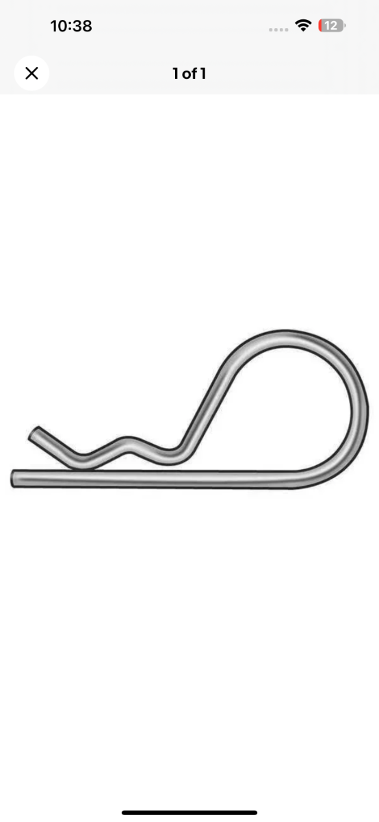

Would something like that work for a pin if it was the correct size. Or is it just the wrong kind of steel all together?

miked32 wrote: Sat Jun 03, 2023 2:39 am Would something like that work for a pin if it was the correct size. Or is it just the wrong kind of steel all together?
Spring clips like that shown have to be hardened somewhat to work correctly. Probably would be too hard to peen.
My thoughts exactly.
