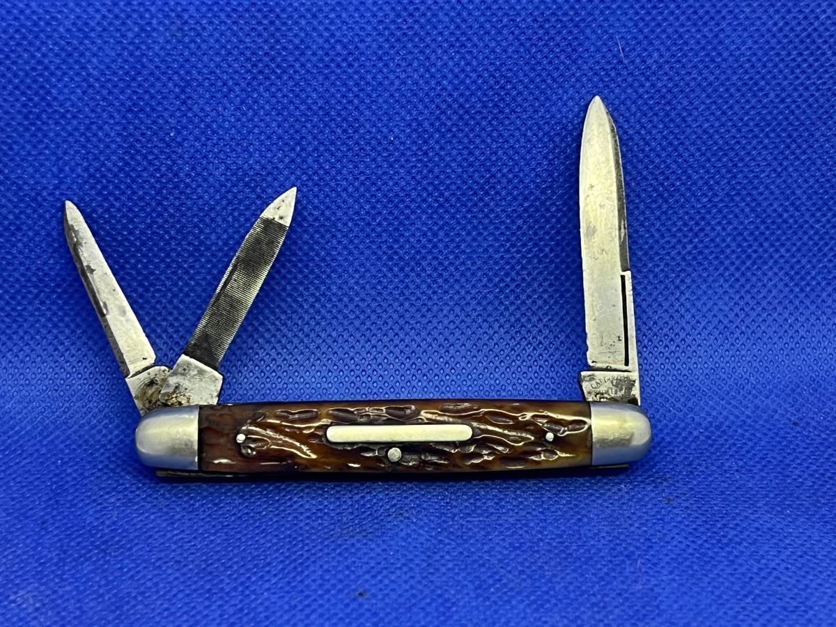

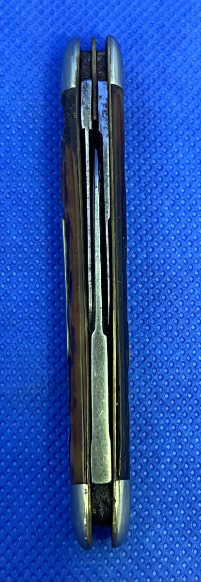

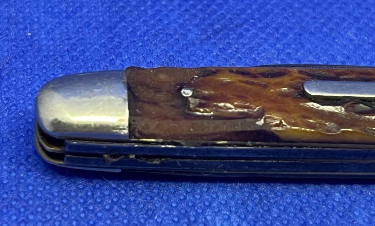

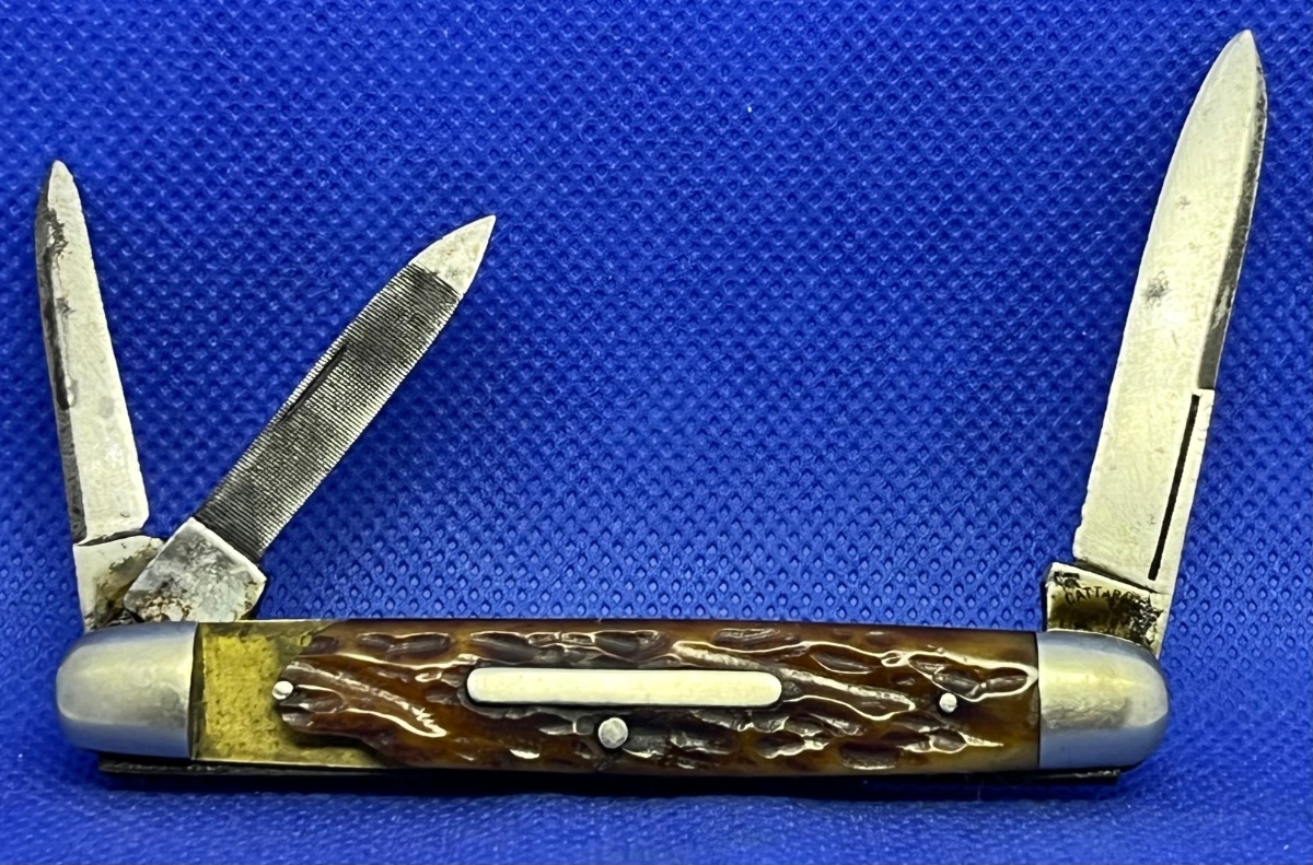

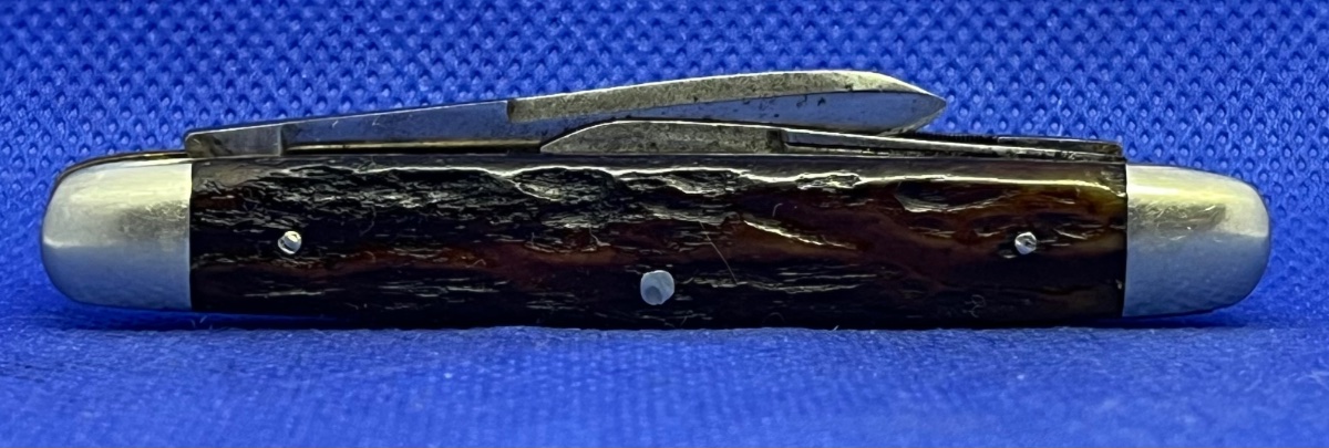

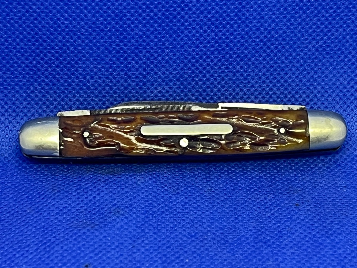

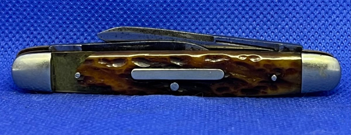

Thomasg sent me a few knives as a tip for the work I recently did for him. One was this Cattaraugus whittler with a proud Main and a broken Mark-side handle.
I have not been over to the knife shop for over a month, but I managed to repair this knife with some epoxy and a Dremel tool on my front porch!
I do not have Acraglass, but I did have some JB Weld brand 5-minute clear epoxy. I sanded a scrap piece of Walnut for the color, and a little of it matched the color fairly well. But I should have added a lot of light-colored powder as well, as I can still see through the patch!
Oh well, it is okay for a first patch. And the old beauty is going into my pocket and riding to church this morning!

Nice! It's great to see the knife given an extension on life.

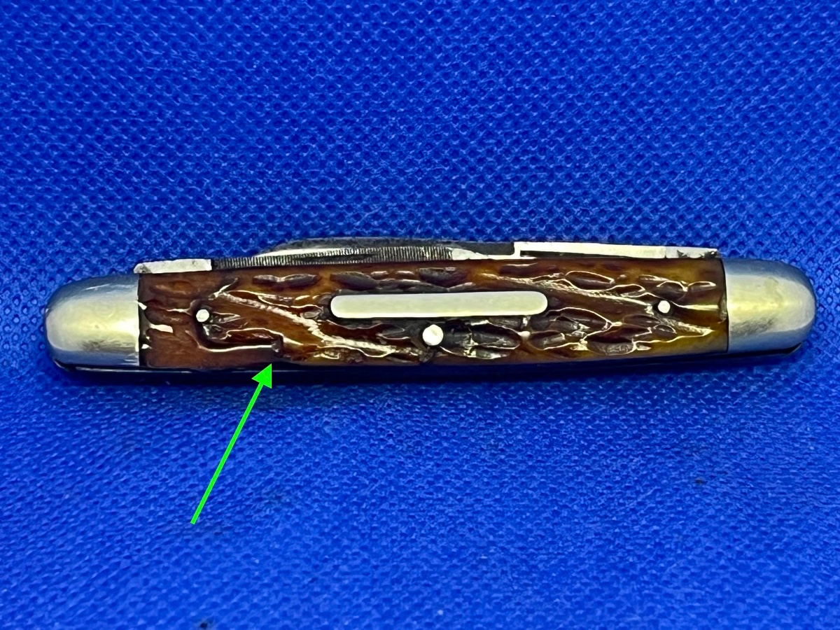

I'd say that's a very nice job of repairing that knife. Based solely on the photos you provided, the only thing that would make me question that knife is this gap. Other than that, I could not tell the difference. For a first try, I'd say you hit it "out-of-the-park". Well done.

Great job on that knife, Reverand.
There are other threads on here about epoxy patch and I think your's is as good as any of them.
Nice job bringing that spear down.

Well done Rev!
P.S. - I'm surprised that you haven't done more patches. I find they are "hit and miss" and many times I'm not happy with my results. The good thing about epoxy is you can just warm it up with a heat gun or hair dryer, pry out the patch with a pick and give it another try. For me, matching the colors is the hardest part.
