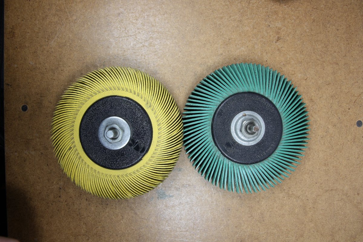

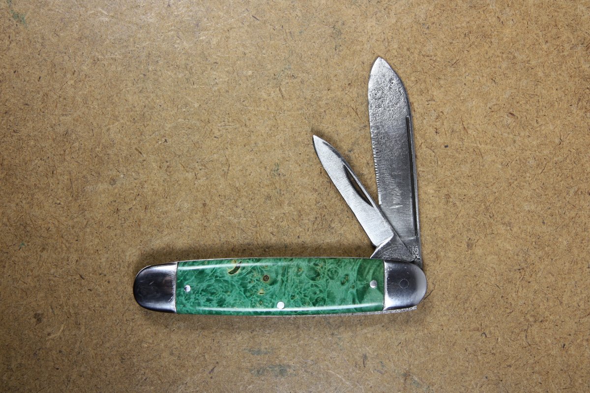

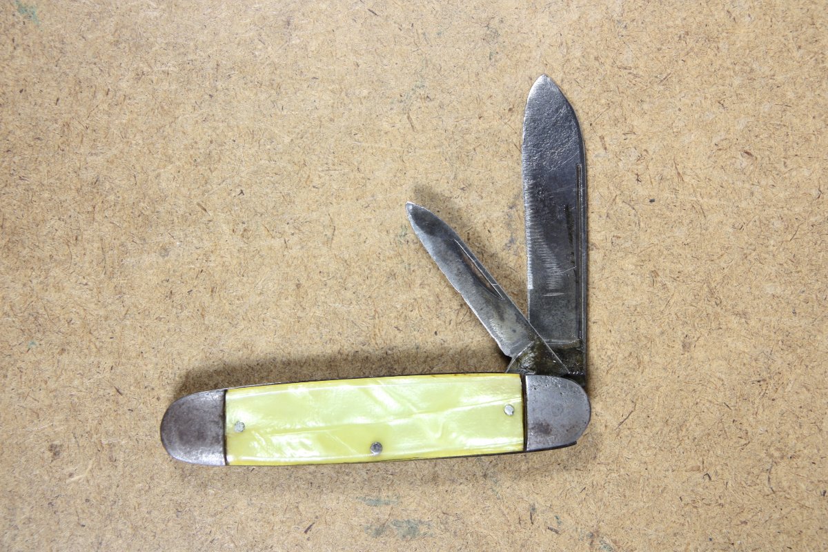

On rusty steel I have been using these 3M Radial Bristle Brushes. They are a 6 inch plastic wheel that has been mixed with an abrasive compound that somewhat resemble wire brushes, They are available in different grits, the green one shown is 50 and the yellow one is 80 grit. The green 50 grit works good for removing heavy rust but will leave scratches. Follow that up with the yellow one for a brushed look finish. The Kutmaster jack shown was covered in rust while residing in a flea market $1 apiece box. It is an all steel knife, liners, center divider, bolsters, and pins are steel. I took it apart and cleaned the rust off inside and out with the brushes shown and rehandled it with some burl wood. It was repinned with coat hanger wire. Its a beater, but is still a good old usable knife. Note, these brushes would be too aggressive to use on anything but real rusty metal. If I remember correctly these are available in finer grits down to about 400. I use them on mandrels that work with the drill chuck I have on my mini wood lathe.

First off, I like that for very damaged blades. I have a few that I have messed up the grind lines while trying to clean them on a sander. This would be much better.
Secondly, WOW those handles look great!
You have definitely given that old warrior a second chance!
