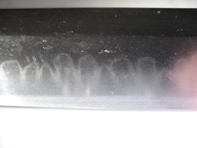

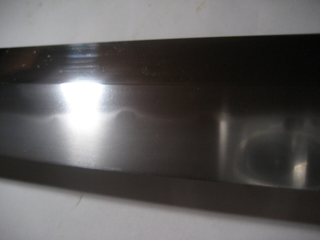

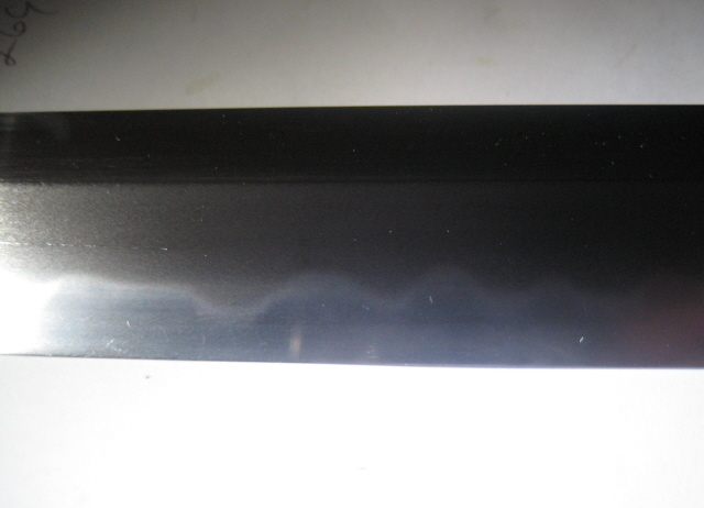

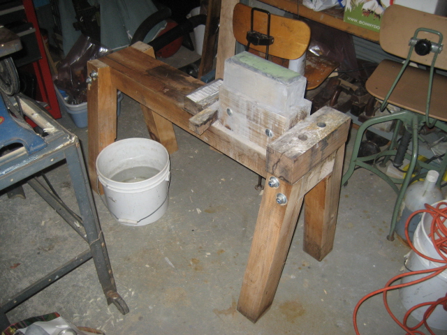

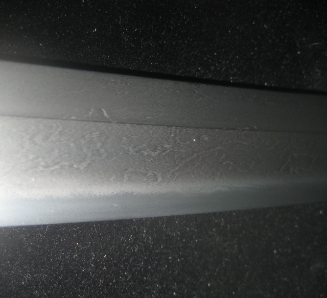

First and foremost I may have mentioned that I restore Japanese swords(about 25yrs worth)but I have always carried a pocketknife.I have shown a few of the knives I have worked on,the same stones can be used to polish either...to a point.On another section of this forum i mentioned the term"selective heat treatment".Hukk replied something like"I think its a hamon and clay or a clay slurry is applied to the sword and heat treated.Bassically true,there are a number of lamination techniques that are used first to make the sword blade.One of the most common is "kobuse" or wrapped.Folded highcarbon steel is wrapped around a low carbonsteel core,forged into the sword shape,roughfly finished,the clay is applied either thinly or nonexistant to the edge(varying widths and patterns) and thickly above,so when the sword is quenched,the edge will cool quickly and harden,and the spine will cool slowly and remain tough,and of corse,the core remains the same.This is the rig i use and a few patters of sword"hamon".Some in prossess and one with an old polish that i removed some active rust on( that still needs a full polish)
