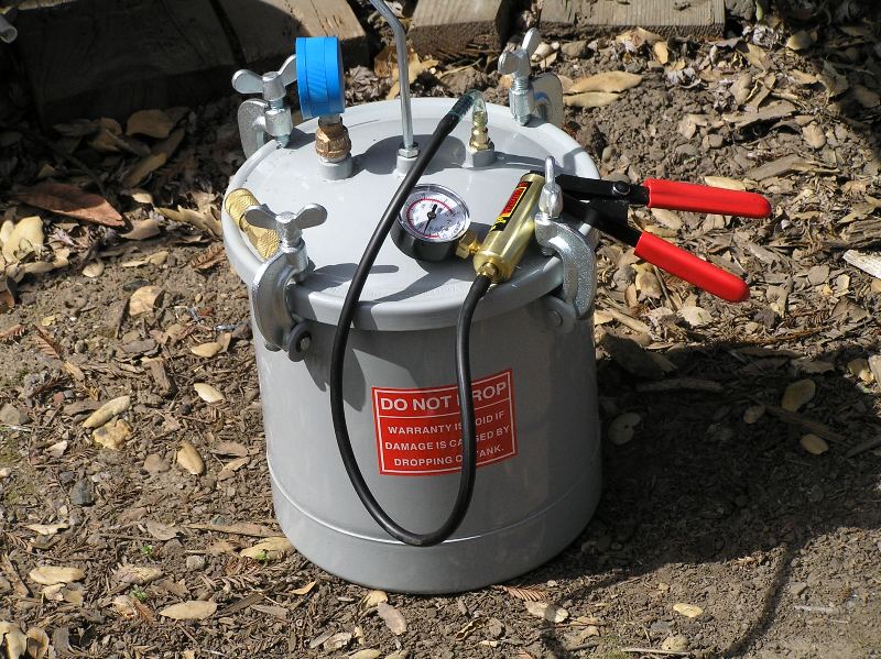

Here is the whole setup pretty simple. On the left is a rigged & ganged quick release couplers for using pressure. With vacuum it's best to have as few parts as possible. So, I just have 1 connector, pressure I add the other 2.

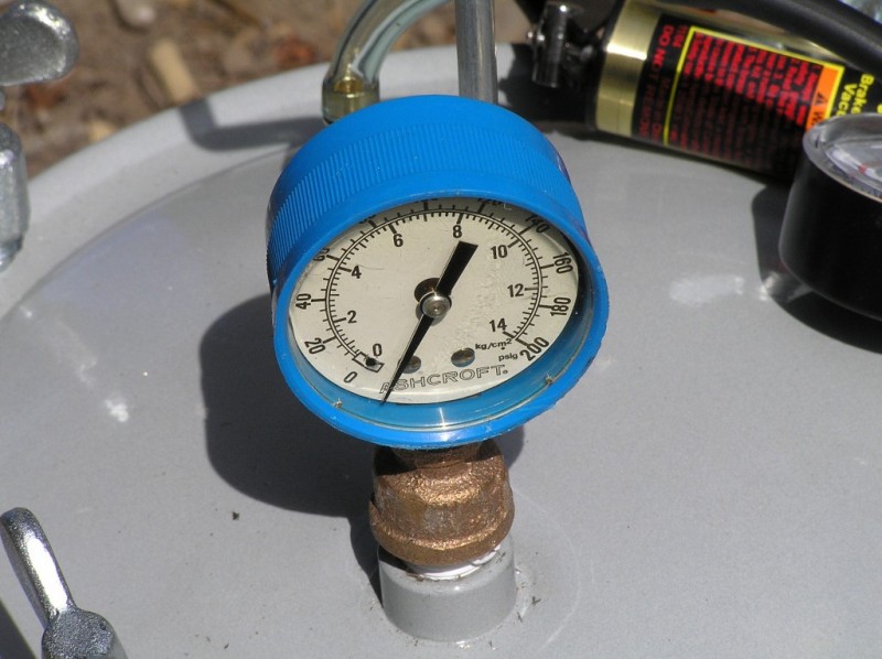

Notice the pressure gauge. I removed the pin so that it can go below 0 PSI without bending the needle. Then I just put everything back together.

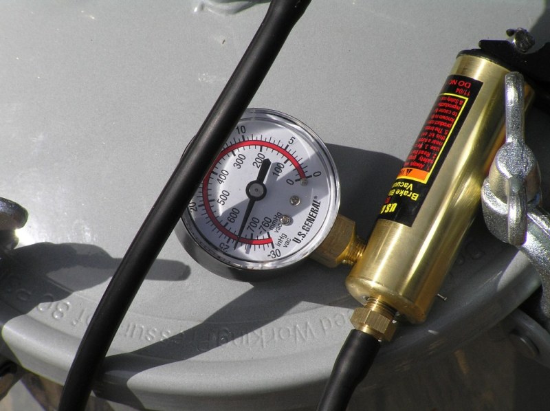

Here is the vacuum gage, it's at 26 inches of mercury (hg) which translates to 12.8 PSI of Vacuum. I want to go to 20 PSI which will be 40.7 inches hg. Need a diferent gauge.
