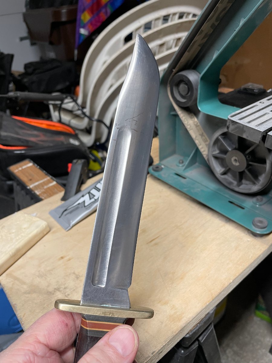

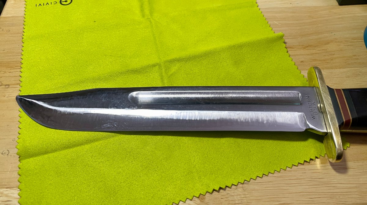

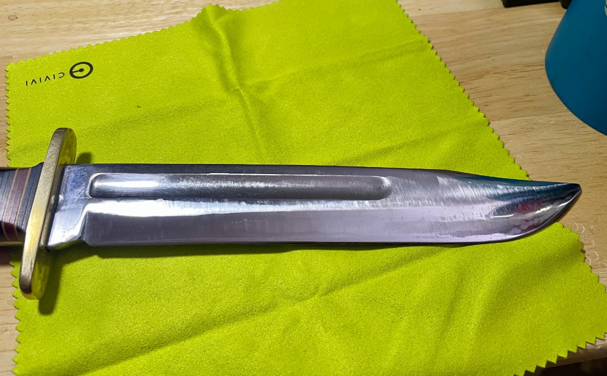

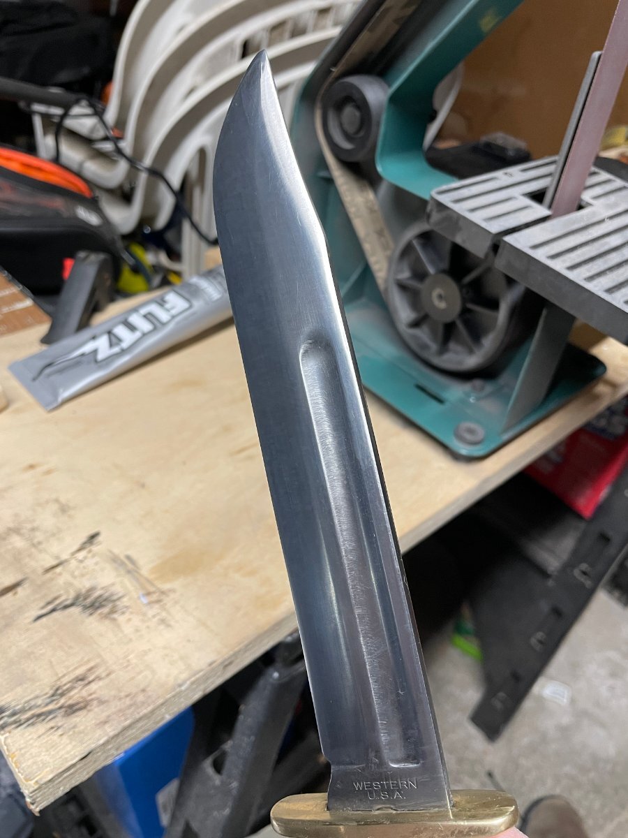

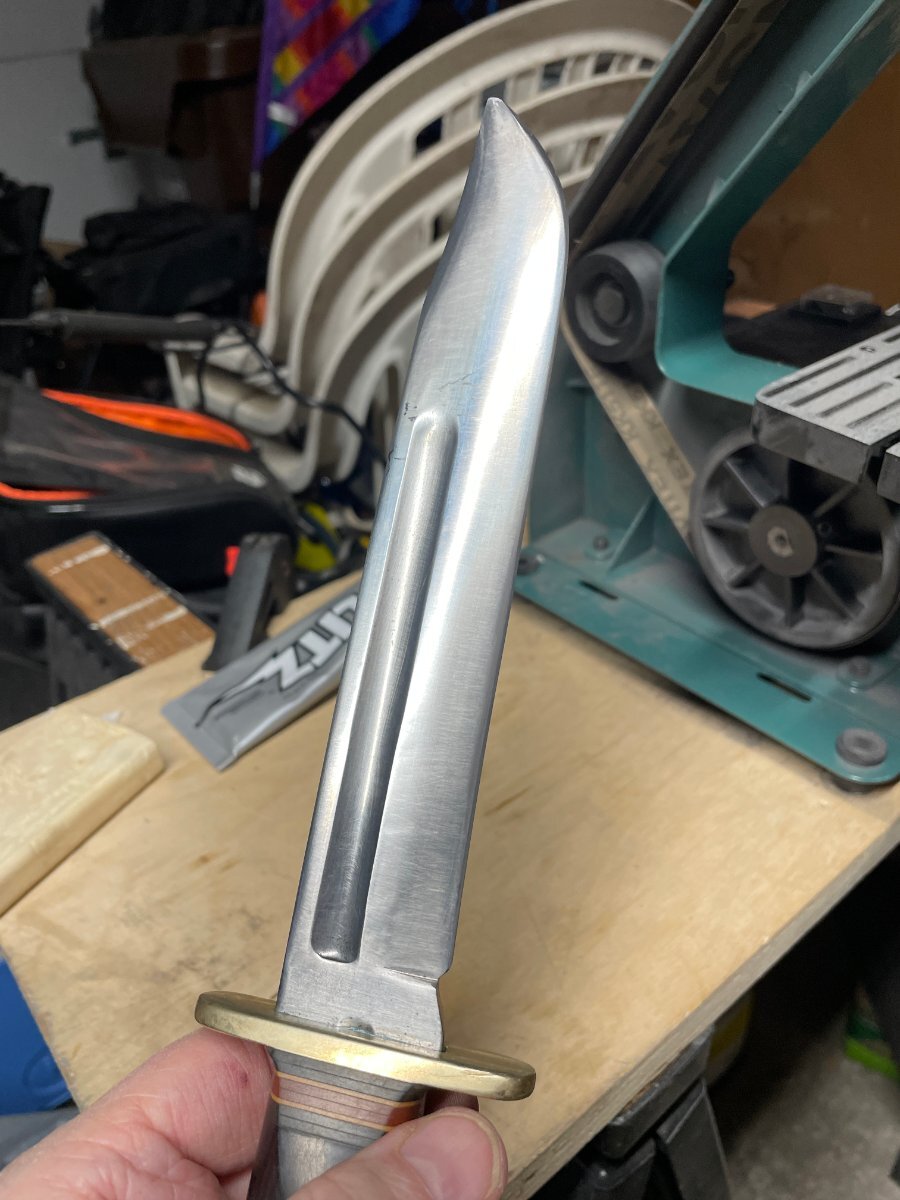

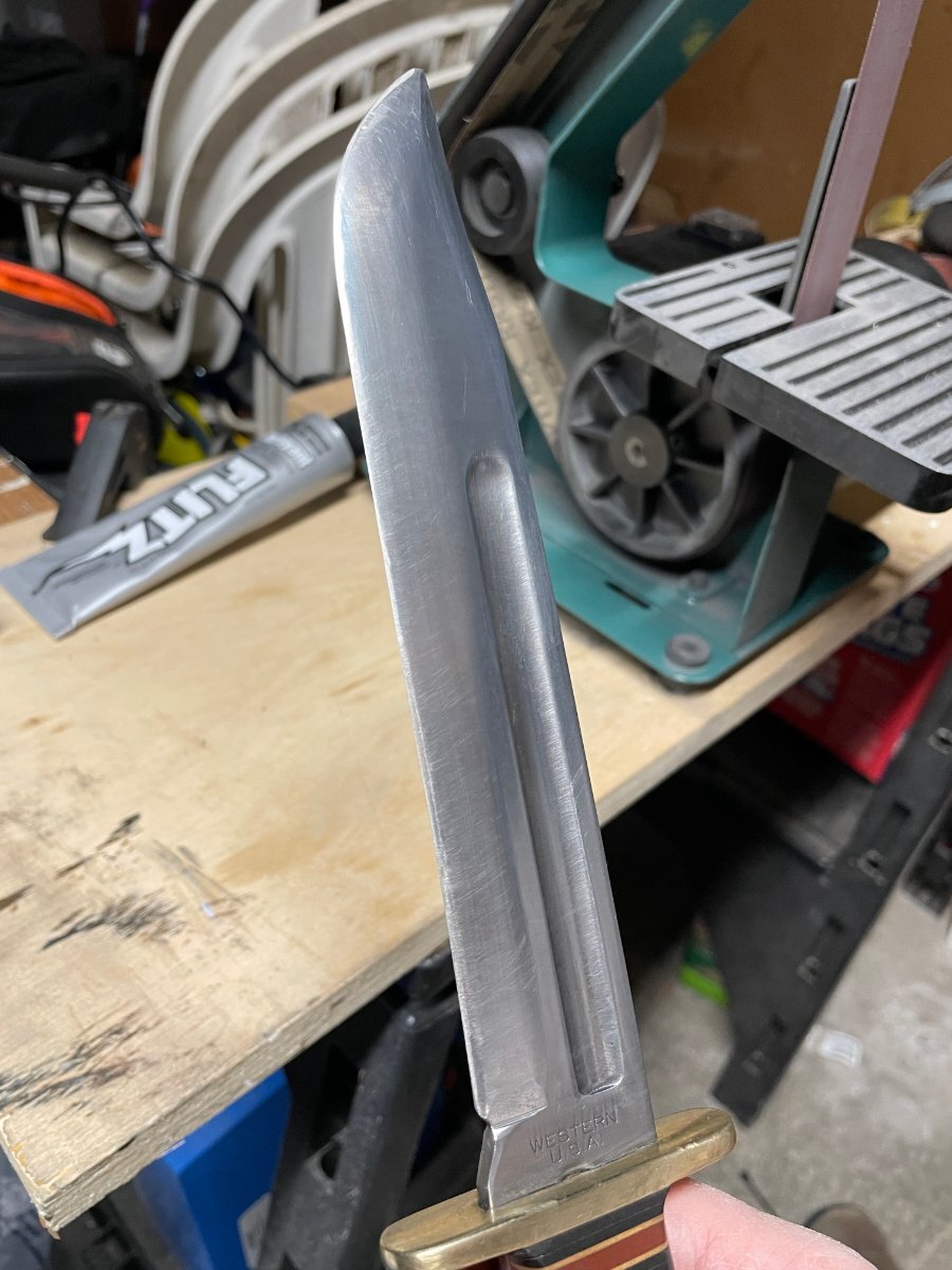

Just got a 1x30 sander. Tried to clean up the blade of this Western Bowie Knife. Started at 400 to address deep scratches, then moved to 800, and then to 1200 (might have done some 600 also). It was looking pretty good until I ran it through the 1200. Then I started seeing all these areas that sort of stand out. Did I move up too soon? Should I go back to 800 and see if they go away? Any advice is most welcome. Thanks!

From your pictures, it looks to me like you never got the deeper scratches out before you moved to the finer grits. The result is you have a highly polished blade with deep scratches still visible.

The thing about most older blades and even many new ones is that they were ground on a wheel resulting in a concave grind. You'd need a wheel or platen to match that radius in order to hit the deeper middle portion of the grind. If you're using a flat platen you're only hitting the higher outside edges of that bevel and would need to completely grind it flat to reach the scratches in the center portion which would completely change the blade profile and probably ruin it. A slack belt would give you the same results while also rounding off the nice crisp angles. Hand sanding would be your best option in that case, it insures that you don't take off way too much steel.

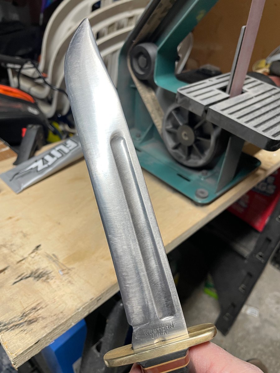

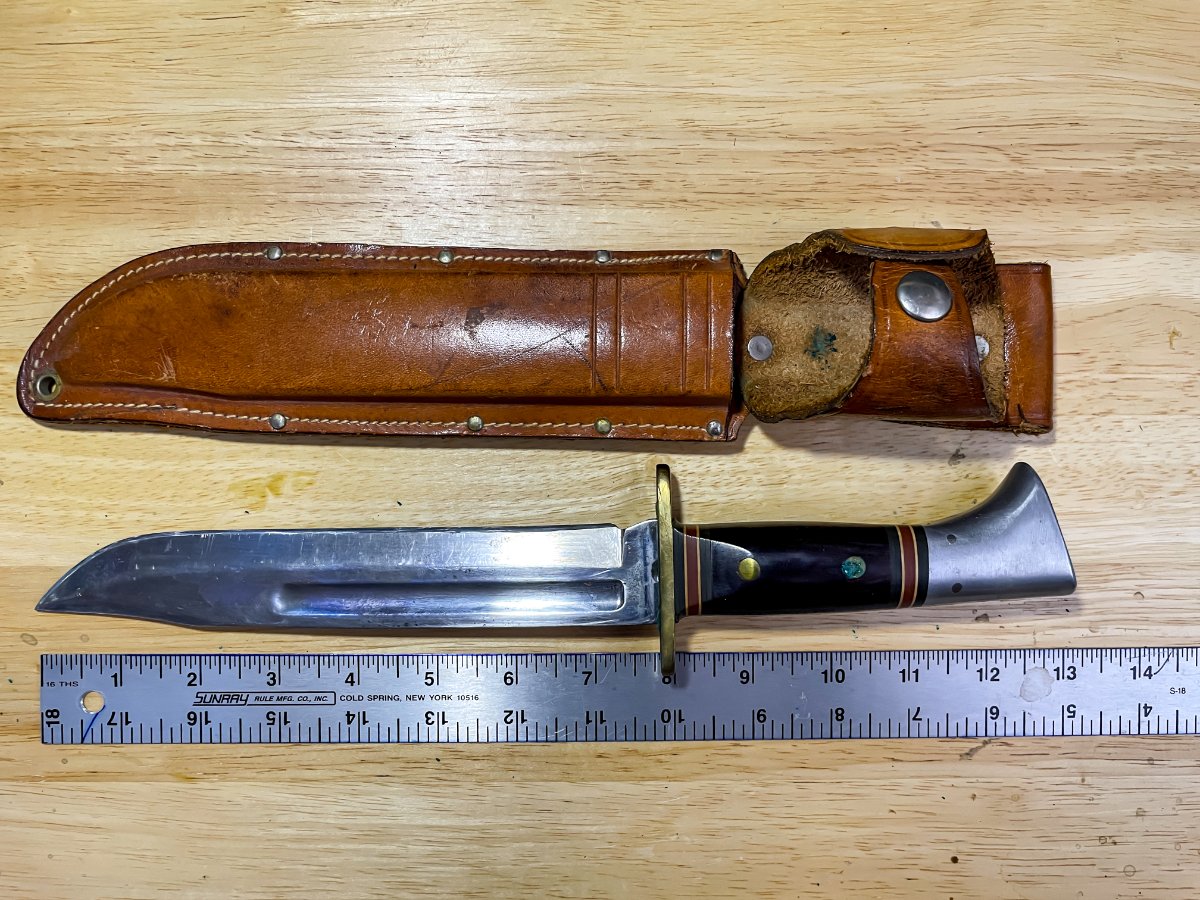

Here's the "before" picture. It was pretty beat up and had a lot of deep scratches.
I'm wondering if I should go back to a 600 grit and remove the "shine" if that would be better? Or, maybe hand sand back to a less polished look?

FWIW I like it the way it was. Honest old used knife!
From what I see it did not have any active rust. Too many folks new to collecting think a knife needs to be shiny and spotless to have top value. Fact is many if not most experienced collectors prefer them “honest”. Just remove any active rust. If you want shiny, maybe polish the blade with a little Semichrome, Flitz or similar very mild abrasive and a soft rag. Trying to restore it to factory finish removes metal, and softens the crisp lines of the knife. JMO
It’s your knife so do with it as you please. Whatever you decide to do, a coating of RenWax will retard any further oxidation.

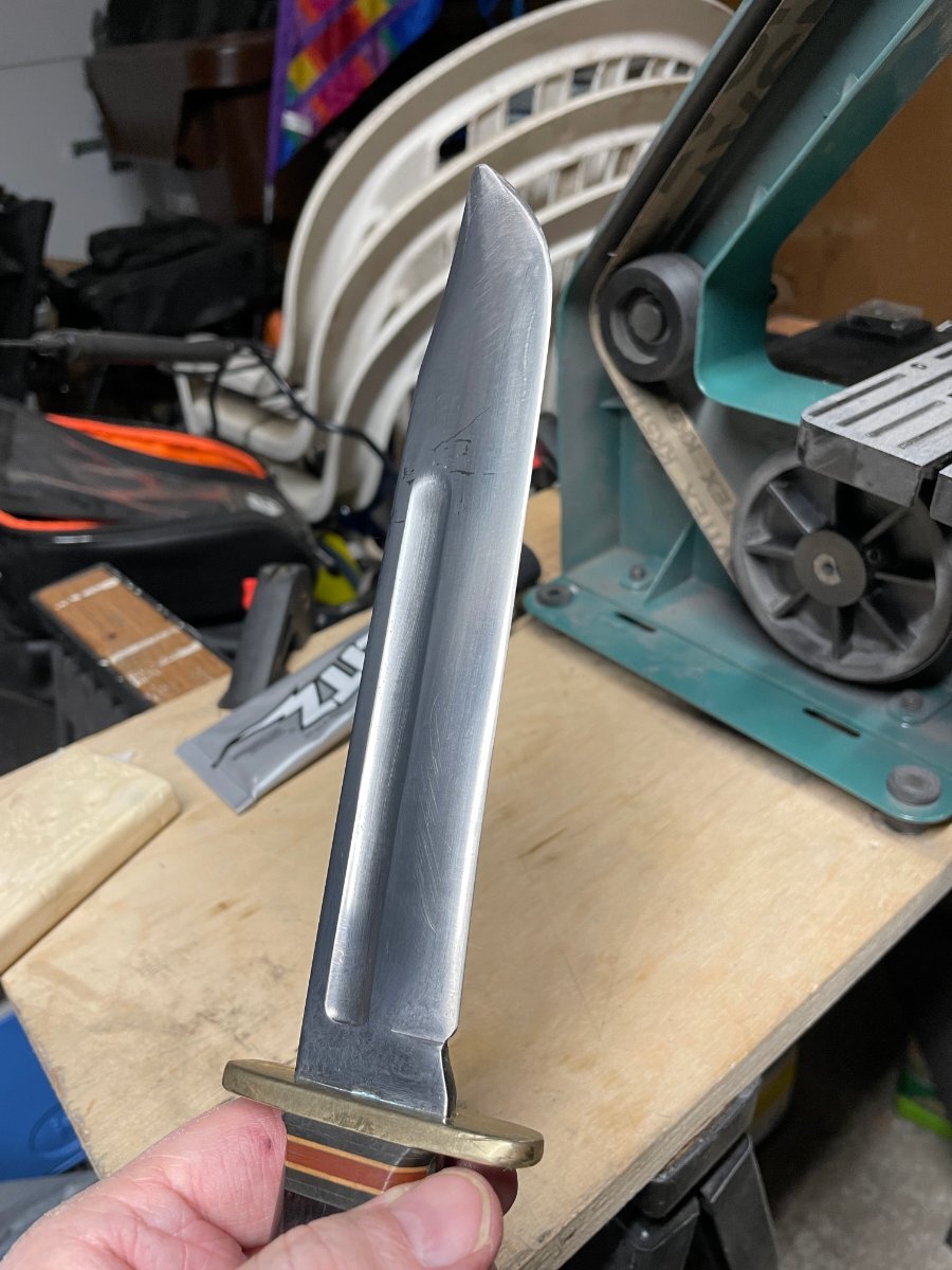

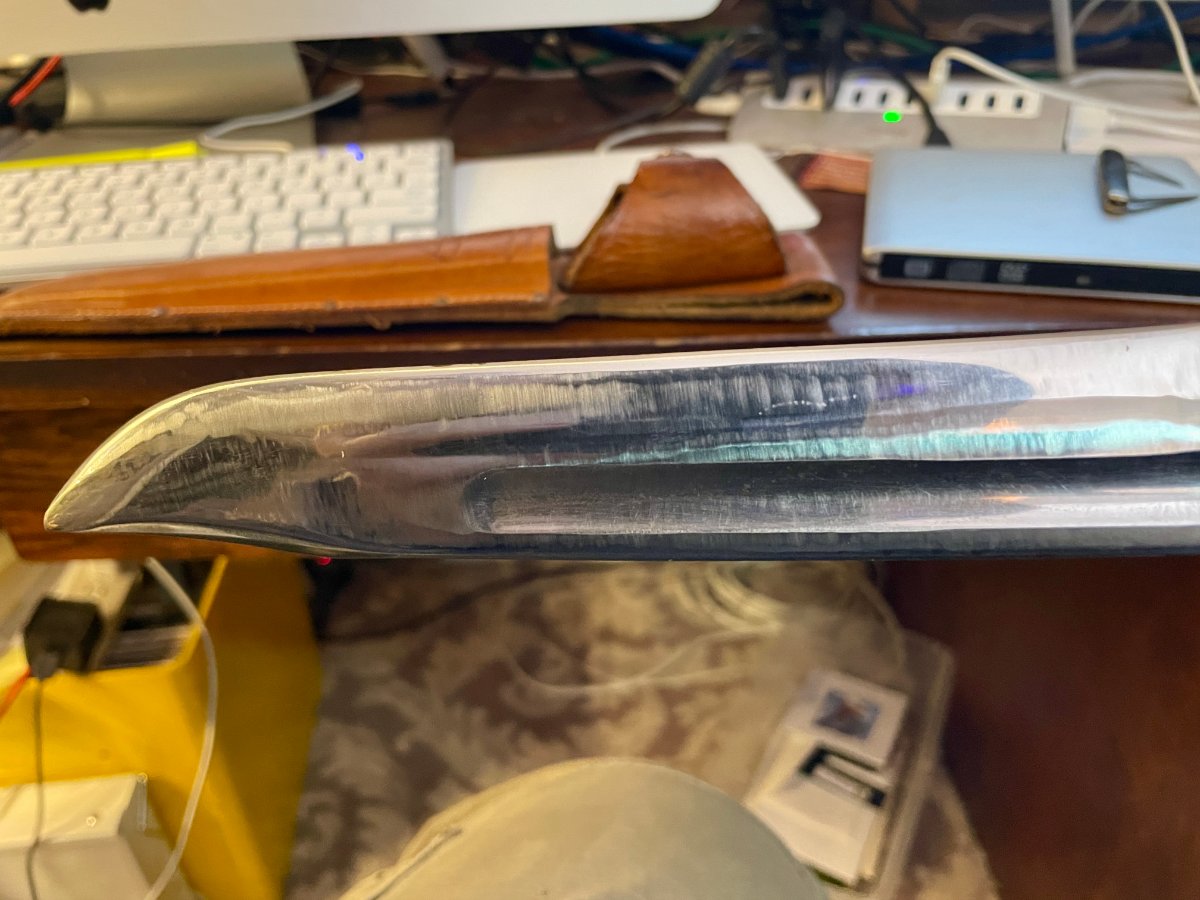

I went back to a 400 grit and did some hand sanding. I think the appearance at this level is preferable.

It sure looks good to me after your latest work on it.
Posts: 23939
Re: Need advice for blade restoring by sander belt
dbe4876 wrote: Sat Jan 13, 2024 11:29 pm I went back to a 400 grit and did some hand sanding. I think the appearance at this level is preferable.
It looks good to me as well.
