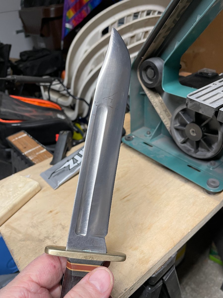

I plan to make a leather sheath for my G.C. Co 5inch stag handle Bowie (my boyhood hunting knife). However, rather than that being my first attempt at leather working, I decided to first make a sheath for another Bowie I own, an 8 inch Western knife.

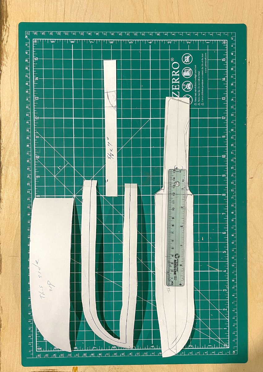

My first task was to create the paper templates that would be used to cut out the leather. Simple eh? Ha! It's been a lotta years since those high school drafting classes! What took Chuck Dorsett about 10 minutes on video took me some 2-1/2 hours and three attempts! But, I finally got my templates created.

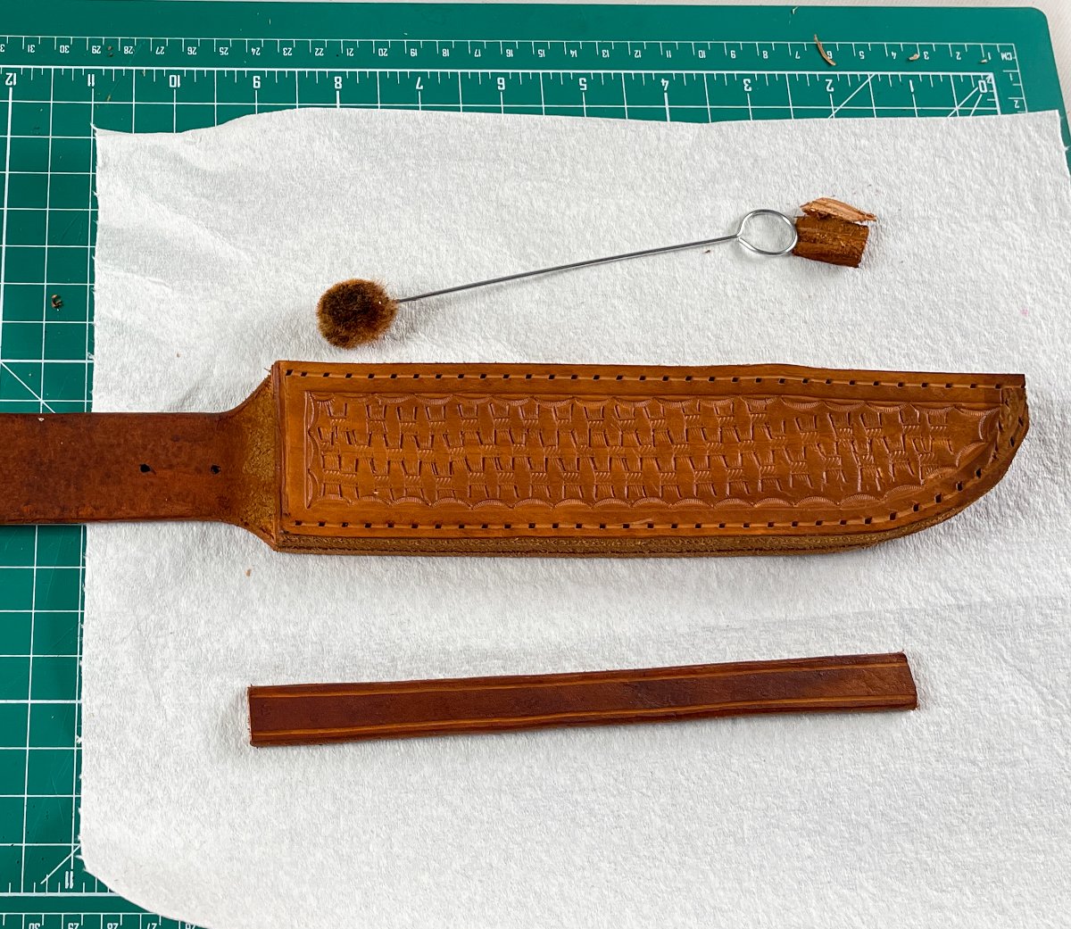

This is where some of the drama set in. I came to realize only too late, that my face piece and back & belt loop peace, were not an exact matching fit for each other. Now they were bonded, and the bottom of the back piece (blade tip area) was a bit short. And I had already put stitch holes in that face piece that were now much too close to the edge of the bottom piece. In my beginner's ignorance I tried to cut a sliver of leather and cement it into that area of the bottom piece to match the top piece. I spent a fair amount of time trying to sand it and make it work. But, it looked wonky, and I was not all all satisfied with it. After a night of sleep I decided the better approach was to just trim the sheath at the bottom and create new stitch holes there. After applying the dye and antiquing to the leather my boo boo at the bottom was not as blatantly noticeable as before. I finally decided to just live with it.

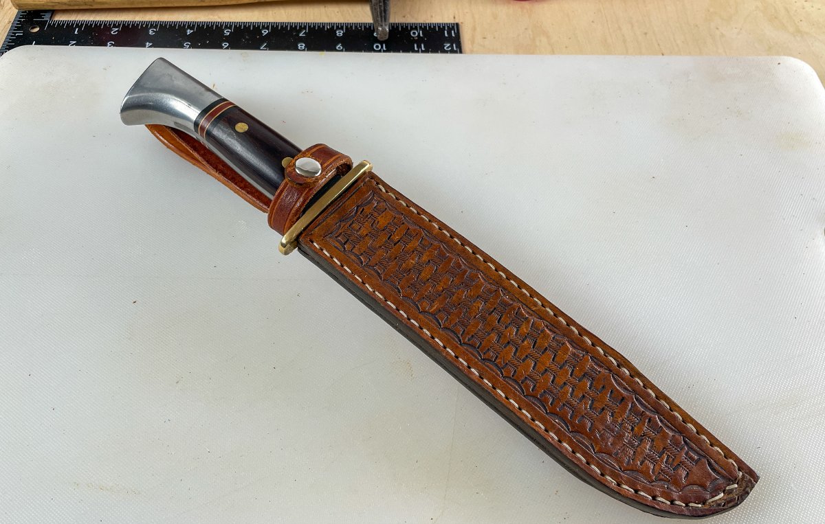

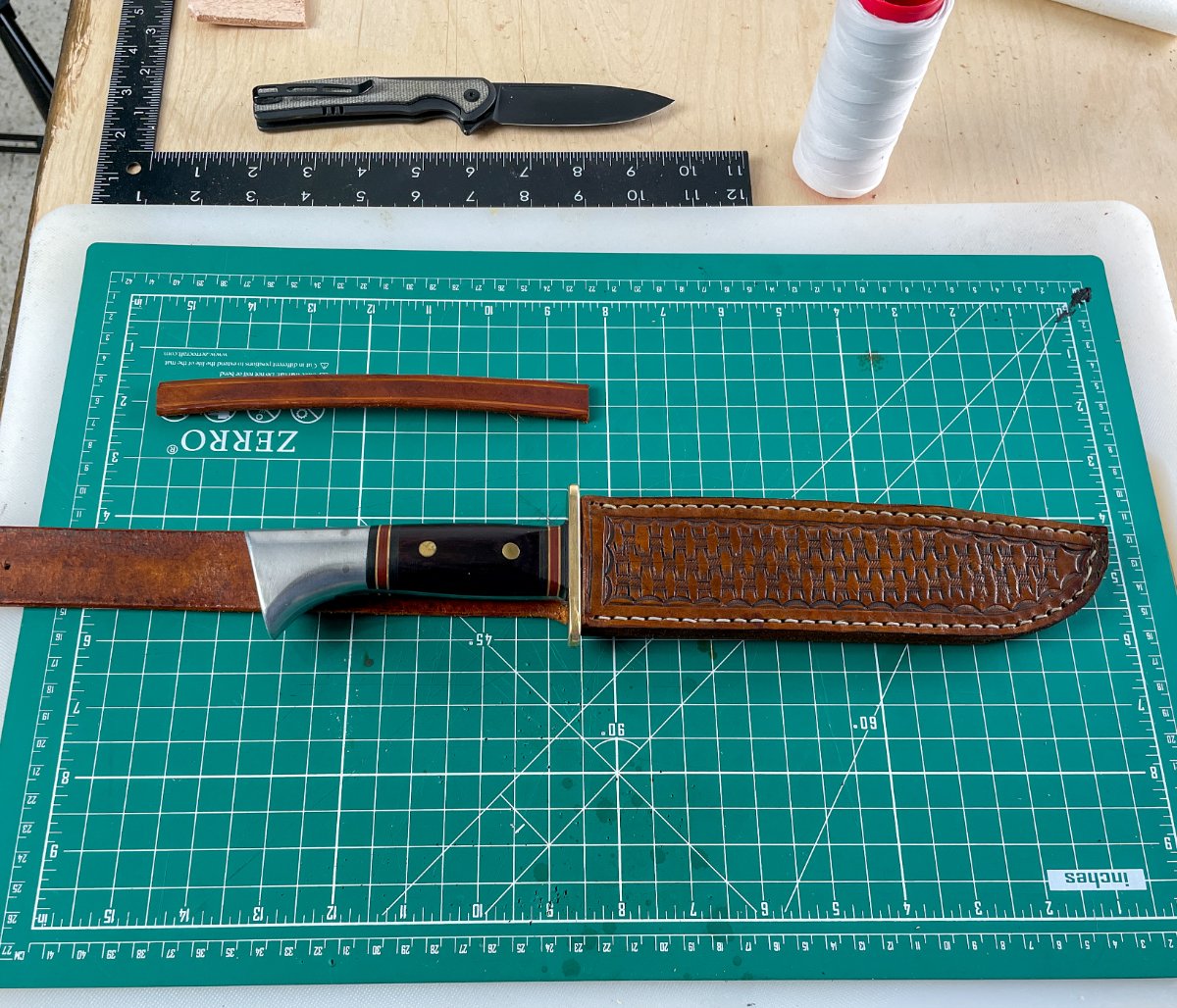

The stitching was complete, and it was now time to install the belt-loop rivets and the hold-down strap with fasteners. I had purchased a kit of fasteners from Amazon, but it was clear to me they were the wrong size and would not work. Drive all the way to Tandy again (some 17 miles)? Thought I'd try my local Hobby Lobby first. Nope. Bummer! Tried Menards, no go. "Hum...what about Michael's Craft Store?" Yep, I found a couple starter kits for rivets and fasteners. Back home the work ensued to complete the sheath. I was watching Chuck Dorsett do it on video, as I went along, to avoid doing something dumb in the process. Okay, got the rivets installed. Yay! Then came the hold-down strap and fasteners. First one went just fine. But, the second fastener presented problems. It seemed the leather was too thick for the female piece to bond with the male piece (i.e., wrong size fastener). I finally had to resort to removing the male piece (no small effort it seems), and then skive down the area so there would be more for the female piece to grab hold of. Hooray!! It worked! And just like that it was done.
It feels like quite an adventure to have completed my first leather working project and knife sheath. It was no small education either. But, it was a fun and rewarding effort and education. Now I think I'm ready to begin working on the project I most wanted to do - make a new sheath for my G.C. Co 5inch Bowie knife. Stay tuned. There will likely be another article for that one. :D
