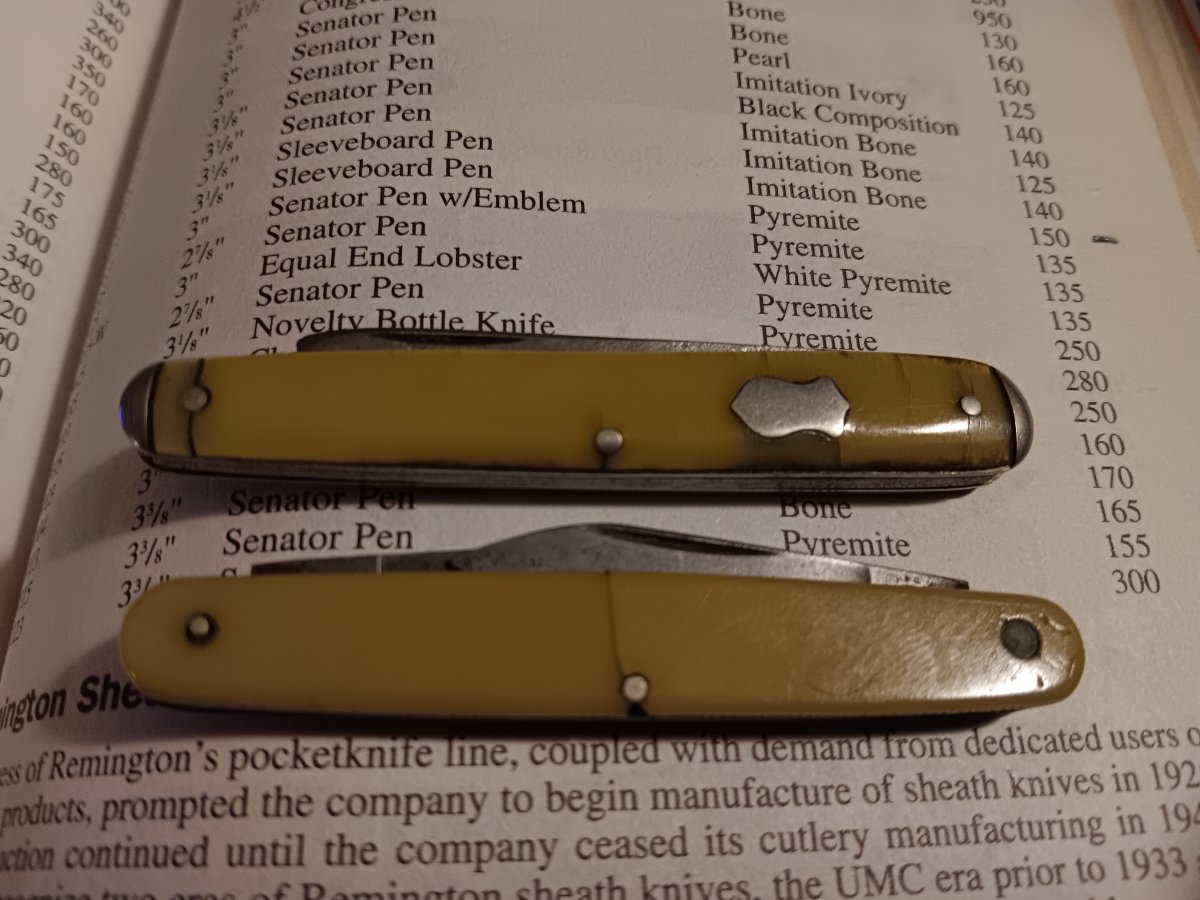

These two are Remington Pyremite, according to their respective pattern numbers and Price & Zalesky's 15th Edition. It likes to shrink and crack, but doesn't seem to outgas.

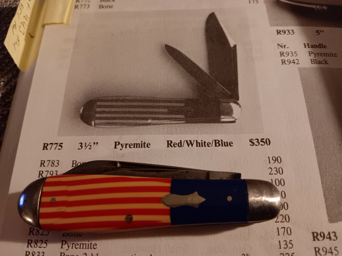

Sargent says this is Red/White/Blue Pyremite.

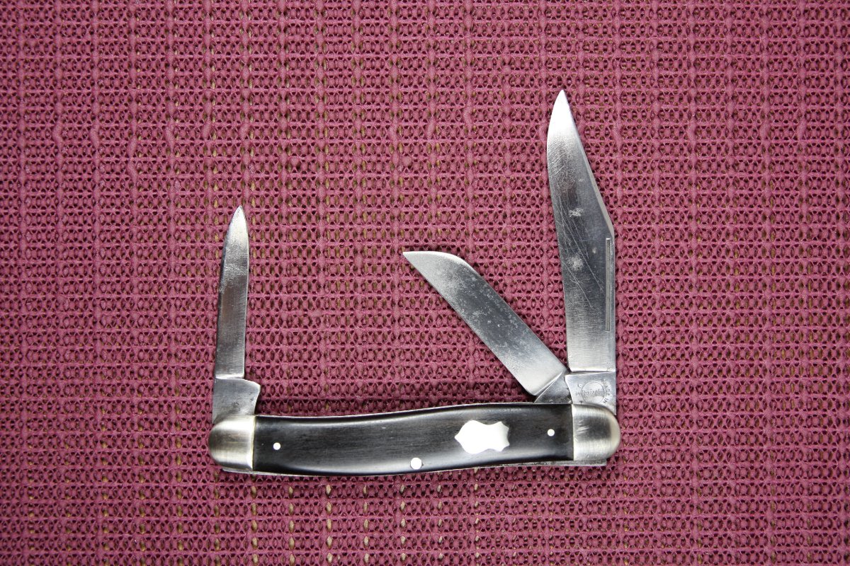

I have had a couple of Pyremite Remingtons that outgassed. The one shown had a dark swirl pattern Pyremite handle material which I removed and rehandled with ebony.

Before pictures in link below. Note rust line on blade. I was thinking this one had the dark handle material, must have been the other one.

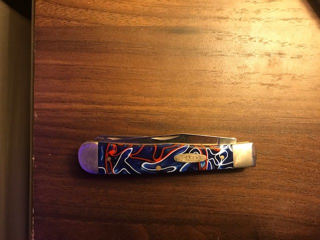

Do any of the knife makers use celluloid anymore - here is a newer Case, looks celluloid, surely, they know better now!?

enuf wrote: Wed Feb 14, 2024 4:48 am Do any of the knife makers use celluloid anymore - here is a newer Case, looks celluloid, surely, they know better now!?
That's not celluloid. Case calls that Kirinite. It's an acrylic material similar to what Frost calls Corelon, which you asked about in a recent post.
No, it doesn't shrink, crack or outgas like celluloid. At least not that anyone knows - maybe when it's been around 100+ years we'll know how it holds up. And there will be a bunch of wise-guys wondering why they ever used the stuff. :roll:

I thought I was getting this Celluloid figured out but this Case - it sure has the same look - at least to me. ::facepalm::
