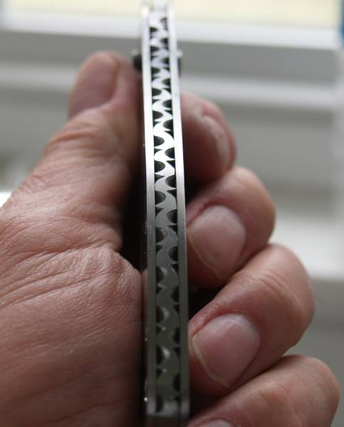

first try at file work ended in near disaster. I did not fit the spine to the knife before doing the file work. Hope someone gains from my mistake. I had to grind all my work off and do it all over. Will hope to do a better job on the second attempt.

looks good, yep, I almost always grind the backs down with a 400 grit belt before fileworking to make sure everything is fitted right, unless it is obvious that everything is flush.

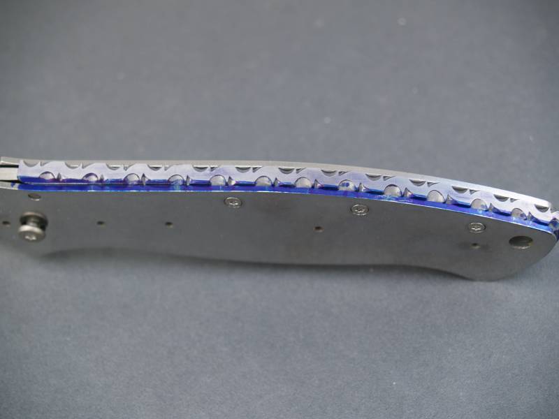

Rev b. Fooled again. Thought it would be easier the second time but after grinding down to proper surface, only half of the existing work was completely gone. Some of the previous work remained and I had to re file over and recreate new. Heck of a mess. Only consolation; it looks better than it did sticking out the knife.

i think it looks great...

looks good now
