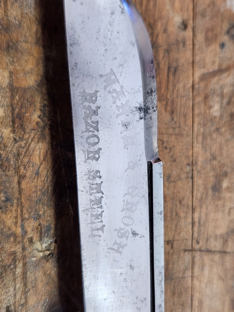

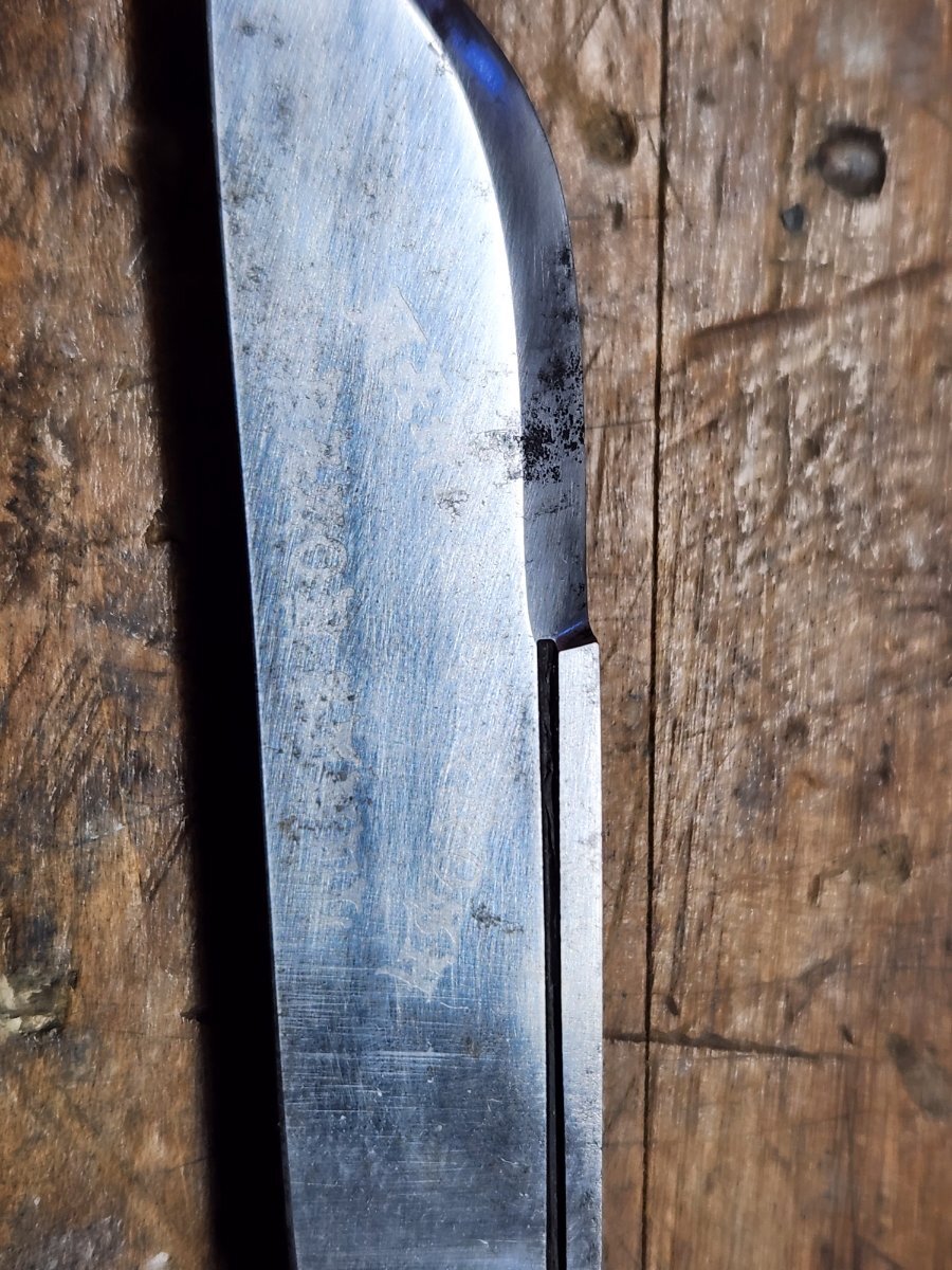

peanut740
Posts: 8124
Re: Will Flitz Remove Blade Etch
Post by peanut740 »
Before and after.
Roger

peanut740
Posts: 8124
Post by peanut740 »
Gunsil wrote: Tue Feb 20, 2024 9:51 pm Hi Dan,if it is a mint etch that is grey, flitz or simichrome will remove the greyness. Never use those on a knife with a nice grey etch.
Well Gene,I just did.Etch shows up much better than before. ::sotb::
Roger

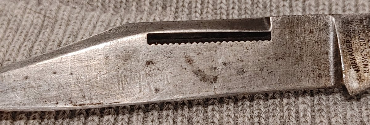

Pile Driver
Posts: 367
Joined: Mon May 15, 2017 5:18 pm
Location: North Shore MA
Post by Pile Driver »
I'll use this Krakauer stockman as an example, I believe this to be acid etched. Is this a candidate for a manual application of flitz with a microfiber cloth?
peanut740
Posts: 8124
Post by peanut740 »
Pile Driver wrote: Tue Feb 20, 2024 11:03 pm I'll use this Krakauer stockman as an example, I believe this to be acid etched. Is this a candidate for a manual application of flitz with a microfiber cloth?
Should make it more visible. ::tu::

Waukonda
Posts: 6356
Post by Waukonda »
peanut740 wrote: Tue Feb 20, 2024 9:30 pm Before and after.
Nice, Roger. Was that with Flitz? Just a light application?
Ike
peanut740
Posts: 8124
Post by peanut740 »
Waukonda wrote: Wed Feb 21, 2024 12:26 am
Yes
