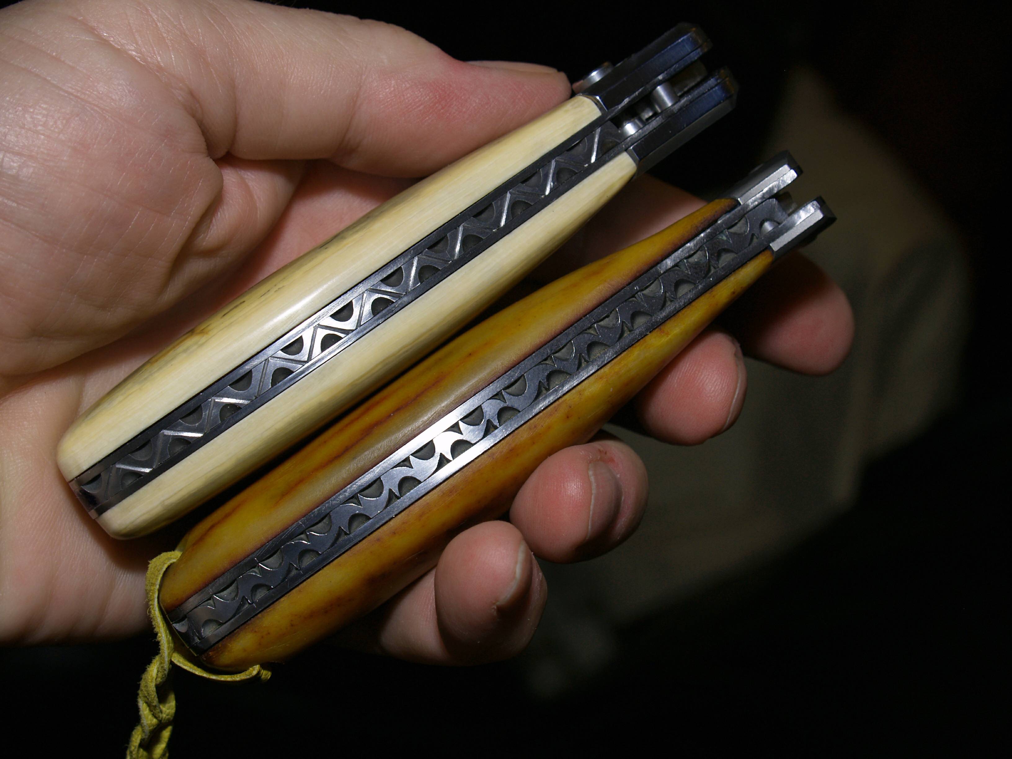

Got the studs and the Rubies are in the mail. finished the Sambar stag and filework and decided to try some teepee style on another knife.
love to learn, live to learn

very impressive!

I think mike here has been holding out his talents on us

I am flattered beyond belief by your responses. I would never have tried to do these things without the inspiration of talent displayed on this site. If there is a lesson to be learned it is not to be afraid to try and fail. God knows I have sufferd some disasters and always changed my diapers and jumped back in. I have no desire to get commercial with this, I'm having too much fun. I am ending up with a lot more knives than I can possibly use so the future of these things is a large ?? What in the heck to do with them,,, Well I have decided to give them to the ones I love. I have 4 brothers, son-in-law and grand kids who will be the beneficiaries. Nice to have all this time on my hands.

Beautiful work Mike. And by the way, I'm available for adoption!

Those look just fantastic! What do you call both of them. The top is Teepee and I don't know what you call the bootom one. I've seen it before, but I can't think of it.
Thanks for showing those, they look great!

What is it called?, Haven't a clue. Took me 3 weeks of planning/thinking about it to try it the first time then had to grind it all off and start over. It was a heck of a lot easier than the teepee tho. Glad I did the first one (the name "vine" comes to mind) before the teepee. My primative skills at precise filing were really challenged but I feel better now. More confidence is a real asset. Learning to recover from disasters is as great an asset as the inspirational images on this website. I would like to take pics and show the steps of how I did it, particularly the planning and tools I used. Maybe someone out there could benefit. I feel guilty suggesting that since I've only done 3 file work projects but to the person who is intimidated, like I was, maybe it would help.

Who hoo!!! Great lines Mike.
I really, really like those colors. The bottom filework is going to make it onto the next knife I work on...if you don't mind me copying the design?
The more I see your guys bone, stag and reconstituted stone - the more I realize that I have to start using that stuff.
Keep posting more Mike.....and a tutorial on file work is an excellent idea.

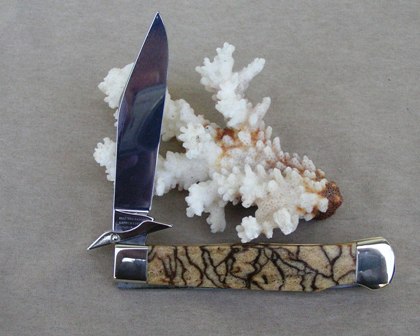

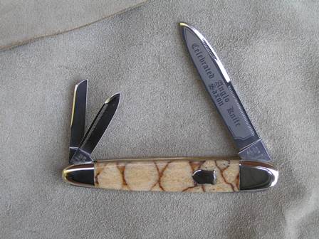

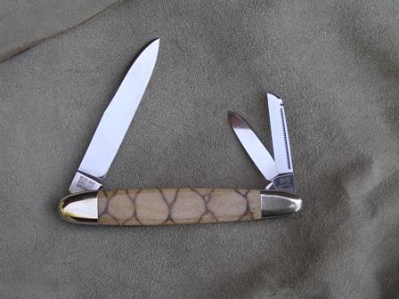

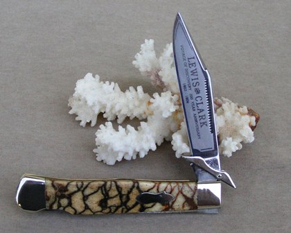

My favorite material I believe and worth evry cent. What you get from Culpepper will be vastly Superior to what you use on factory knives. I just bought 2 sets of scales Monday morning. Tell Joe Culpepper that it is the first time using this material and to fill you in. Wear a respirator and use a light coat of el cheapo brand of super glue when you go to buff so that the black buff does not end up in the coral, which is a porous material and WILL collect they ugly gray residue from buffing. They may have another method by now.pmike5869 wrote: Next try is Tiger coral. Just love the looks of that stuff.
Seems like the smaller pieces have better pattern. I also have the same knives with Apple Coral. Jeff Jones did these for me, until I figured why should he get all the fun.
- Attachments
- A big piece of TIGER CORAL on an ANGLO-SAXON
- P4010003 - Copy.JPG (38.09 KiB) Viewed 3826 times
- P4010005 - Copy.JPG (35.74 KiB) Viewed 3826 times
- A Medium piece of TIGER CORAL on a Lewis and Clark Swing Guard
- Lewis and Clark Swing Guard Tiger Coral Custom 001 - Copy.jpg (43.25 KiB) Viewed 3825 times
- Lewis and Clark Swing Guard Tiger Coral Custom 002 - Copy.jpg (40.2 KiB) Viewed 3823 times
