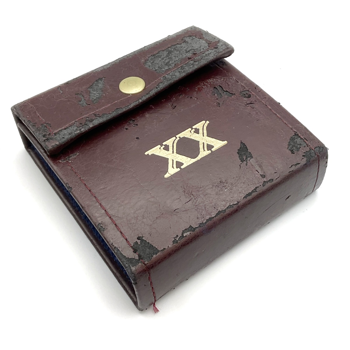

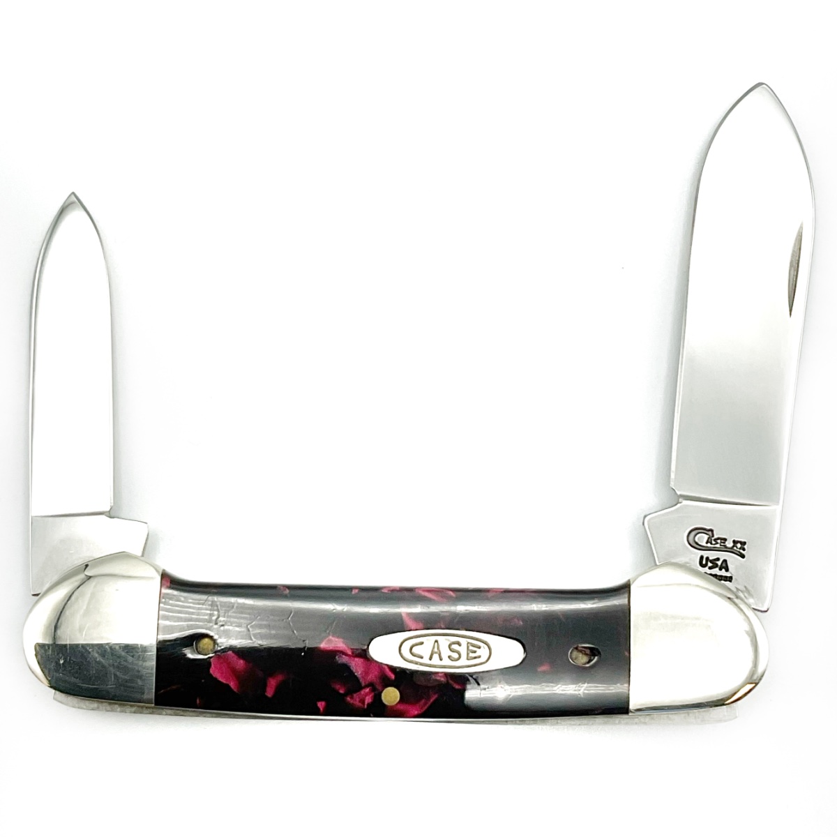

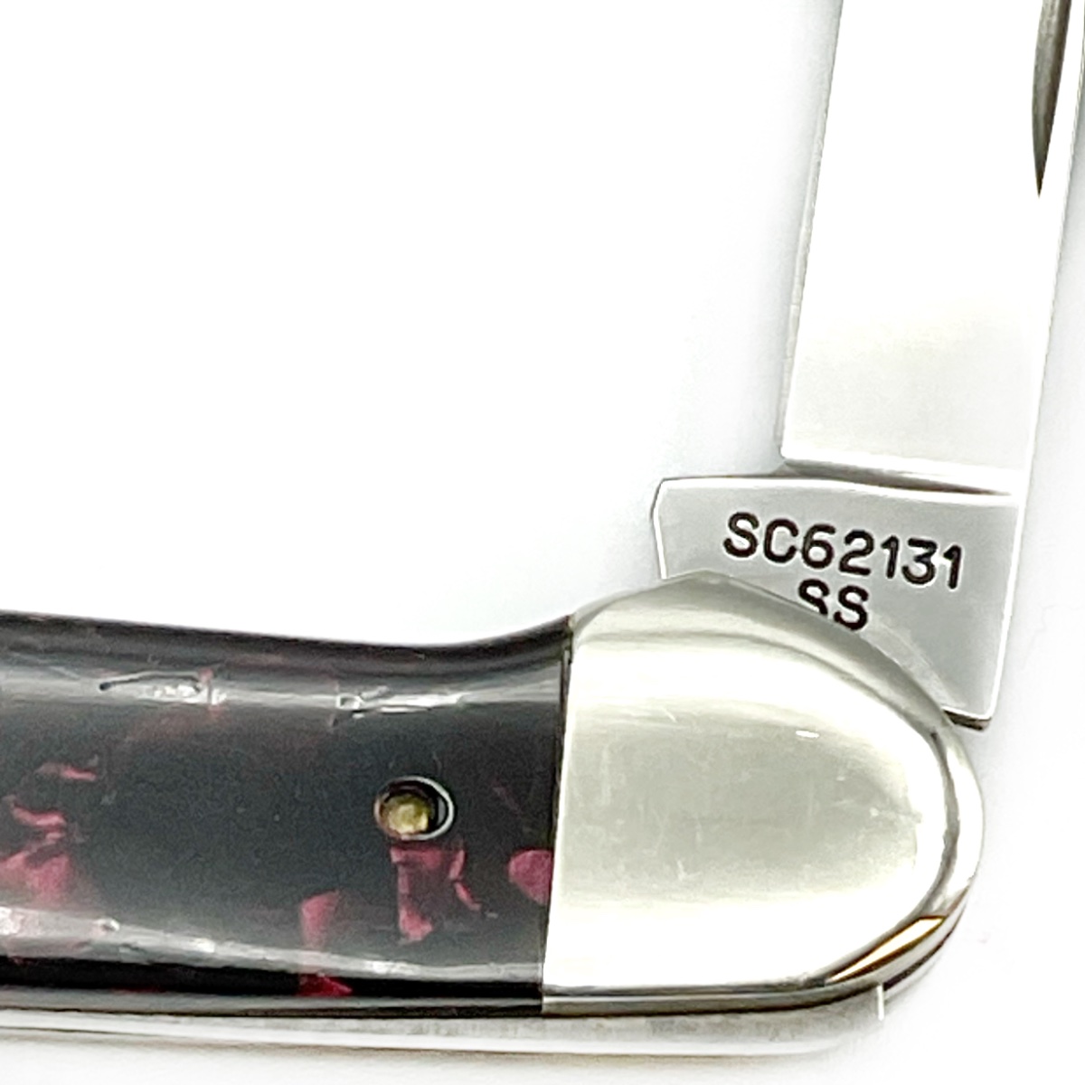

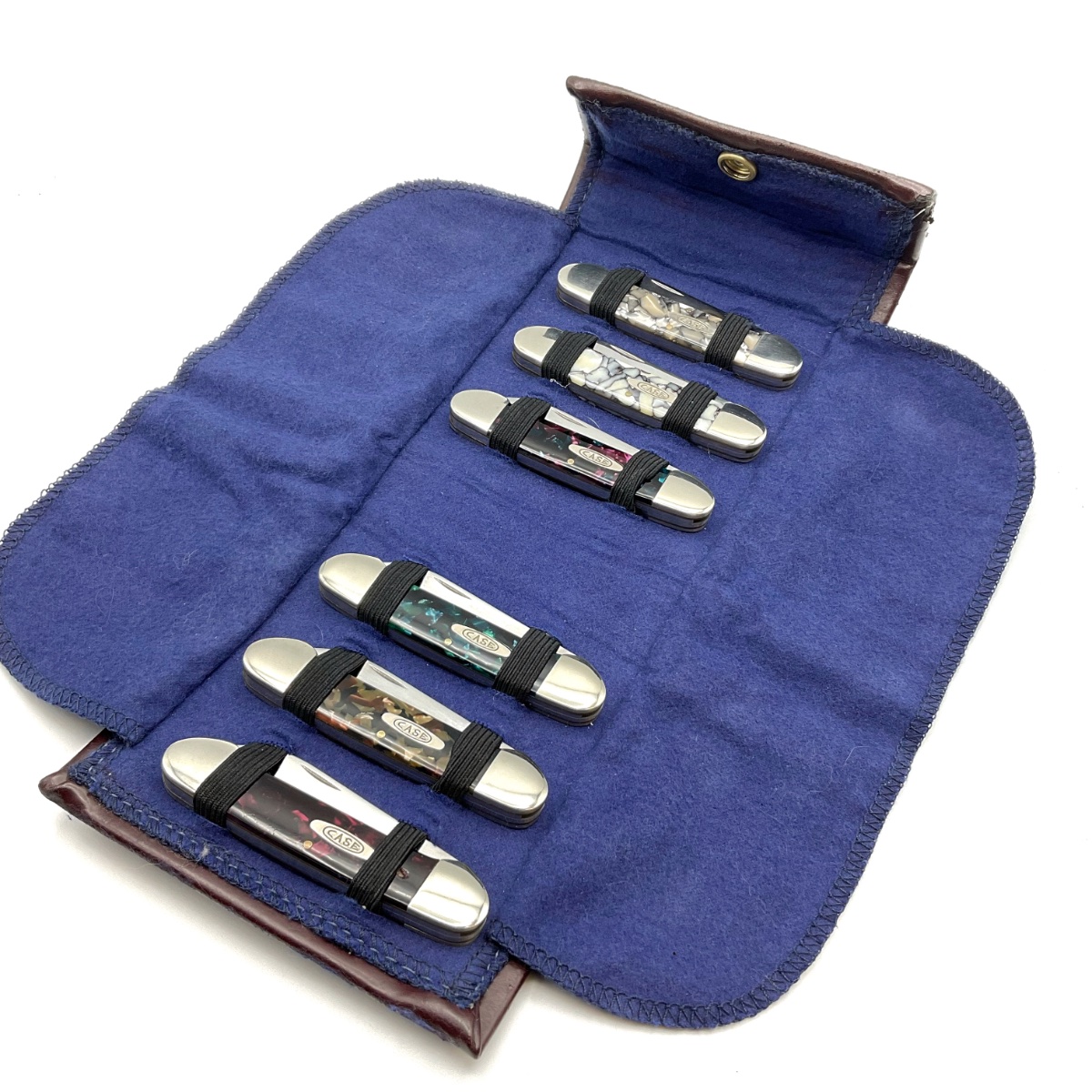

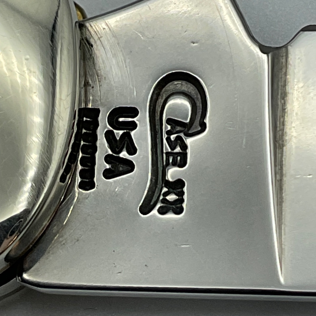

Trying to determine if these 6 canoes are Salesman samples/value. If I am reading tang stamp correctly, they are 1993. Unsure about the SC before pattern #. SC62131. Any guidance appreciated!

I believe SC means second cut, but no idea why the blades are in those frames with those handles. Left over parts put together to make knives? Hopefully Steve will see this and give his opinion. Interesting.

I don’t try to keep up with post-1980 Case knives and the thousands of made-for-collectable variations. Case Collector’s Club and knifedb.com which are excellent resources, the only knives having SC prefix are Second Cut stag or bone. I found examples of SC62131 from 1993 but they all have either the early 1993 date stamp (the actual date, not dotted) or Roman numeral dates (which were a SFO for Frost Cutlery). I found no other SC62131 examples having a 1990s date code. I found nothing from any date to explain knives having SC prefix with anything other than second cut bone covers.

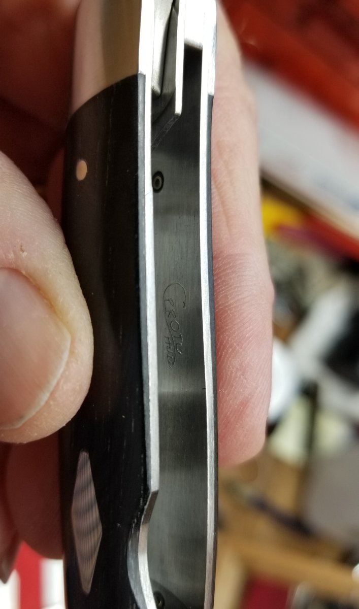

At least since the 90's Case made prototypes are stamped on the inside of the brass liners with a long tail C and proto spelled out.

One thing that might have helped start the rumor that Carolina Case's Canoes were salesmans' samples is the the storage case they are in. During the 1980s and into the 1990s many sets of knives were sold through knife collector clubs in similar brown vinal cases. Whether the Canoes left the Case factory in that case is a good question. Even if they did, are any other sets of knives in those brown vinal cases known to have been salesmans' samples?

I have sent photos to Shepard Hills. Will post what I learn. There are no other markings on blade like peanuts. Will check the other knives to confirm. Wasn’t trying to rile anyone, just newbie asking for help.

I DO NOT HAVE ANY INFORMATION ON THESE KNIVES. The one with the SC62131 SS says it is a second cut bone handle. But the knife is not a
Bone handle. I tried to look on the internet and this was all I could find on this one knife. We did not start doing business with Case until 1996.
