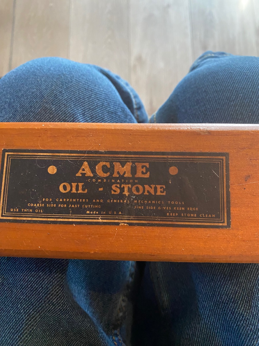

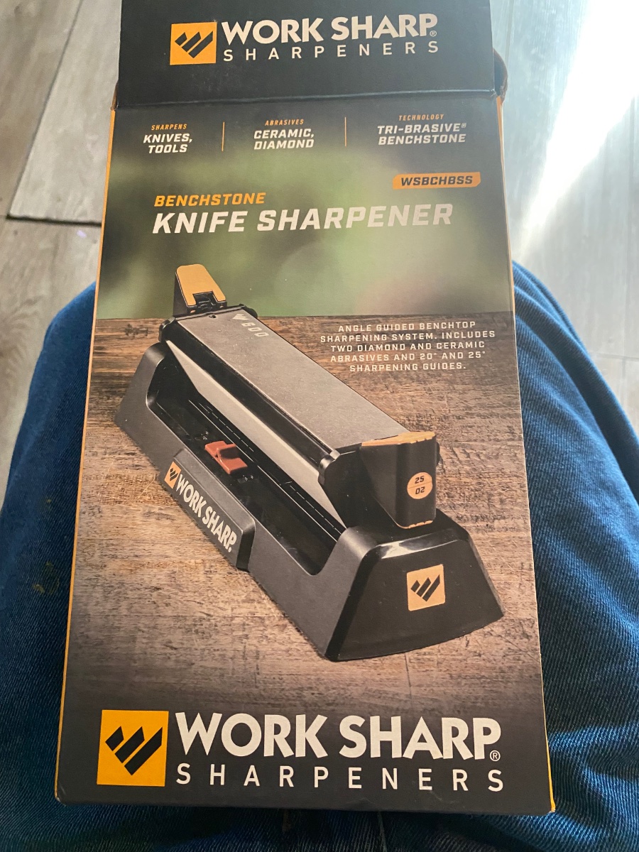

This is my favorite stone .Has one fine side , one course side.I Use Lucas extreme gun oil to keep it oiled well and working smoothly. Like Ken already mentioned some of the new stainless are hard to get sharpened.For those newer type blades I use a ceramic diamond stone .Mumbleypeg wrote: ↑Thu May 30, 2024 5:15 pm Good move to get away from pull through sharpeners. I’m not familiar with the Benchmade model you have but I suspect it might be stainless steel, and many blades made from modern “super steels” are difficult to impossible to sharpen using conventional natural or “carborundum” style stones. They need diamond stones.

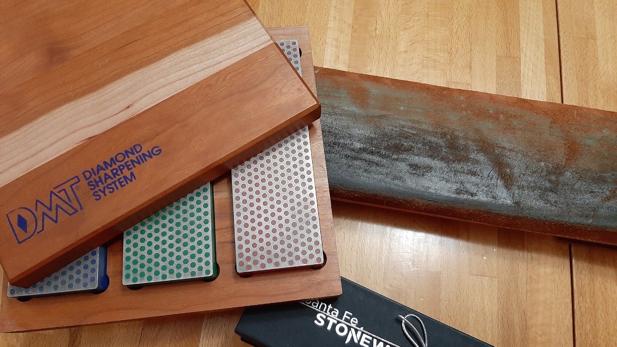

Strop more, sharpen less. That is my maxim. The diamond blocks here changed my life, left stones behind. Easier, quicker, flat no dips. Hit the blocks maybe once a year. The strop is a 2x4 with a scrap of leather and 10 dollar green compound. Use it all the time. A few swipes now and then if I decide to carry it and it shaves again. Once you have a good edge, you can strop regularly and the edge comes back to shaving sharp with barely any metal removed. Hope it helps.

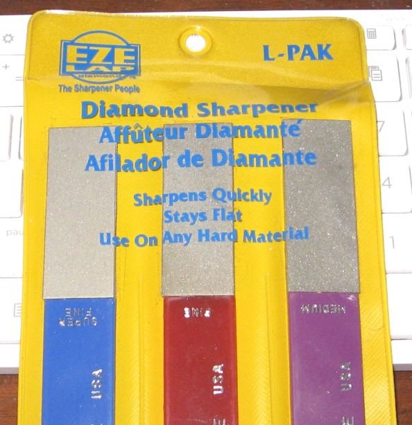

Forget the stones. Use these instead.
