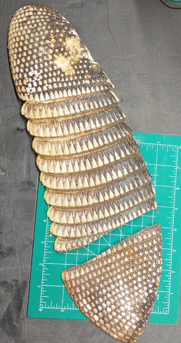

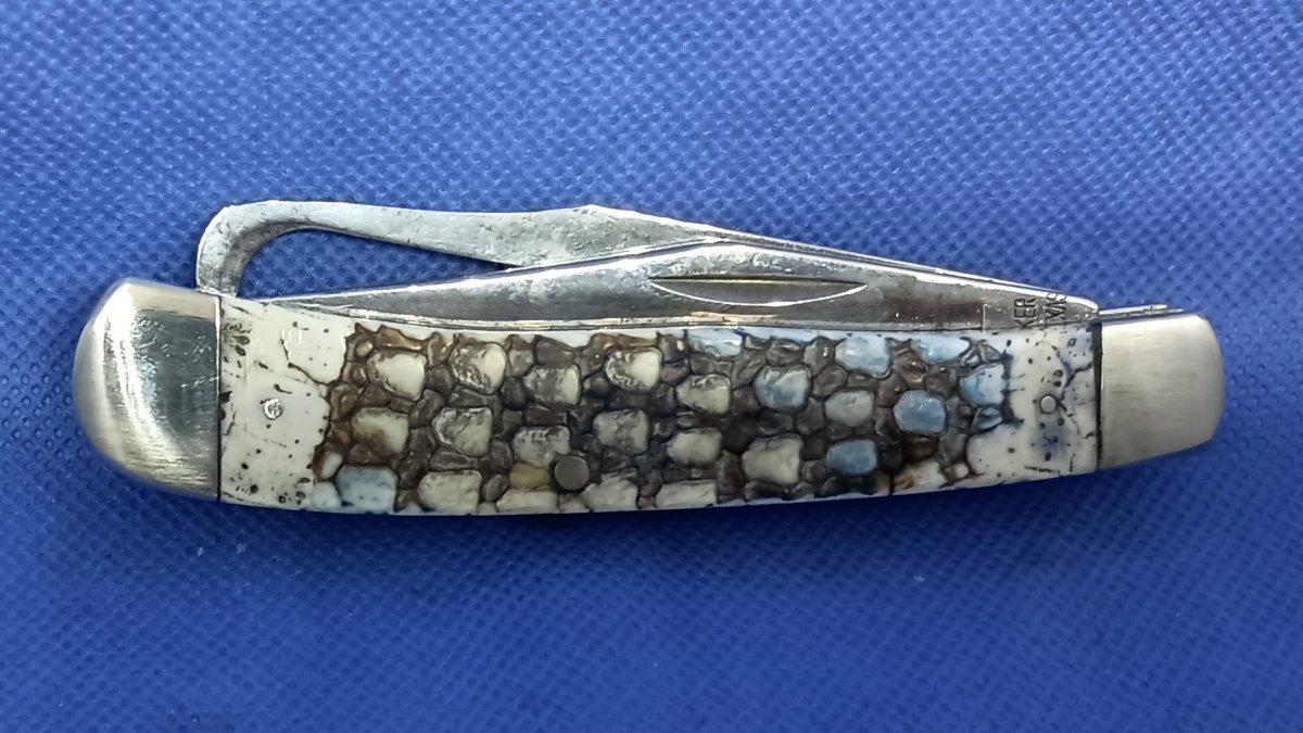

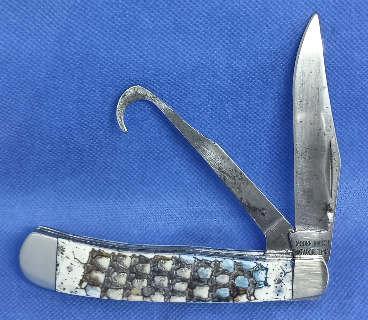

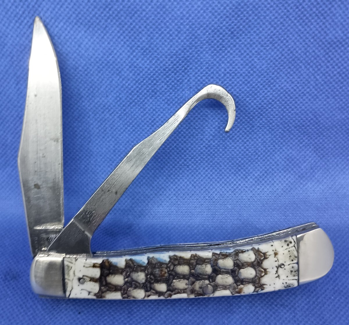

I finished an experiment today:
A Moore Maker 3208 Trapper with Hoof pick, rehandled in Armadillo armor! I was just experimenting around with some Armadillo Armor (responsibly sourced from a renewable, local supply!).
First I cut off a piece and dyed it blue. It had a decided curve to the piece, so after soaking it in the dye for a while I placed it between two boards and clamped that in a vise for a week to dry. It remained very flat after that. The knife originally had yellow plastic scales, but the front one had come off.
I replaced the scales without disassembling the knife. I did take video of the process, and should get that posted up in a month or so. I was very disappointed at first as the outer layer kept coming off the hide, taking that lovely blue color along with it. But I was doubly surprised how nice the shell appeared after sanding it. The original grey color is so ugly, but once that outer layer peels off the under-layer is varied in color and still has a texture that provides a good grip. I did have to go over it with a torch to get rid of the tiny prickly hairs that covered it, but after that I am very pleased with the results. There is no bad smell or weird feeling in the hand - it feels very much like bone.
I fully expect to handle more knives in Armadillo in the future, but I will probably not dye them, unless I try it after the pieces have been shaped and sanded.
Experiment: Success!!!

Armadillo!!! I thought they were only useful as speed bumps. Knice job.Reverand wrote: ↑Sat Sep 07, 2024 9:31 pm I finished an experiment today:
