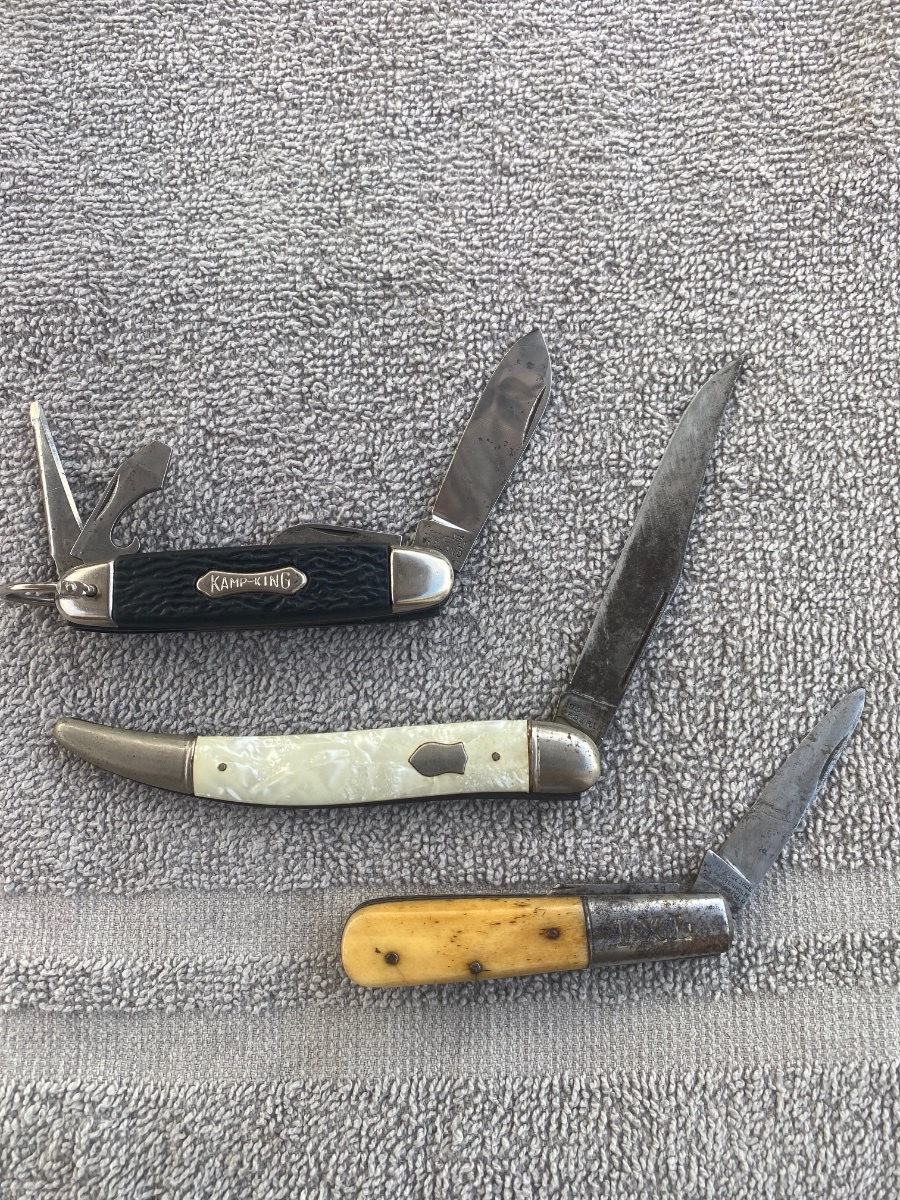

I picked up this old Barlow knife today. It’s an I*XL, George Wostenholm. Made in Sheffield, ENG. It appears to have either bone, or steer horn scales. I’m told it’s pre civil war era.
I know they didn’t add ENGLAND to the tang stamp until 1890, but mine has ENG.
Can anyone help provide any info on approximate age and value? Thank you!

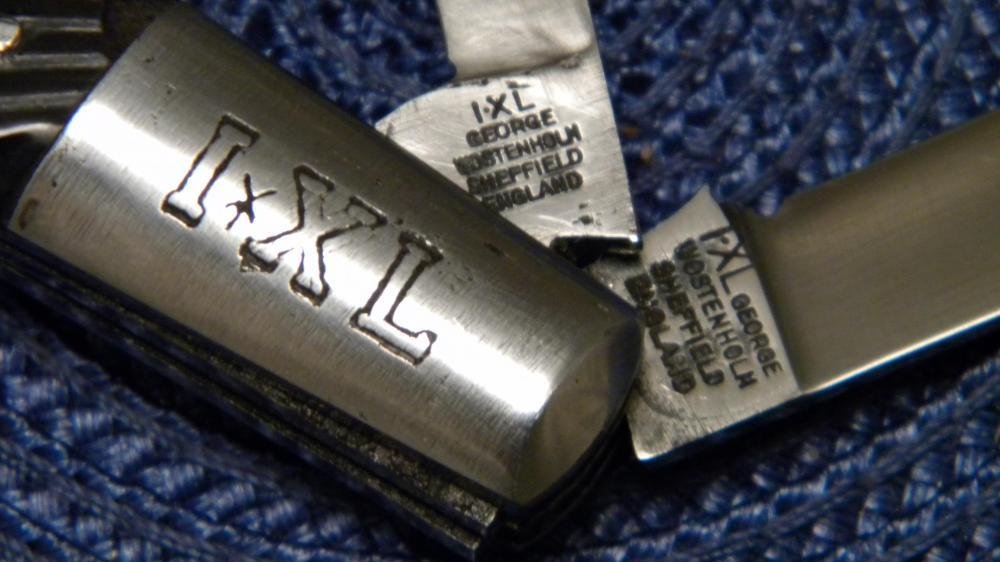

Judging by where the ENG is positioned on the stamp I'm sure it said ENGLAND at one point, otherwise it would be more centered. Probably just worn off or obscured by the spotting.

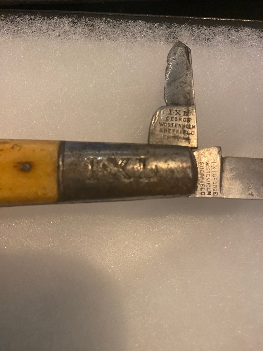

I took a closer look with a loupe. The stamp is the same on both blades, ENG.

New to this wrote: ↑Sun Sep 22, 2024 1:45 amI took a closer look with a loupe. The stamp is the same on both blades, ENG.
The rest of the word is probably worn off from wear and tear on the tang due to many opening and closing cycles. This is what it would have looked like:
