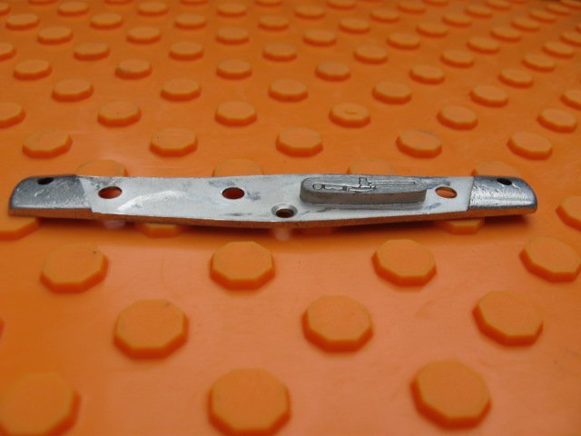

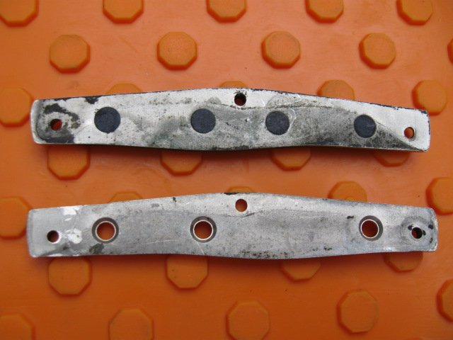

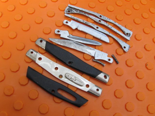

I don't have an answer to your question but just a heads up that those black sawcut handles can be a challenge to remove because of their indestructible construction. It can be done but it's kind of a PITA.
The handle slabs start off with "posts" on the backside. The posts are placed through the holes in the liner and then melted and sanded smooth. The little ridges inside the liner circles "lock" the handles in place to keep them from separating from the liner. You'll have to slide a sharp, thin object between the handle and the liner to cut the melted posts in order to remove the handles. The shield is the same piece of steel as the liners and bolsters.

The knives with the oblong shields like yours have the pillar shields, in the case of a 307 the pillar shield knife would have three springs. The older knife would have an oval shield and two springs. These knives have a glued-on sheet metal shield.Railsplitter wrote: ↑Sat Nov 16, 2024 4:18 pm
The older knives have the scales attached the same way, but the adhering posts are smaller.

Thanks to all of you for your replies. I always learn something new on this site. I did not know that the knife utilized a pillar shield and that funky way of attaching the Valox covers to the liners. It sounds like I will need to CAREFULLY disassemble the knife and cut the Valox away from the liner. I can then use it as a pattern to make a new cover if I ever find the black Valox.
