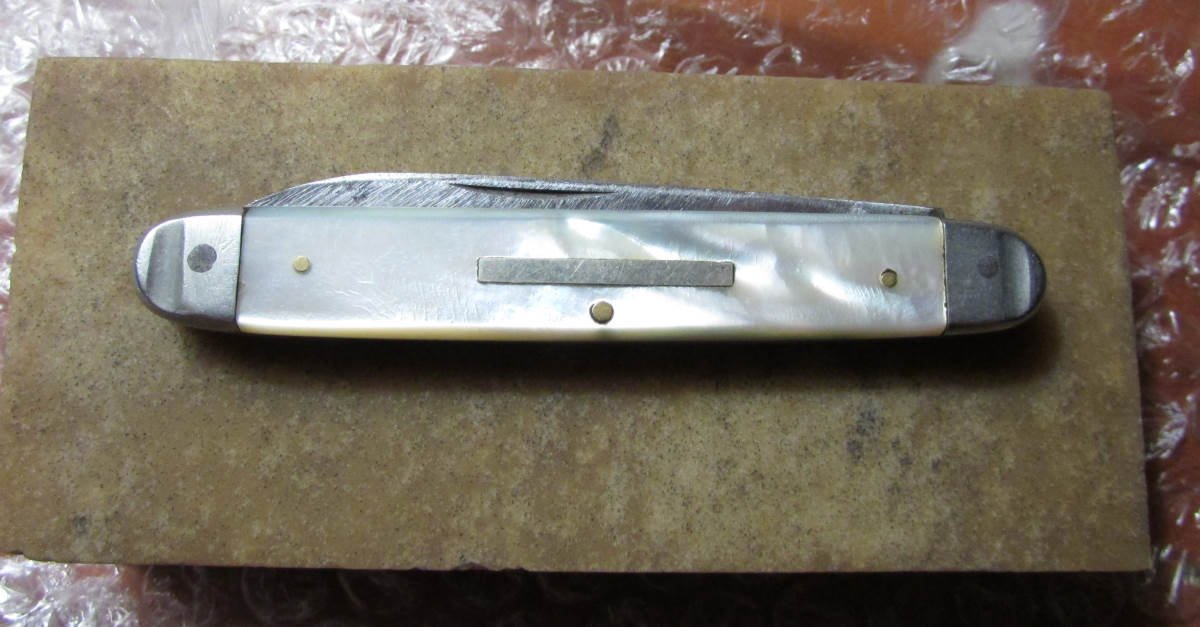

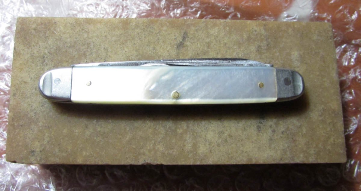

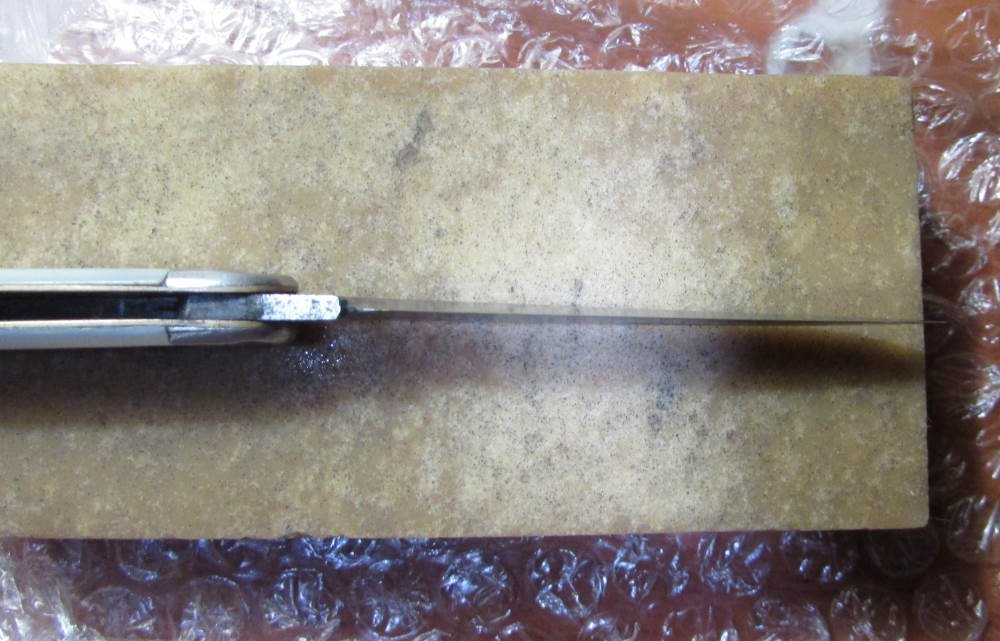

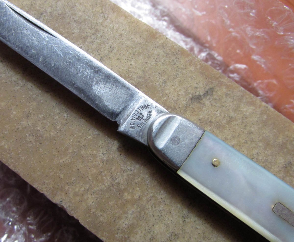

Hi, yesterday I picked up a very cute knife with mother of pearl. So far I have only found that Ed. Wüsthof stopped making folding knives in the 70s. Has anyone found a timeline of their stamps?
It is the size of a regular Victorinox, the blades are curved to fit on 1 spring. The central thickening of the spring has a bevel so that the main blade does not become blunt on the handle. Everything is still very well adjusted despite the wear. The axle pins are made of steel. I got it for $30, I think it's fair. I would like to know the approximate production time
https://youtu.be/mExgWJTGXss

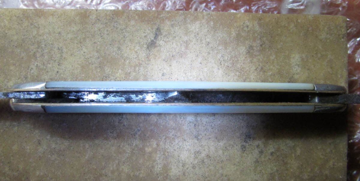

When I got it, the first thing I did was drop it on the asphalt and got a pretty big burr on the end of the bolster, the small blade wouldn't open because of it, I had to cut that piece off with a Wenger can opener 8)

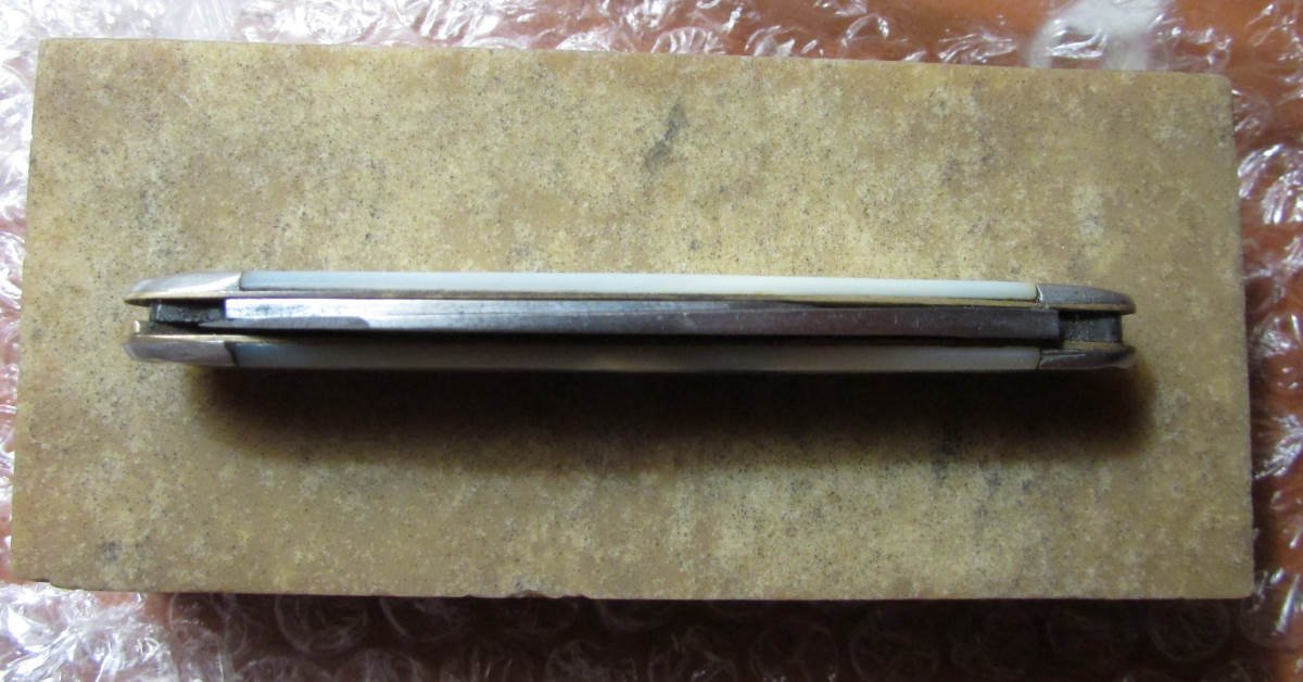

Someone dropped it or picked it up with something before me, so the main blade can rest against the closing small blade. I'm thinking about how to straighten the handle so that the main blade moves to the side, as it should. I suppose that I just need to hit it with a hammer in the right place, but I don't know where and I'm afraid of ruining the scales

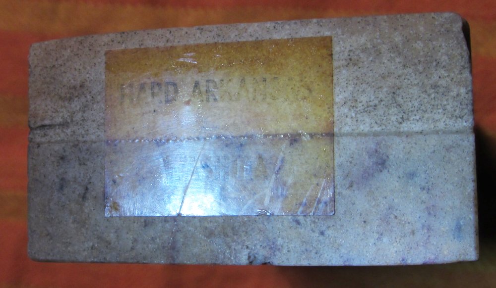

If you hit the knife with a hammer I hope you remove it from that white hard Arkansas stone so you don't break both of them.

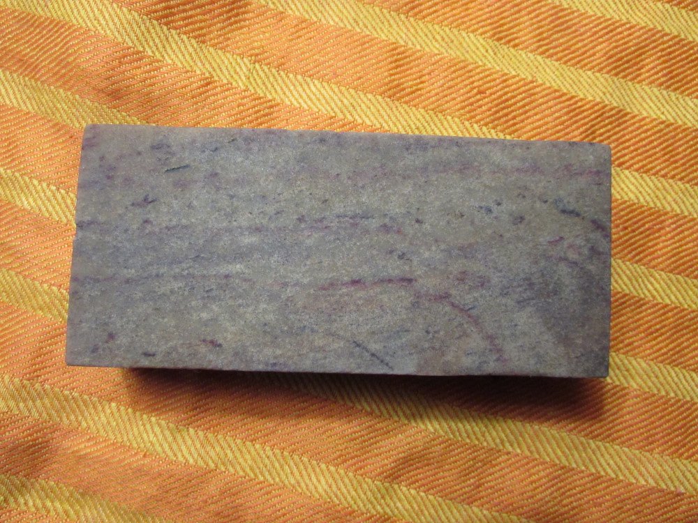

This is not quite Arkansas, it is a two-layer glued stone, with a Washita on the underside

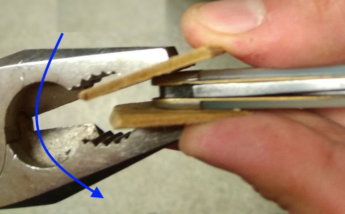

Okay, I didn't hit it with a hammer like Tony Bose did in his video, just used pliers through a strong cardboard spacer. I bent and bent the bolsters, and eventually the tip of the large blade moved away from the base of the small blade and it developed a snap. It looks like someone had deformed the knife earlier and something was preventing the spring from working properly. I didn't move on because the best is the enemy of the good + I was worried about the integrity of the MOP scales
That's how it was
https://youtu.be/l4nmEZ1CuOM
And so it became after crimping and turning the bolsters
https://youtu.be/npe4ncwwuzE
In all fairness, this is only half the job; we still need to rivet the axle to secure this position
