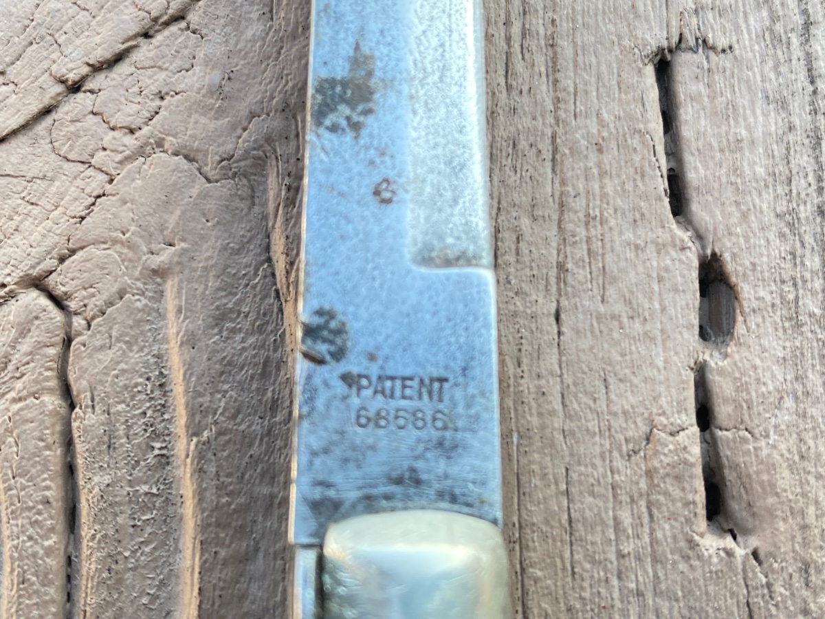

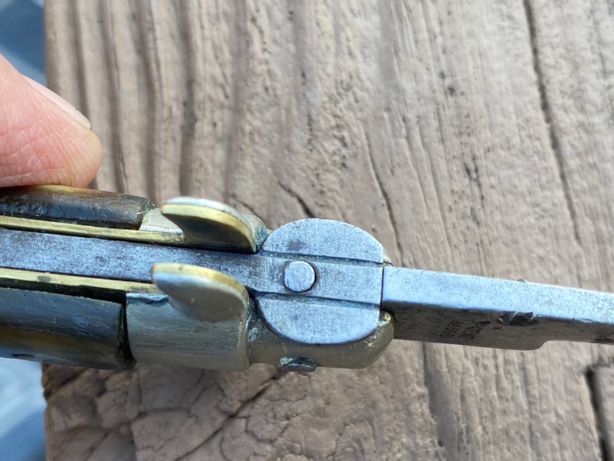

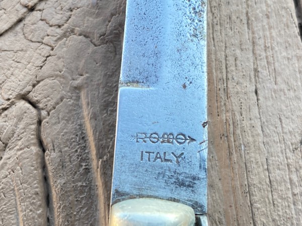

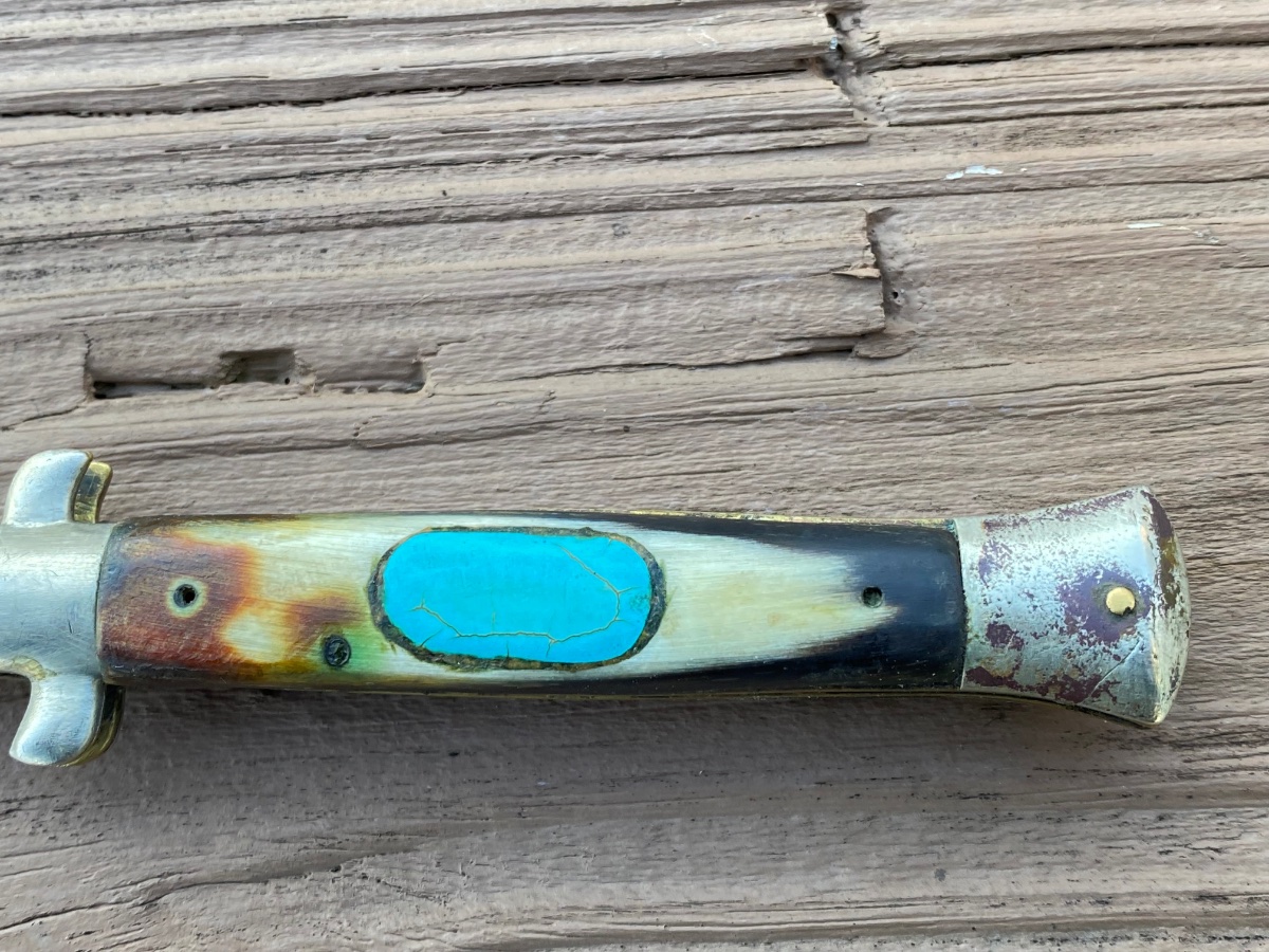

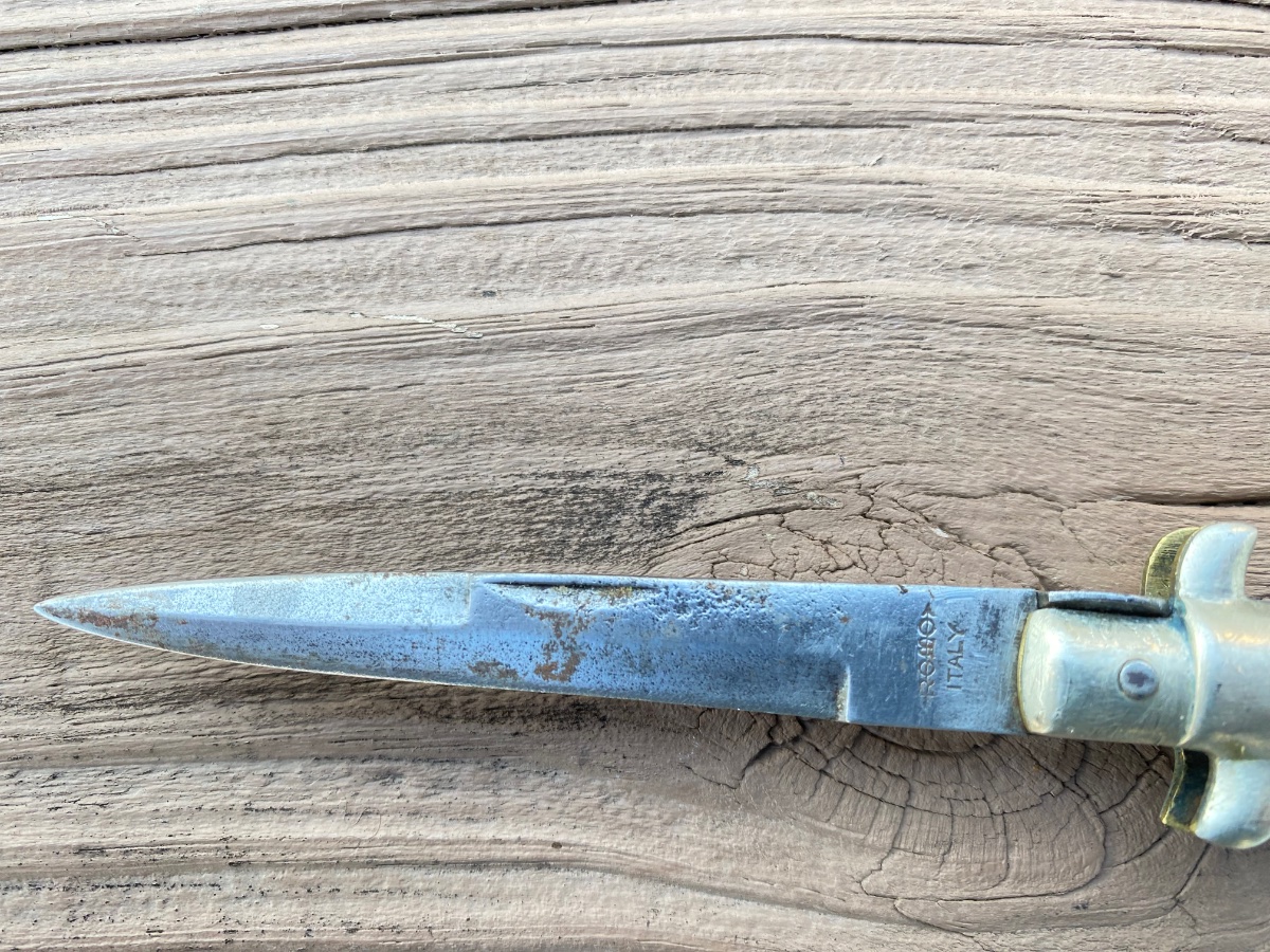

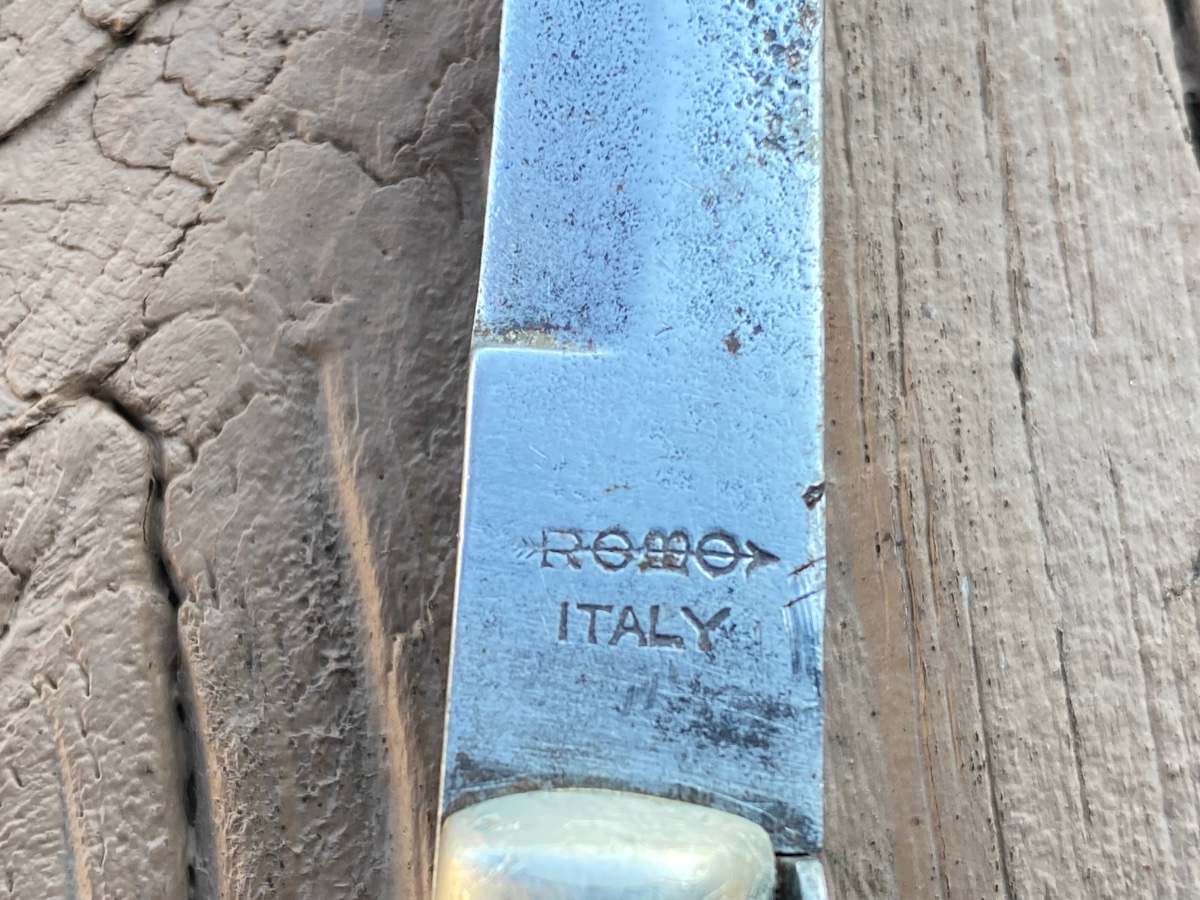

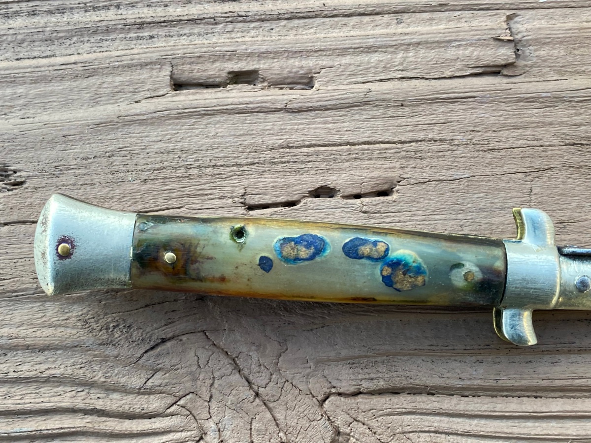

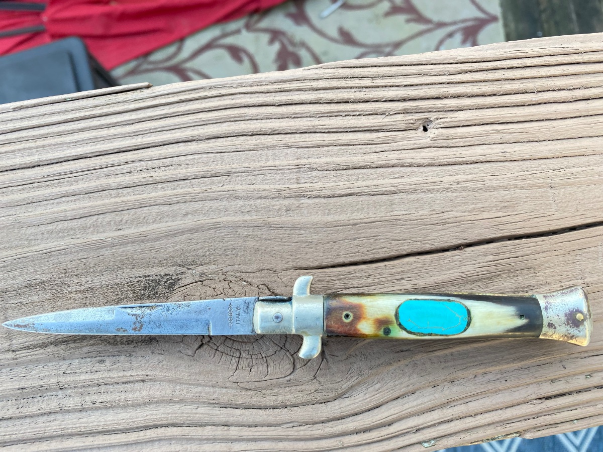

Looking for some info on this old knife. I am unable to figure out how to close it. The person I bought it from a while back called it a “picklock” and he was able to open and close it several times but I cant fugure it out for some reason. I am also looking for general info on this knife as far as collectibiliry, possible value etc…Goins shows Romo Italy knives dated as far back as 1917. Any info is always appreciated.

To close the knife lift up on the steel piece in front of the guard that will unlock the blade and fold close. Not seeing locking hole in the blade so not thinking this was ever a switchblade.

It was never a switchblade.
Put your thumbnail under the steel tab on top of the front bolsters and "pick" the lock.

Well,it’s got a nail-nick. Is it an auto now? A conversion?
Reminds me of a Kisssing Crane, manual stiletto, that I gifted to the drummer of my band, nearly 35 year ago. Not the pattern so much, but the manual, nail-nick and blade shape.
He carried it for years.
Are the areas of blue a patch of deteriorating horn?

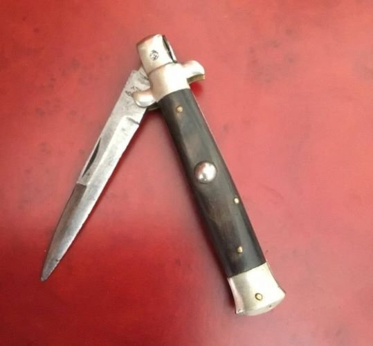

ROMO made a lot of odd manual stilettos, including false-button stilettos and non-locking stilettos. These were made using unfinished switchblade parts after the 1958 switchblade importation ban went into effect here in the US. The importation of manual stilettos was still legal though
I wouldn't be surprised if CTAYLORMAN's knife started out as a false-button like the ROMO manual pick-lock pictured below.

That might account for the weird blue “patch.” Filling in the false button hole?Killgar wrote: ↑Tue Dec 03, 2024 3:48 am ROMO made a lot of odd manual stilettos, including false-button stilettos and non-locking stilettos. These were made using unfinished switchblade parts after the 1958 switchblade importation ban went into effect here in the US. The importation of manual stilettos was still legal though

That was my guess. Looks like an amateur attempt at a turquois inlay.Good Old Luke wrote: ↑Tue Dec 03, 2024 4:04 amThat might account for the weird blue “patch.” Filling in the false button hole?Killgar wrote: ↑Tue Dec 03, 2024 3:48 am ROMO made a lot of odd manual stilettos, including false-button stilettos and non-locking stilettos. These were made using unfinished switchblade parts after the 1958 switchblade importation ban went into effect here in the US. The importation of manual stilettos was still legal though

I had a similar thought. Looks like some kind of auto putty.Killgar wrote: ↑Tue Dec 03, 2024 7:00 amThat was my guess. Looks like an amateur attempt at a turquois inlay.Good Old Luke wrote: ↑Tue Dec 03, 2024 4:04 amThat might account for the weird blue “patch.” Filling in the false button hole?Killgar wrote: ↑Tue Dec 03, 2024 3:48 am ROMO made a lot of odd manual stilettos, including false-button stilettos and non-locking stilettos. These were made using unfinished switchblade parts after the 1958 switchblade importation ban went into effect here in the US. The importation of manual stilettos was still legal though
