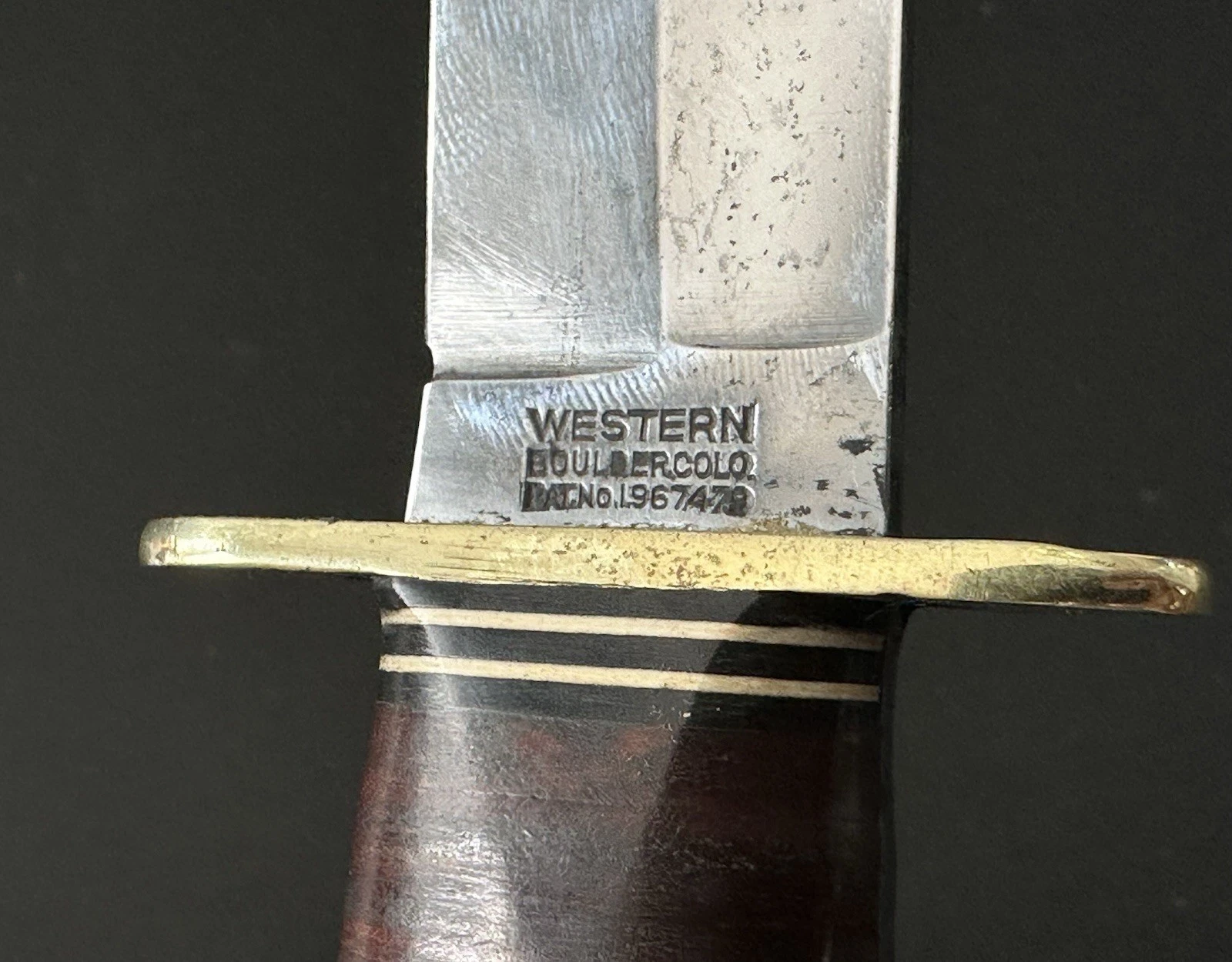

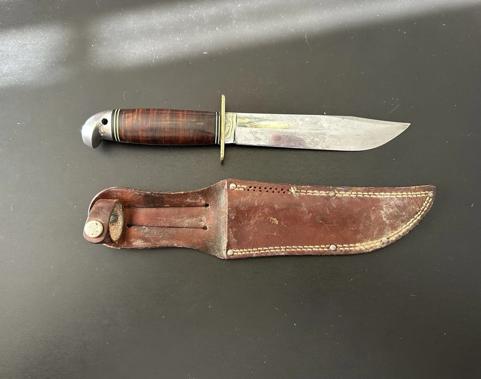

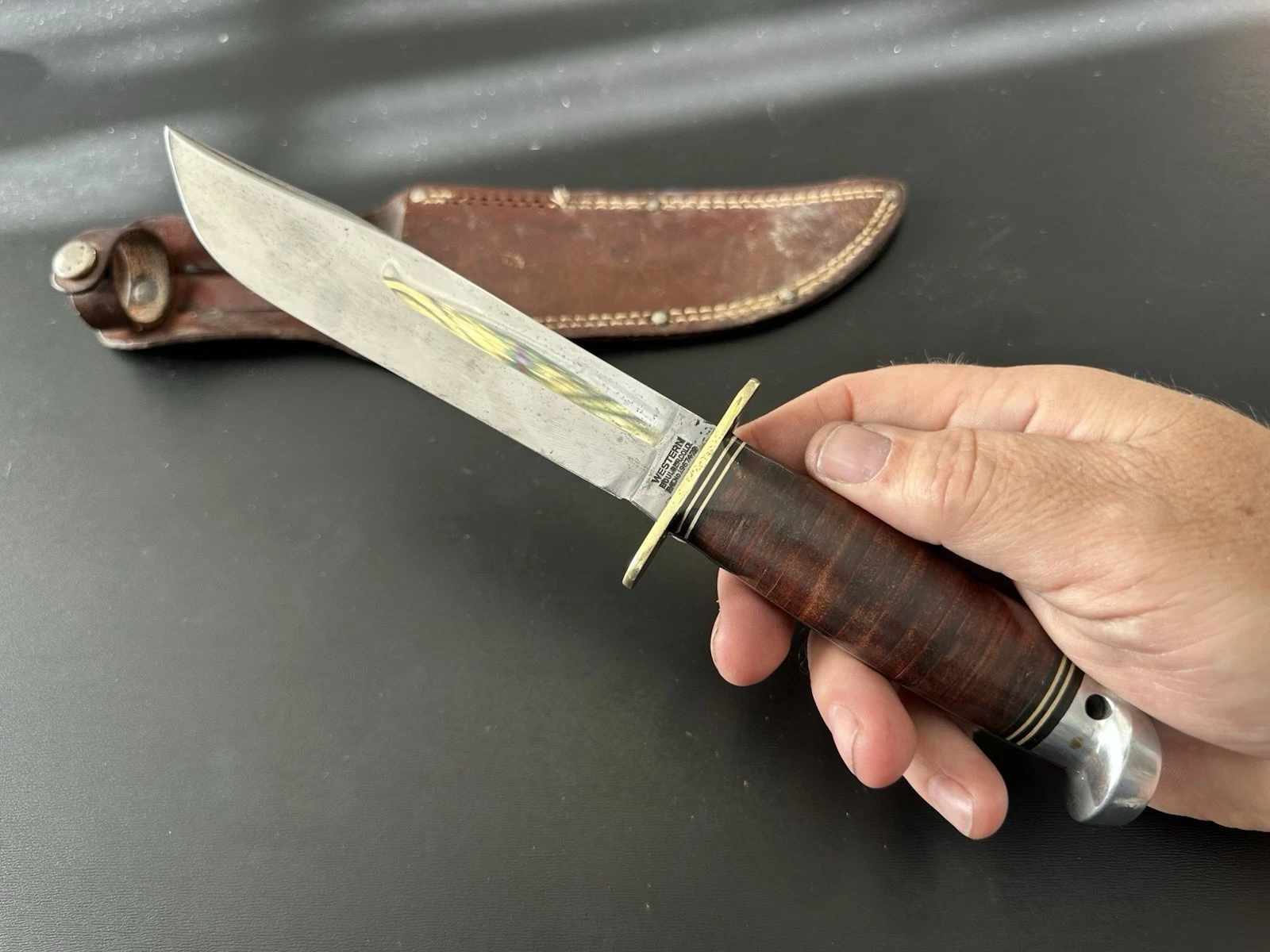

Hello gents, I have recently managed to purchase Western G46-6 Shark Knife in pretty decent shape as per photos attached.
As a matter of fact I still did not get my hands on it as it is currently traveling by postal services to me.
Ive been trying to find more information and learn more about the history of this blade, in which year it might have been produced and came across this thread and post made by zzyzzogeton on the pre,during and after WWII production of these knives.
I guess based on the stamp on the blade and cofiguration that this might be pre-war or during war production but I would like to kindly ask more educated gents around here that know the Western production better for your opinion please on what period or year it might have been produced.
Thank you!
https://i.postimg.cc/XJkVYvsK/Western-S ... fe-01.webp
https://i.postimg.cc/G2xcmpXN/Western-S ... fe-02.webp
https://i.postimg.cc/mDybgrdx/Western-S ... fe-03.webp
zzyzzogeton
Posts: 1839
Joined: Tue Jun 20, 2017 8:47 pm
Location: In the Heart of Texas on the Blackland Prairie
Re: Western G46 and L46 Series Knife Questions
Post by zzyzzogeton »
On MY monitor, the guard appears to have a yellowish sheen implying a brass guard.
IF the guard is brass, and not steel with weird lighting, a brass guard screams post war.
The blade is a WW2 contract blade but production time frame is dependent on the guard material.
IF the guard is brass then the knife is a post-WW2 production using a war contract canceled blade.
The lack of a U.S.A. reference indicates wartime / contract surplus blade.
Again, at first glance, on MY monitor the guard jumped out at me as being brass but then I started second-guessing what the guard material is, so that's why you get the wishy-washy answer.
Miro
Posts: 2
Joined: Mon Mar 25, 2024 10:48 am
Post by Miro »
Hi zzyzzogeton, thank you very much for your reply, I appreciate your broad insight into Western blade history.
Based on the pictures I would say with confidence that the guard is brass. Moreover the two pins through the pommel have yellowish tent which also suggest brass material of the pins only, the pommel itself is aluminium.
I wasnt sure about the brass guard because you have mentioned in relation to the pre-war G46-6 blades that "MAYBE some early ones had brass guards, but it is highly unlikely as brass guards were NOT part of any government contract specifications."
If the brass guards were predominantly introduced on G46-6 knives after the war end then as you correctly pointed out this would be war contract canceled blade.
What would be your educated guess on production year of this knife please? Could it be somewhere around 1946-1947 perhaps?
Personally I dont mind brass guard on this blade as all of my other Western blades also have brass guards so it will stay in the Western handle theme.
Thank you very much!
zzyzzogeton
Posts: 1839
Late 1945 to early/mid 1946. Or later. Depends on how many left over blades they had when the contract was canceled and how fast they made the new knives and how fast they sold.
